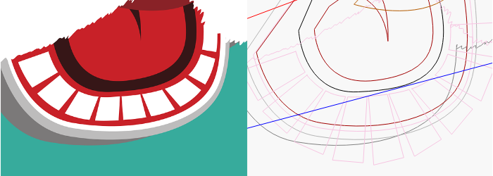

When importing vector artwork into LightBurn, sometimes files open with a large number of extra lines and shapes that aren't visible in the output from other graphics editing software, as shown in the example below.
This happens when artwork is created by stacking shapes on top of each other and/or using masks to hide parts of shapes. This method works fine for digital artwork, but leads to extra shapes like those shown above when loaded into LightBurn, which is designed to work with all the paths in your file.

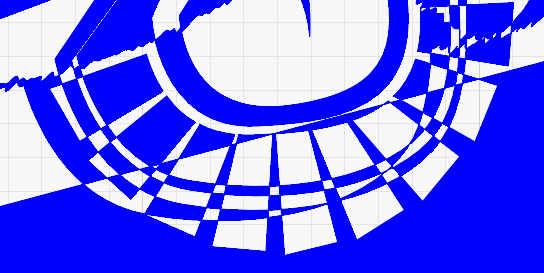

When you move objects onto the same layer, you may find that graphics set to Fill Mode don't appear filled, or you may end up with results like below, where shapes flip back and forth between filled and unfilled. In both cases, the likely culprit is duplicated or overlapping shapes.
  • Duplicated shapes negate each other and can cause closed shapes set to Fill Mode to appear unfilled and fail to engrave, or to cut/engrave multiple times in Line Mode. Use Delete Duplicates to eliminate shapes that are perfectly identical in size, shape, and position.
    Filled vs. Wireframe View Style
    Graphics set to Fill Mode are only rendered as solid objects in your Workspace when you are using a Filled View Style mode. You can change your View Style in the Window Menu, or by pressing Alt/Option+Shift+W.
    See View Style for more information.
  • The sample image above shows overlapping shapes on the same layer that aren't exact duplicates. The checkerboard effect comes from the shapes negating each other where they intersect. See Fill Mode and How to Invert a Vector Engraving for more information on these concepts.
