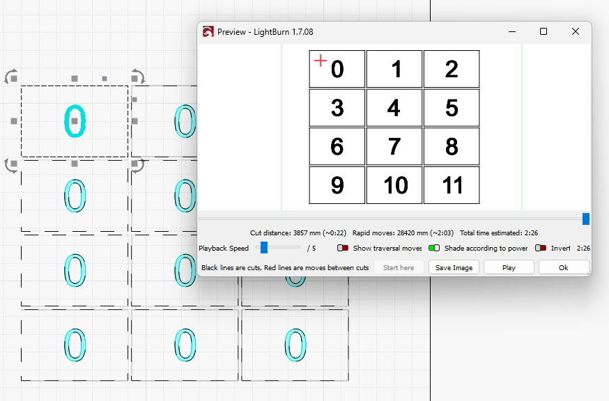

Using Variable Text in Virtual Arrays
When using Variable Text in a Virtual Array, using the Test button will not show the final output of the Variable Text in LightBurn's workspace. To see an accurate preview, you'll need to use the Preview window.

Some LightBurn tools can apply automatically advancing Offset values to duplicated objects.
Use Grid Array, Circular Array, or Copy Along Path to lay out copies of designs while increasing the Offset of each copy by a specified amount.
  • Grid Array Auto-increment Offset demo
  • Grid Array Auto-increment Offset demo Preview
