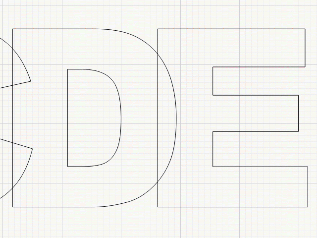

After activating the Trim Shapes tool, hover over any vector object in your Workspace to see a preview of the effect Trim Shapes will have on that object.
  • When you hover over a valid line segment, the cursor will change to the scissor icon, and the segment to be deleted will turn red.
  • Click to delete the segment.
Trim Shapes demonstration
