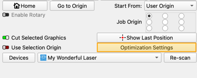

LightBurn's Cut Planner controls the order in which your laser cuts or engraves graphics in your project. The Cut Optimization Settings window is where you adjust the variables by which the Cut Planner decides on cut order and pathing.
To open the Cut Optimization Settings window, click the Optimization Settings button in the Laser Window.
Optimization Settings only take effect when the Optimize Cut Path switch in the Laser Window is toggled on. If Optimize Cut Path is toggled off, graphics are output in the order in which they were first created.
Optimization Settings controls in the Laser Window
