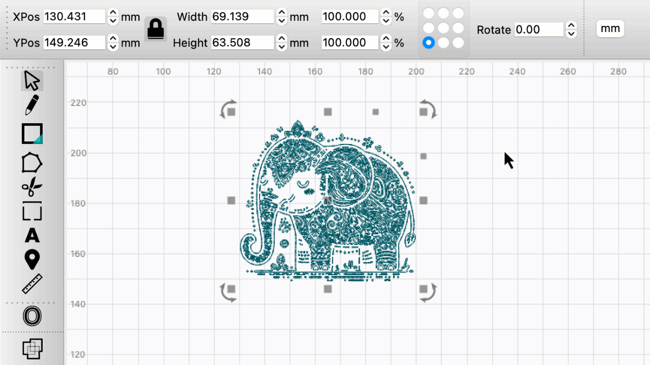

Numeric Edits Toolbar
Use the Numeric Edits Toolbar to adjust the size, position, and orientation of shapes in your selection using precise numeric values.
When adjusting objects through the Numeric Edits Toolbar, all objects in your current selection are treated as a single unit, maintaining their relative positions and scale as you make changes.
Accessing the Numeric Edits Toolbar
The Numeric Edits Toolbar is located in the top toolbar in LightBurn by default, to the left of the Text Options Toolbar.
If you have closed the Numeric Edits Toolbar, go to WindowNumeric Edits to re-enable it. To restore it and all other windows to their default positions, go to WindowReset to Default Layout
Numeric Edits Toolbar location
