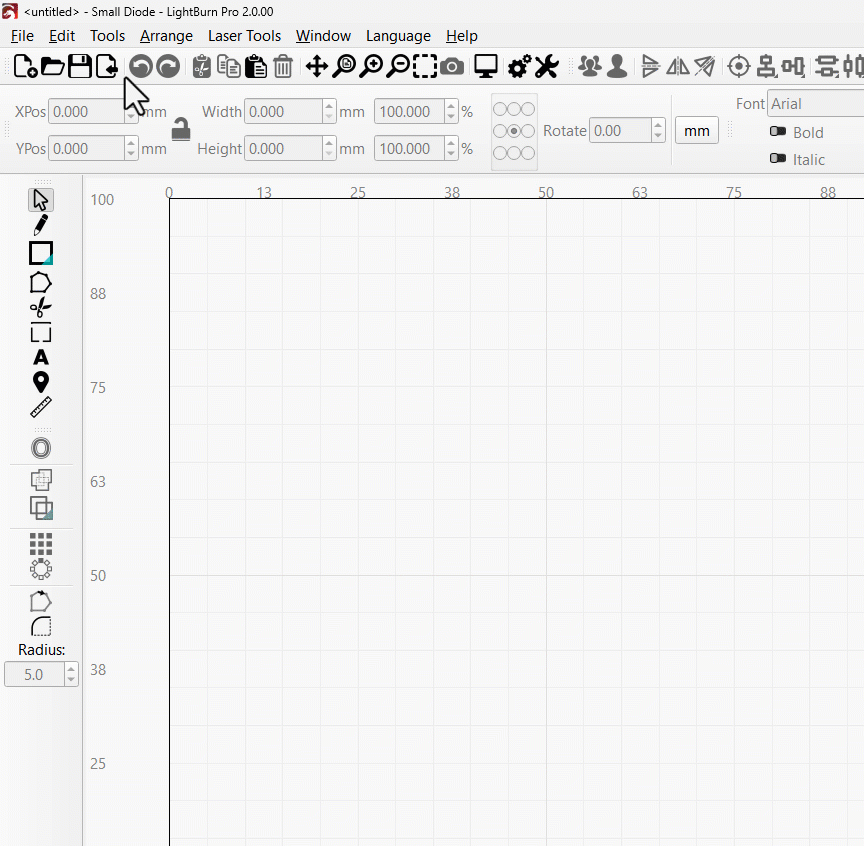

Using Multi-File Trace Image
  1. Go to ToolsMulti-File Trace Image (Labs) to open the file import dialog box.
  2. In the dialog box, navigate to the folder containing images you want to trace.
  3. Select all the images to be traced. Use Shift to select a range of files or Ctrl/Cmd to pick multiple files individually.
  4. Click Open to select and trace files.
  5. Go to the folder containing the source images to find your traced SVG files.
