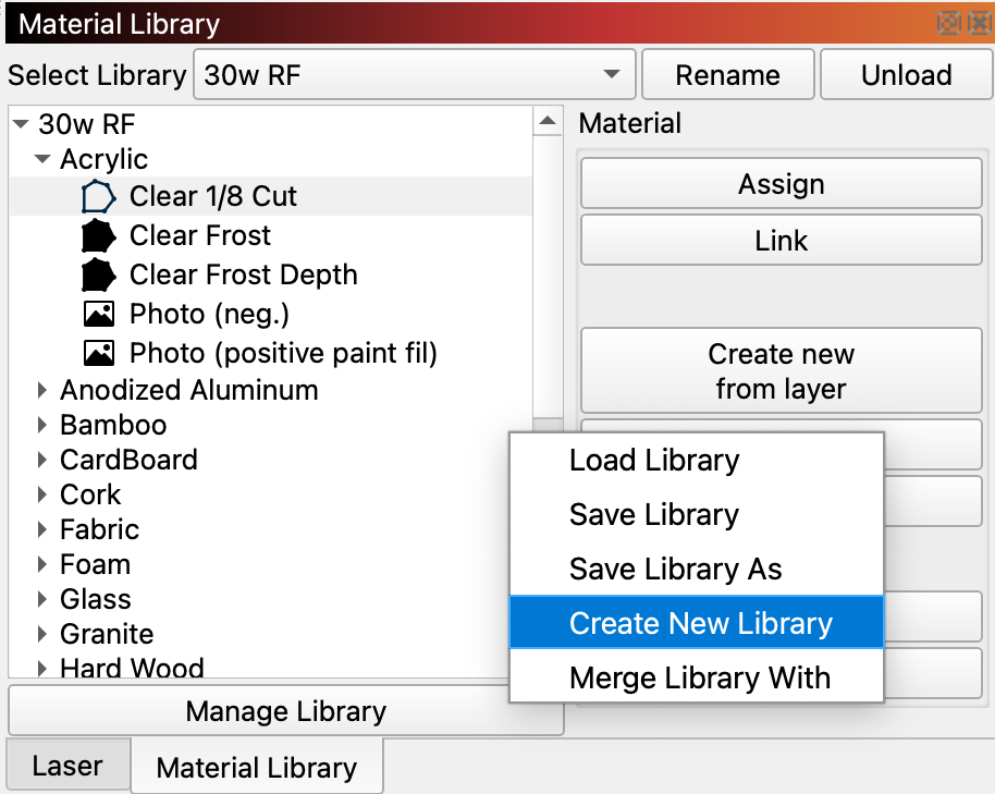

Click the Manage Library button to open a menu of options for opening, saving, or combining libraries.
Manage Library options in submenu
Load Library
Open your system's file browser, where you can navigate to the location of a previously saved .clb file and select it, to add it to the Select Library dropdown list.
Save Library
Stores or overwrites a previously a stored Library with an updated version containing any changes you've made since you last saved the Library. Libraries are saved with the .clb file extension.
Save Library As
Saves a copy of the active Library to your files with a different file name. Useful for archival purposes.
Create New Library
Creates a blank Library.
Merge Library With
Combines two Libraries together. Useful when importing settings from external parties.
Select Library
Select one of the Loaded Libraries from the dropdown list.
Rename
Changes the name of the Library.
Unload
Removes the Library from the Select Library list.
