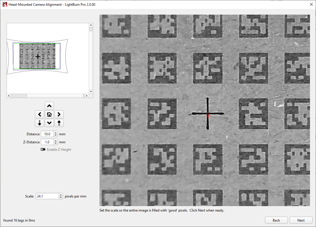

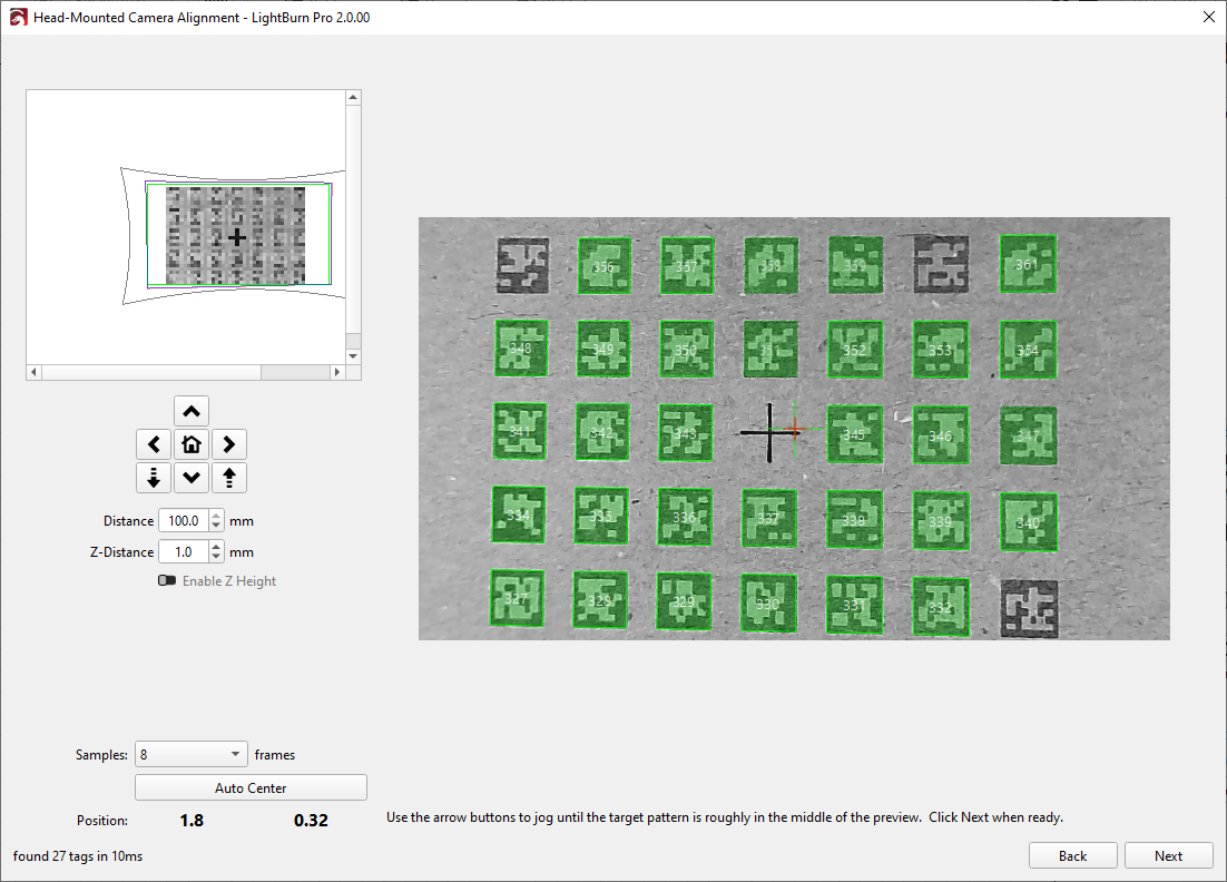

Centering the Laser Over the Pattern
  • Use the Jog arrows to move the laser head, and with it the camera, until the pattern is postioned roughly in the center of the camera's field of view.
  • The field in the center fo the arrows controls the amount of distance the laser will move with each click.

Tagging the Pattern
Next you'll mark four locations near the center of the pattern, and finally four more around the outside of the grid.
When you double-click, a red "+" mark will appear. If you place one incorrectly, you can double-click near it to shift it around.
  1. Double-click the center of the grid to place a red "+" mark there. When the marker is accurately placed, click Next.
