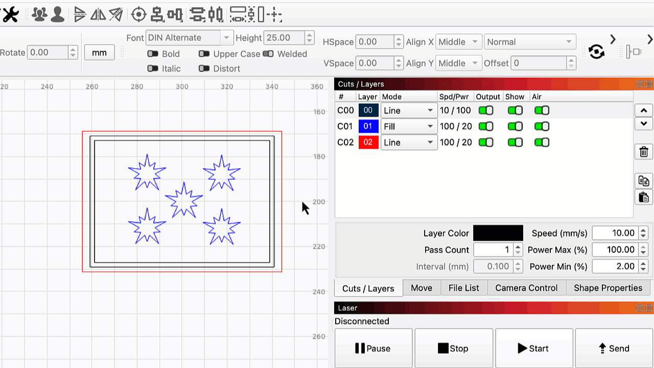

The Cuts / Layers Window shows the list of layers in your project. From the Cuts / Layers Window, you can assign different operations to specific layers, control the order the laser processes the layers, adjust an abbreviated set of settings for each layer, and more.
To adjust all layer settings, double-click any layer in the Cuts / Layers Window to open the Cuts Settings Editor, which contains all available settings.
Use the Color Palette to change the layer selected objects are assigned to.
About Layers in LightBurn
In LightBurn, different colors indicate each layer. These colors don't represent the final product's colors but instead differentiate each operation needed to complete the job. Each layer defines a process and a collection of settings that are assigned to objects within the project.
In other words, layers let you tell the machine what it needs to do to produce the final work.
Generally each color refers to a different layer, with one exception — if you add an image to a vector layer (or vice versa), then the layers will split to show two entries in the Cuts / Layers Window.

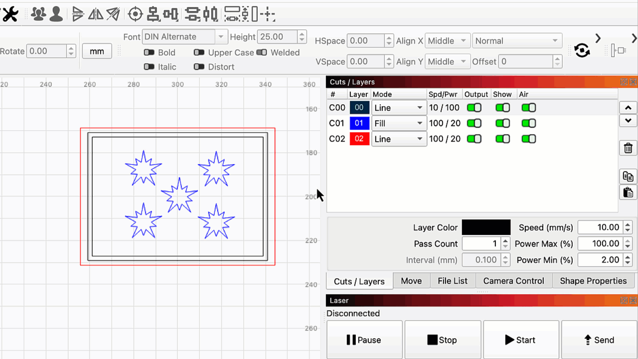

Cuts / Layers Window Options and Settings
The type of laser you have active will affect which settings are presented in the Cuts / Layers Window. The image below shows the Cuts / Layers Window for a DSP laser, but not all options shown here are available for all lasers, and some lasers have additional options that are not shown, but are listed below.
Click any option in the image below to jump directly to the relevant section for that option, or scroll down for a list of options and descriptions.
Columns
# (Layer Name)
Shows the layer name. You can adjust a layer's name in the Cuts Settings Editor.
Layer
Shows the color and title of the layer. Colors and titles have matching entries in the Color Palette.
Mode
View and change the Layer Mode of layers in your project.
  • You can adjust the mode of vector graphics between Line, Fill, and Offset Fill.
  • Layers containing images are automatically set to Image and cannot be adjusted.
  • Layers with multiple Sub-Layers are set to Multi. Open the Cut Settings Editor to adjust Sub-Layer modes and other settings.
Mode dropdown in the Cuts/Layers Window
Spd/Pwr
Shows Speed and Power settings.
You can adjust these settings in Speed and Power Max fields beneath the list of layers, or by opening the Cut Settings Editor.
Output
Tip
Use Preview to verify that only intended layers are set to output.
Toggle to enable or disable which layers are output when you Preview, Start, Send, or save a project in machine-specific format.
The color of layers not set to output will be faded in your Workspace.
Output switch demo
Show
Toggle which layers are visible in your Workspace.
show switch demo
Air
Note
Available for Gantry lasers only.
Toggle to enable or disable Air Assist for individual layers in your project.
Air assists blow air onto the surface of your material at the spot where the laser's beam strikes, which can help prevent soot accumulation and charring, and aid in cutting.
Note
Many lasers do not come with air assists, and others have manual air assists that you can't trigger through software. In those cases, toggling the Air switch will have no effect either way.
Consult your laser's manufacturer if you're not sure if your laser has a built-in air assist.

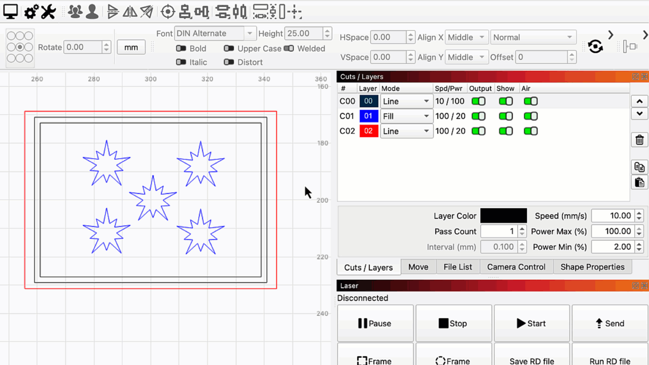

Rearrange Layers
By default, layer operations are performed by your laser in the order from top to bottom in which they are listed in the Cuts / Layers Window.
Note
See Optimization Settings for information on alternate options for ordering operations.
The order that layers are completed is often important, as pieces shift after being cut out. It's therefore best to engrave images and marking/scoring lines before any cuts through the material.
To change the order of the selected layer in the list you can click and drag to change its position or select a layer and click the up and down buttons in the window.
Rearranging layers

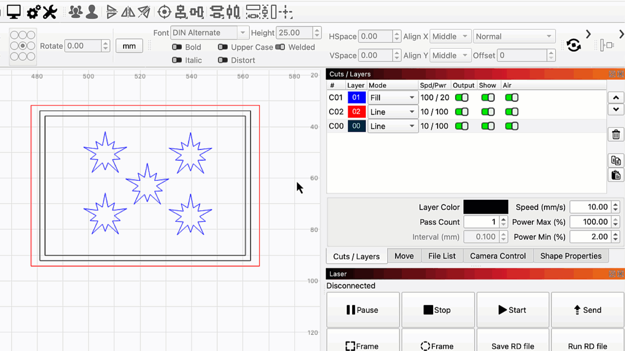

Sort Cuts Last
You can also automatically sort all layers, based on how likely they are to cut through the material — with the least likely being performed first.
To do so, right click any heading on the table (e.g. Mode) and choose Sort Cuts Last.
This process orders layers first by their strength — stronger layers have higher Power, lower Speed, and more Passes. It then pushes all Line Mode layers to the end, so all engraving operations are performed before cutting operations.

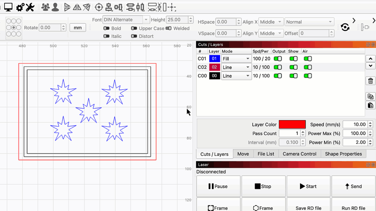

Copy Layer Settings
To copy settings between layers, first select a layer in the list and click Copy button to copy its settings. Next, select the layer you want to copy to, and click the Paste button.
Copying Layer Settings
