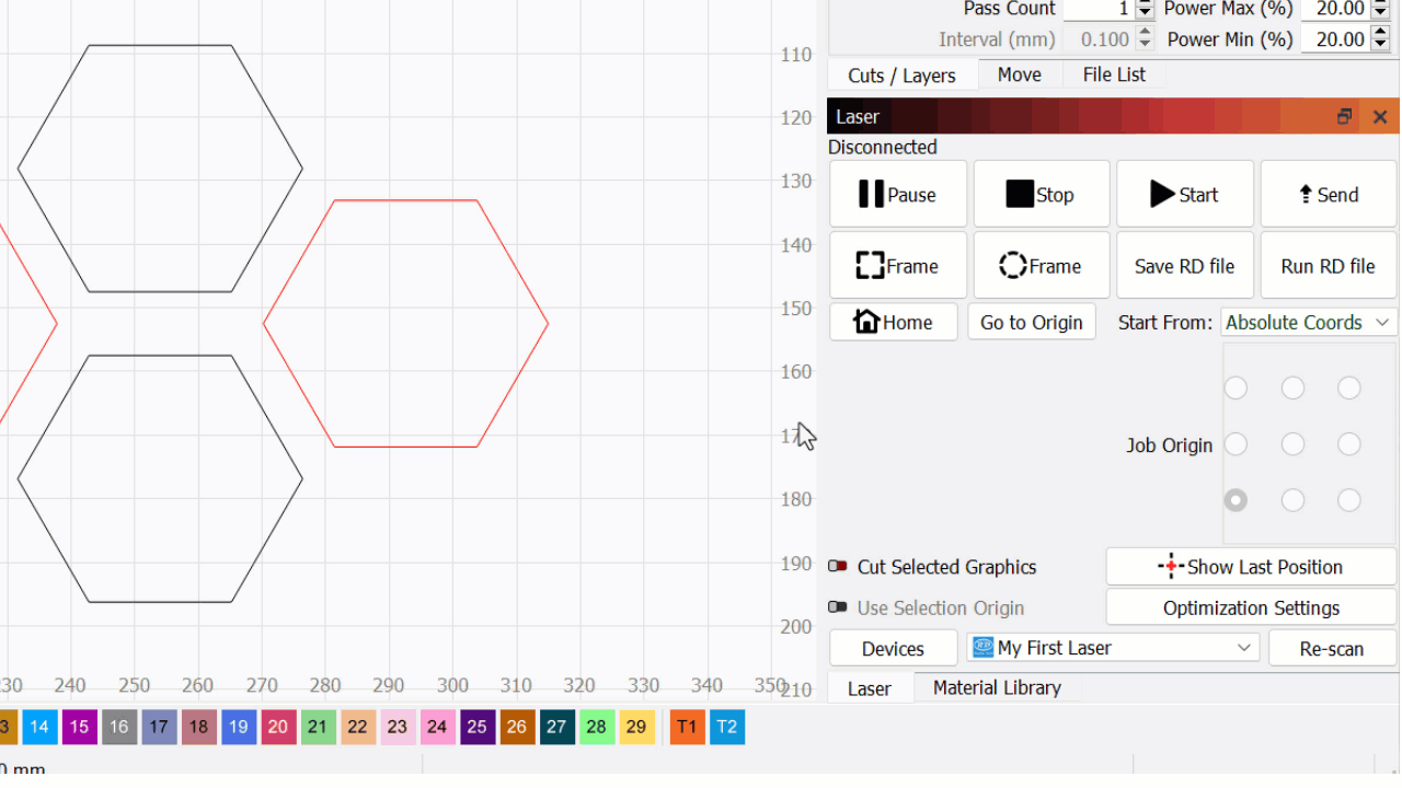

The 9-dot Job Origin selector beneath the dropdown menu determines the orientation of output relative to the Current Position or User Origin. It will be grayed out if you have Absolute Coords selected, but clickable if you choose Current Position or User Origin.

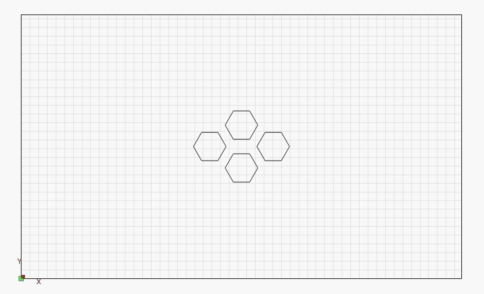

Absolute Coordinates¶
Absolute Coordinates is the most intuitive option. The grid in your LightBurn Workspace has a coordinate system that matches the physical work area of your laser. The 0,0 position is always the location of your laser's Machine Origin.
With Absolute Coords selected as your Start From mode, anything you place in the LightBurn grid will be output in the corresponding location in your machine's work area.
Note
Using absolute positioning requires a laser with a fixed origin. If you have a small diode laser that does not have homing switches, you will need to manually home the machine. See: Machines without homing sensors / limit switches.
In the image below, the four hexagons placed in the middle of the LightBurn grid will be cut in the middle of the machine work area. The green square in the lower left of the image represents the Job Origin, and the red square in the same place shows the Machine Origin. When using Absolute Coords, these are always in identical locations.

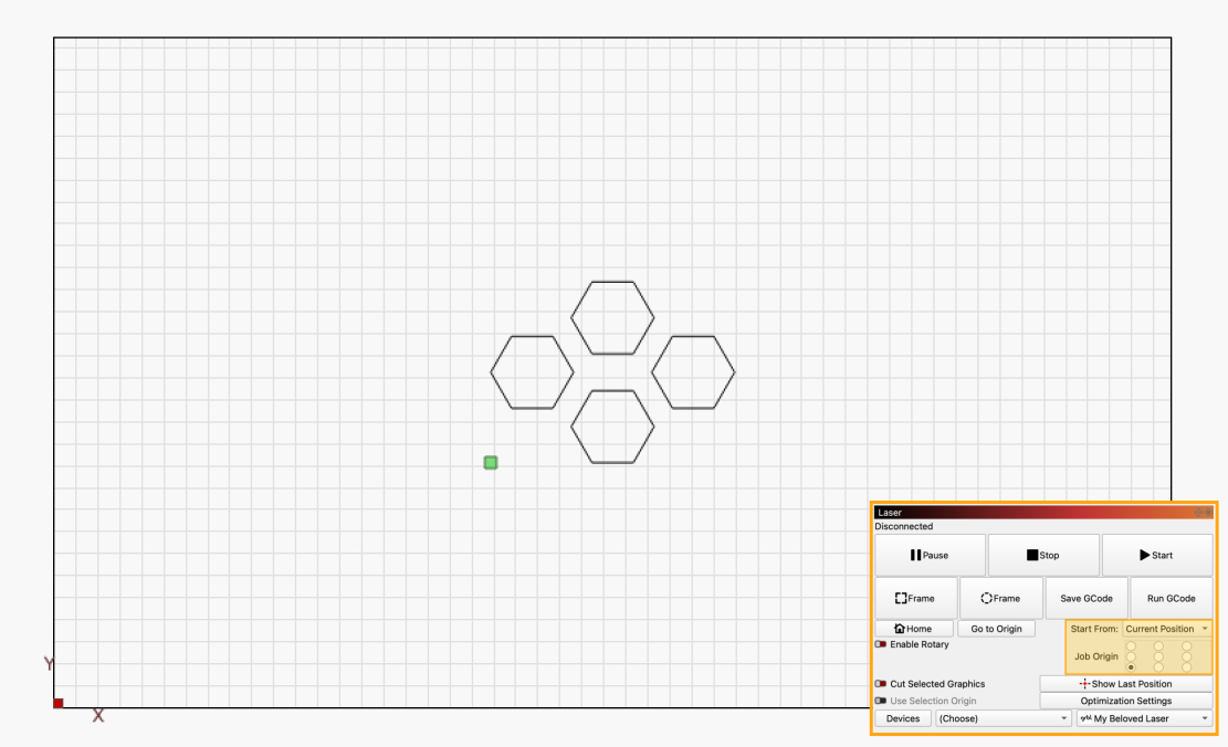

Current Position¶
With Current Position selected, your job outputs relative to wherever the laser head is located when you press the Start button. The Job Origin control in the Laser Window tells LightBurn how to orient output relative to the laser head.
In this image, we're starting from the Current Position, with the Job Origin set to the lower left:
Notice that the green Job Origin indicator has moved. This represents the position of the laser when you start the job, so the laser is going to move slightly up and to the right from wherever it is, cut the four hexagons, and go back to where it started.
Why is the Job Origin offset from the graphics?
When using Current Position or User Origin, the green Job Origin indicator is always located on a corner, side, or at the center of an imaginary box — the smallest possible rectangle that can fully contain all graphics you're sending to the laser.
Below, we've added a Tool Layer to represent that imaginary box. Notice how the Job Origin moves around the box as we change the location in the 9-Dot selector.
Now imagine that you want to etch this four hexagon pattern onto a coaster or a phone case. Lining it up from the lower left is not easy. If you change the Job Origin setting to center, you get this instead:
The job will be centered around the current position of the laser head. If you position the laser head directly over the center of the item you want to etch, the output will be centered on the item.

Both Current Position and User Origin require you to jog your laser into a desired position to define a custom origin. LightBurn has a few tools for adjusting the location of your laser's head within its work area — the most straightforward option for beginners is to use the arrow keys in the Move Window. By default, the Move Window is hidden behind the Cuts / Layers Window — click the Move tab to expose it.
The arrow keys move your laser up, down, right, or left. You can set the amount the laser travels with each click in the Distance field, and the rate at which it travels in the Speed field.
