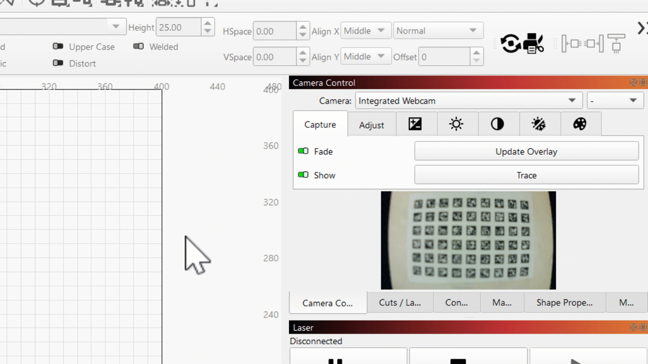

  • Make sure the correct camera is selected in the Camera Control Window.
  • Right-click in the same window and select Calibrate Camera Lens with Tag Tracking (Labs).
Opening experimental lens calibration wizard

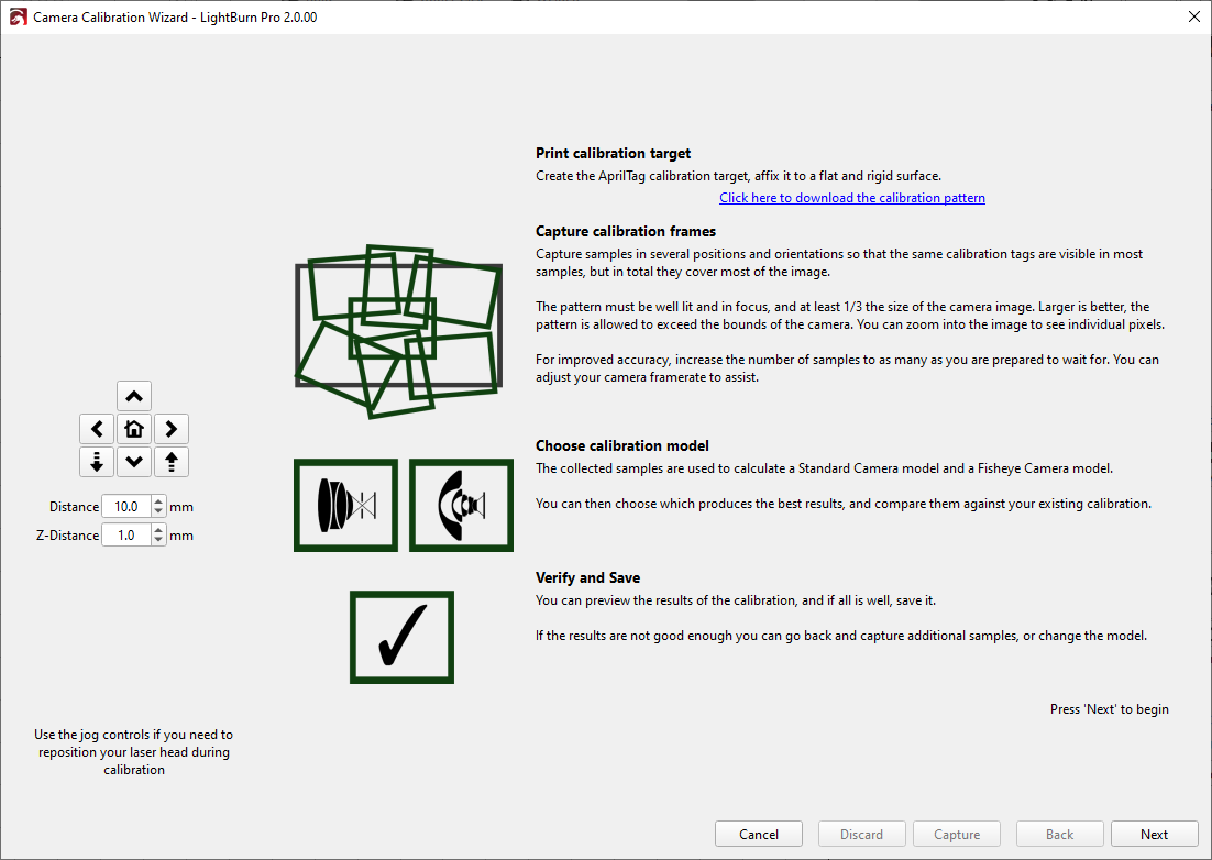

The Camera Calibration Wizard walks you through capturing multiple images of the Calibration Pattern you've printed out. The software analyzes how the pattern appears in the images, and compares that against its internal knowledge of how the pattern should look. It determines the amount and shape of distortion produced by the lens of the camera, and computes a lens correction that is accurate for your camera.
After following the steps from the overview above, you're read to begin the calibration process.
To open the wizard:
  1. Make sure the correct camera is selected in the Camera Control Window.
  2. Right-click in the same window and select Calibrate Camera Lens with Tag Tracking (Labs).
lens calibration window
AprilTags
You'll see a link to download the AprilTags calibration pattern, as well as instructions on completing the calibration process.
You can use the arrow buttons to the left side of the window to jog your laser out of the way, if its current position will obstruct your ability to place and capture the calibration pattern in your laser's work area.
The Sample field lets you control the number of frames per second used during the capture process.
After reading the instructions, and adjusting the sample rate or jogging your laser if necessary, click Next to proceed.

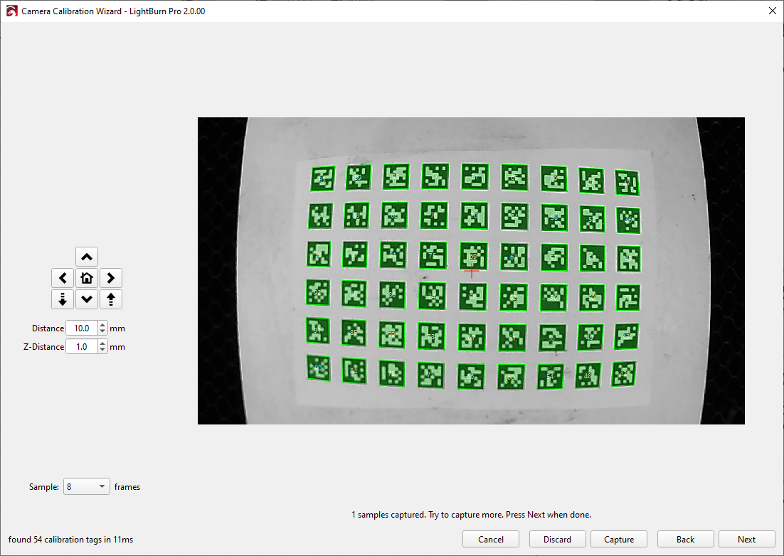

The view will change to include a live image from your camera, along with several new buttons.
The wizard will overlay green squares on top of each AprilTag it identified in the calibration pattern. Position the pattern so that the camera sees and identifies as many tags as possible.
If the wizard can't identify very many or any tags, you may need to adjust your camera's focus.
Click the Capture button and you should see something like this:
Lens Calibration capture 1 complete

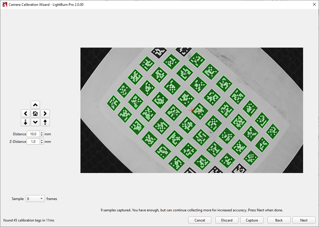

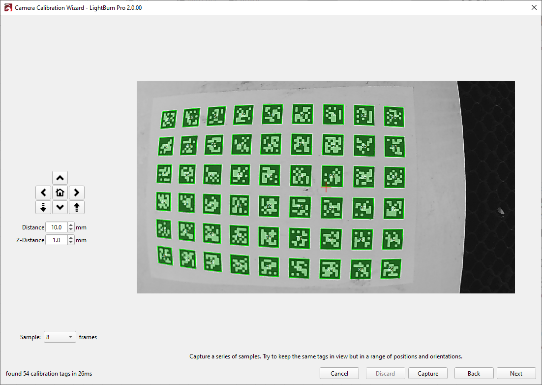

Move and rotate the calibration pattern around the camera's field of view, clicking the Capture button again for each new position.
You can click to Discard any capture you are disatisfied with, for example if you accidentally click twice, clicked before the samples settled and were identified, or moved the pattern or camera while clicking.
pattern rotated within view
After you've captured 9 samples, you have enough to proceed to the next step of the calibration process, but you can continue taking additional captures to increase accuracy.
Click Next when you're ready to proceed.

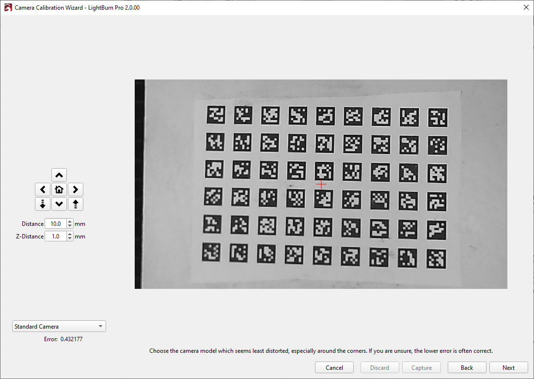

The calibration wizard will take a few moments to build two camera models: Standard Camera and Fisheye Camera.
Select each model from the dropdown menu in the lower left, and compare the results. The better model will show less distortion in the example capture. You can also select Original Calibration from the menu to view and compare to your current calibration.
Tip
Look for lines that you know to be straight in the real world — if they're wavy in the capture, that means there is distortion in the selected model.
If the captures from both models look comparable, or you're unsure which to choose, select the model that shows the lower Error reading, displayed beneath the dropdown menu.
Note
If both models appear distorted, click Back to capture additional samples, or discard the previous samples and begin the process over. Make sure the physical calibration pattern is undistorted, perfectly flat, and surrounded by a 6 mm (¼") or larger margin.
After you've selected the least-distorted model, click Next to advance to the final page of the Calibration Wizard.

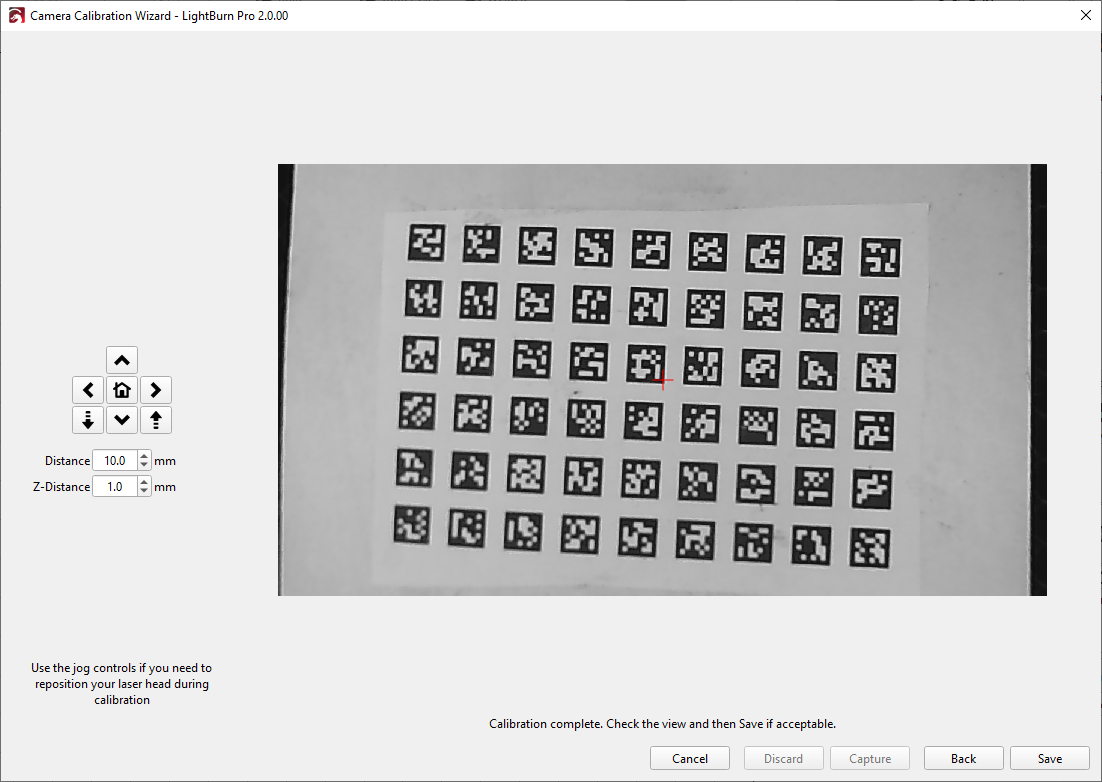

Camera Calibration Final Page
When you have advanced through all the steps, and you are satisfied that you have a good calibration result with a nicely undistorted image, click Save to store the results.
