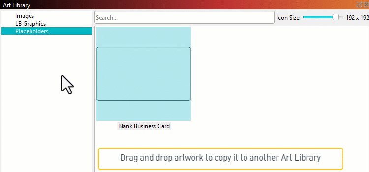

Using the Art Library
You'll see a list of Art Libraries on the left, and thumbnails of the artwork within the currently selected Library on the right.

Creating a Library
To create an empty Library, click the New button, then choose a location and name for the .lbart file — this is where added artwork will later be stored, in compact form.

Storing Art in a Library
Use the Import button to add artwork from saved files to your Library. You can import multiple files at once using this method, and each will become an individual entry in the current Library.
To add selected objects from your current project, click Import Graphic from Project, or right-click in the Art Library Window and choose Add Selection to Library.

Adding Art to a Project
Dragging a thumbnail from the Art Library into a project adds it to the project wherever the mouse is released.
Clicking the Add Graphic to Project button adds the selected artwork into the center of the current field-of-view in the Workspace.
