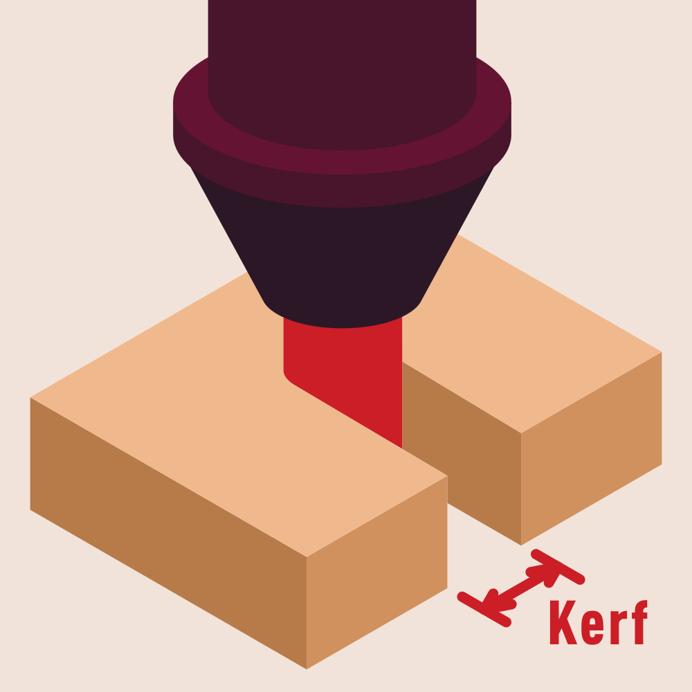

Kerf describes the material removed by a tool as it works. In woodworking it's the thickness of a saw, but in laser cutting it's the gap of material removed by the beam. The width of this gap — its Kerf — varies based on the material being cut, the thickness of that material, and the Settings used to cut, such as speed and power.

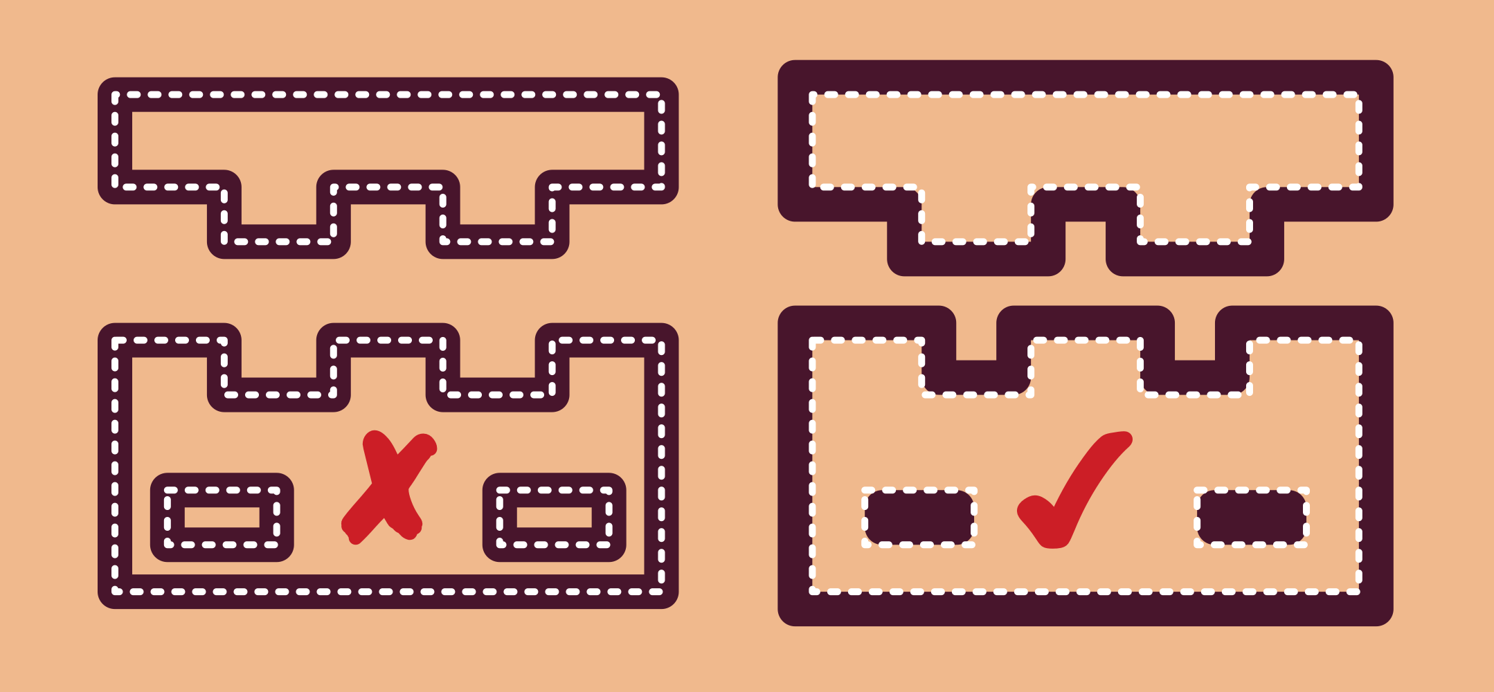

When Kerf is not taken into account, and a beam is run along the center of a path, it removes material from either side of that line, and so the resulting parts are undersized (or in the case of slots, oversized). However, if you offset the path to compensate for the Kerf, perfect dimensional-accuracy can be achieved.
Comparison of the outcome of a piece without a kerf offset and with one

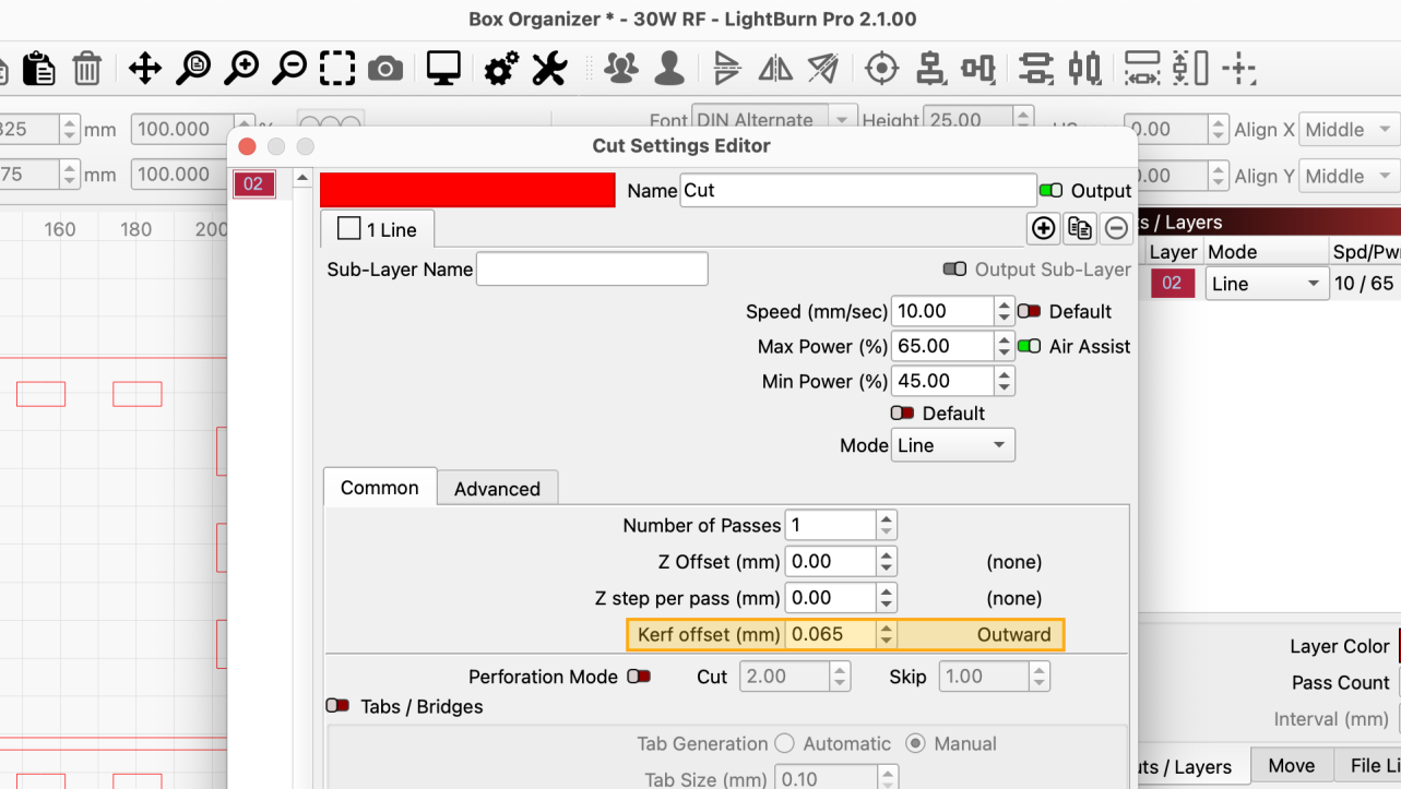

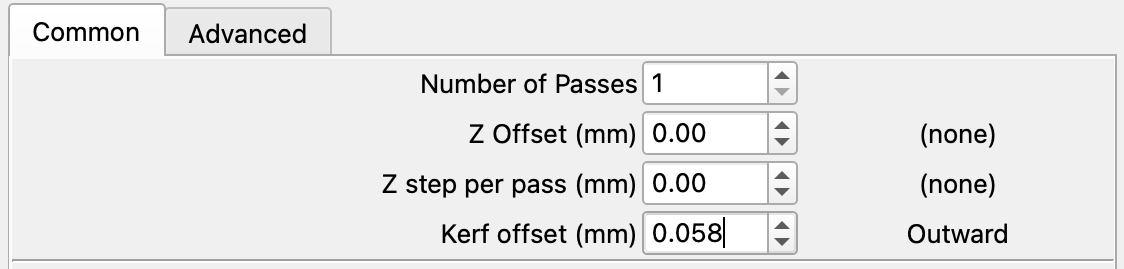

LightBurn makes it easy to apply the correct offset for a particular material through the Kerf Offset setting. You can find this option in the Cut Settings Editor, for layers set to Line Mode.
A correct Kerf Offset expands or shrinks the border so that the edge of the cut matches the edge of the art. Positive Kerf Offset values expand the border, and negative values shrink it — you'll see Inward or Outward appear next to the Kerf Offset field to let you know in which direction your value is adjusting the border.
The location of the Kerf Offset option in the Cut Settings Editor
The Kerf Offset will be applied to all closed shapes assigned to the layer. Shapes that lie within other shapes on the same layer will have the offset direction inverted, to ensure that holes become the correct size.

Kerf Offset is different to scaling a design, as scaling increases the size over the whole object, not just at the edges where the material is being lost to the Kerf. Scaling an object usually results in pieces that do not fit together, hence the need for an offset.

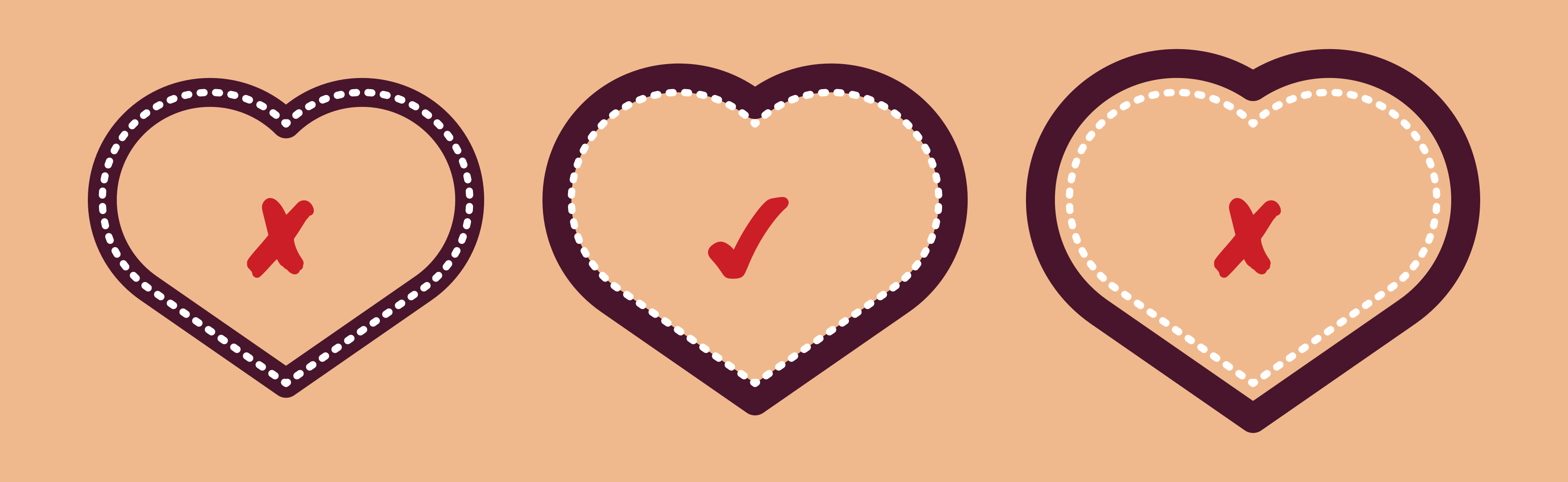

It's possible to overcompensate for Kerf by increasing the Kerf Offset value too far. This results in pieces that are too tight to fit together, so it's important to find the "sweet spot" for Kerf Offset. Diagram depicting negative kerf, no kerf, kerf perfectly compensated, over compensated

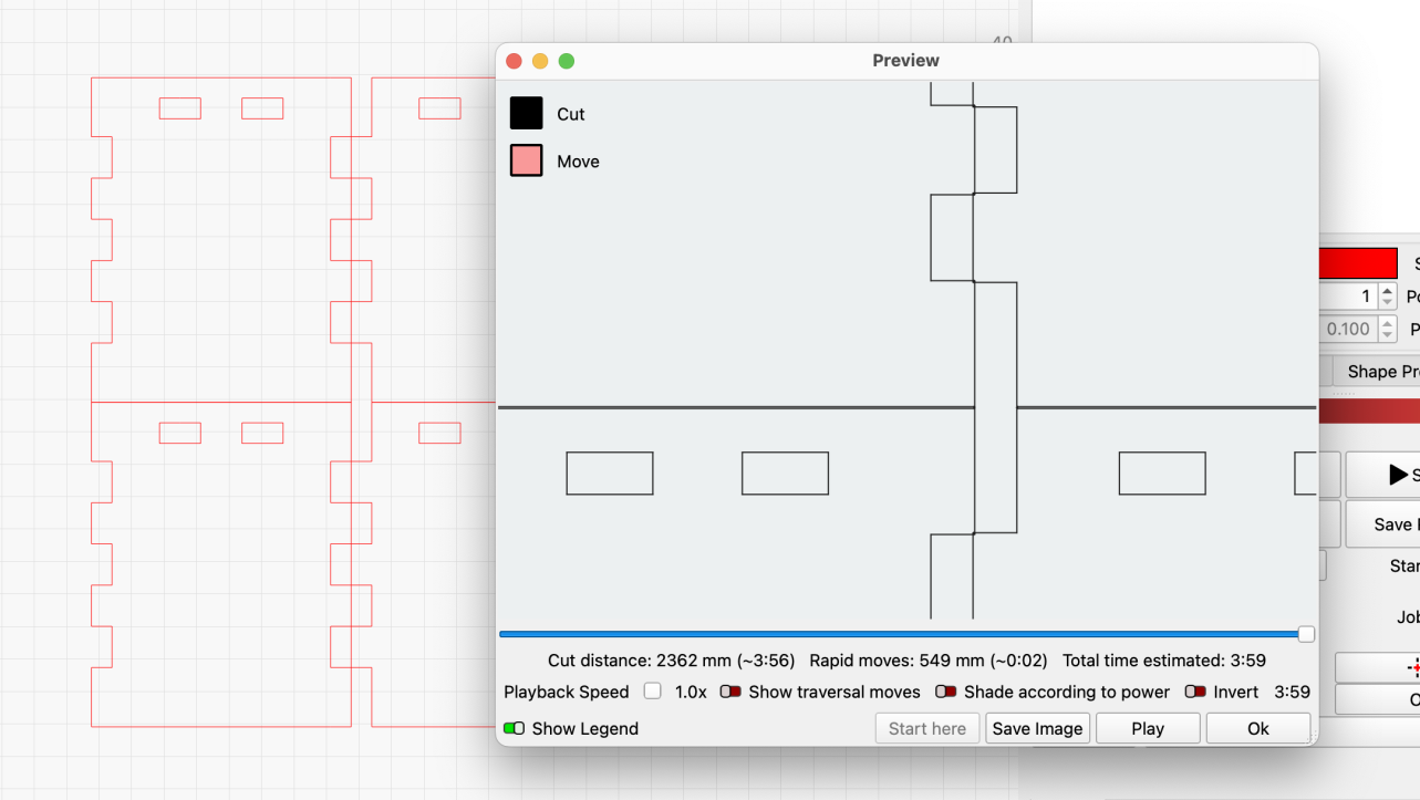

Because Kerf Offset takes more space, it's important to leave room between the parts.
Kerf Offsets are shown in the Preview window, so it's a good idea to check it before sending the job to the machine.
Shapes with Kerf Offset applied overlapping in the Preview window
These shapes are set too close together, and the cut lines will overlap once the Kerf Offset is applied.

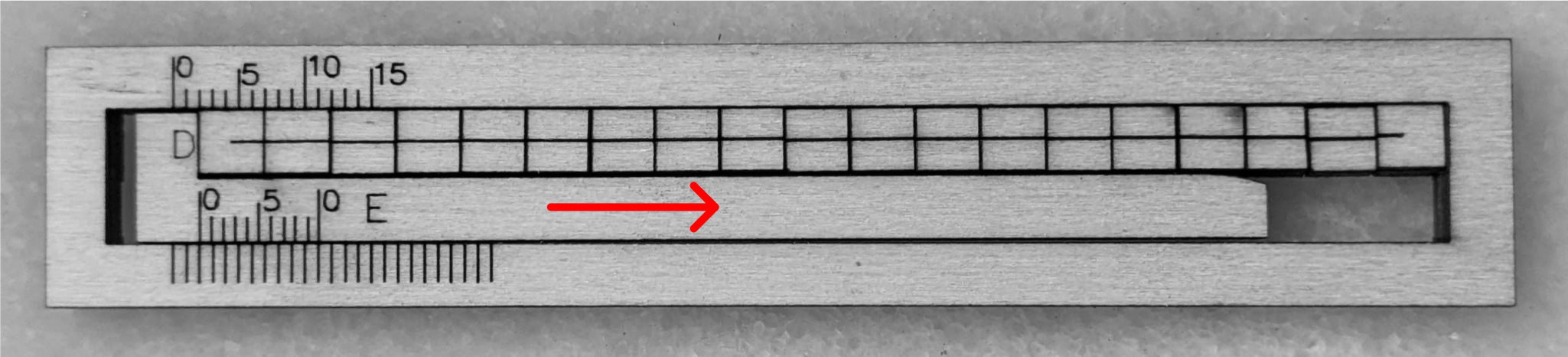

  1. Set up the Cut (red) and Score (black) layers with your usual settings, and ensure the Kerf Offset is set to 0 mm (off) in the Cut Settings Editor. Position and run the Vernier Kerf Offset Test on your machine as normal.
  2. Remove all pieces from the machine (a piece of painter’s tape can assist), and remove the piece marked DISCARD.
  3. Slide all loose bits to the right →. The horizontal black line can be used to orient the rectangular pieces if they get scattered. Annotaed image of the L-Shaped piece slding right

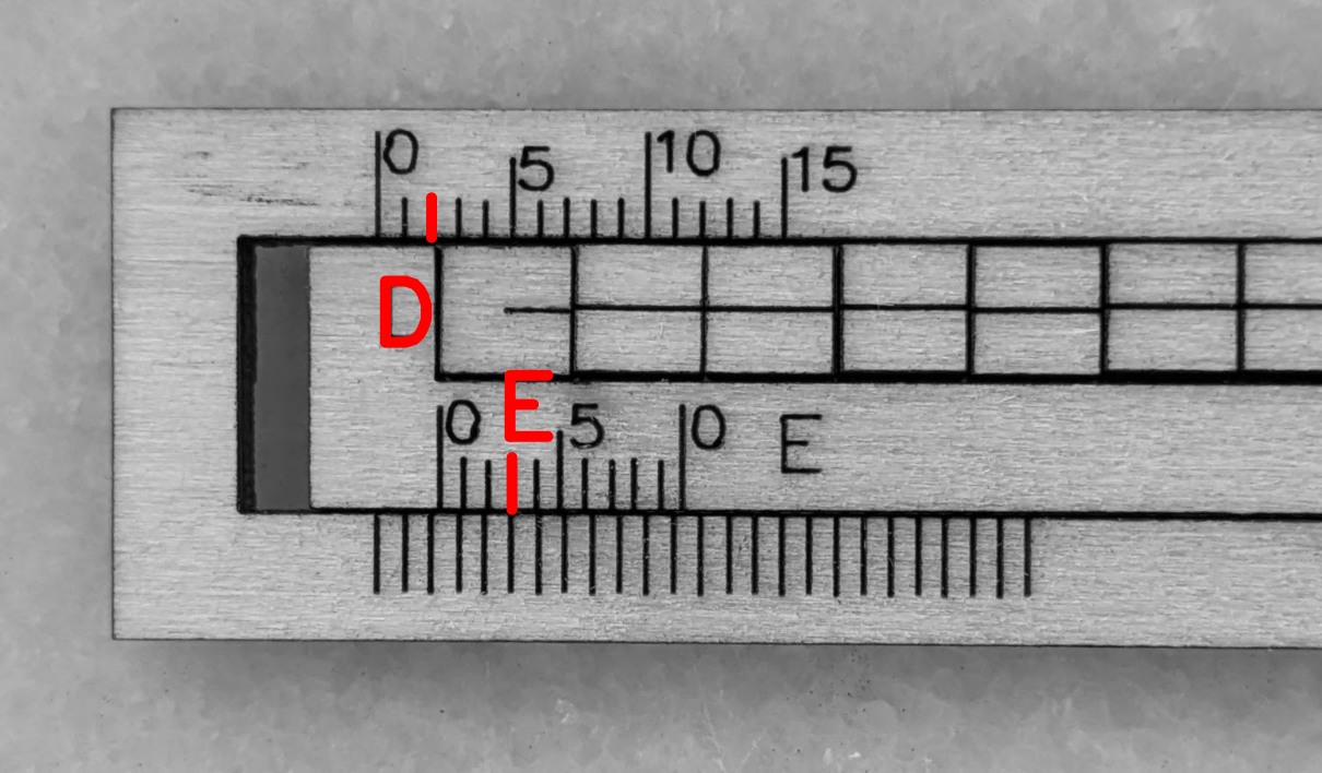

  4. Find the largest number that the line marked D passes on the top scale, and use it as the whole number (D) in our equation (2 in the example).
  5. Find which line on the bottom (Vernier) scale best lines up with any line on the bottom border (3 in our example). This will give us the decimal place (E) in our equation. Annotated image demonstrating how to find D and E
  6. Fill in the equation, calculate it, and use the result as your Kerf Offset in the Cut Settings Editor.
    D . E        2 . 3
    -----   =    -----   =  0.0575 mm
      40           40
    Entering the value into the Cuts and Layers Window

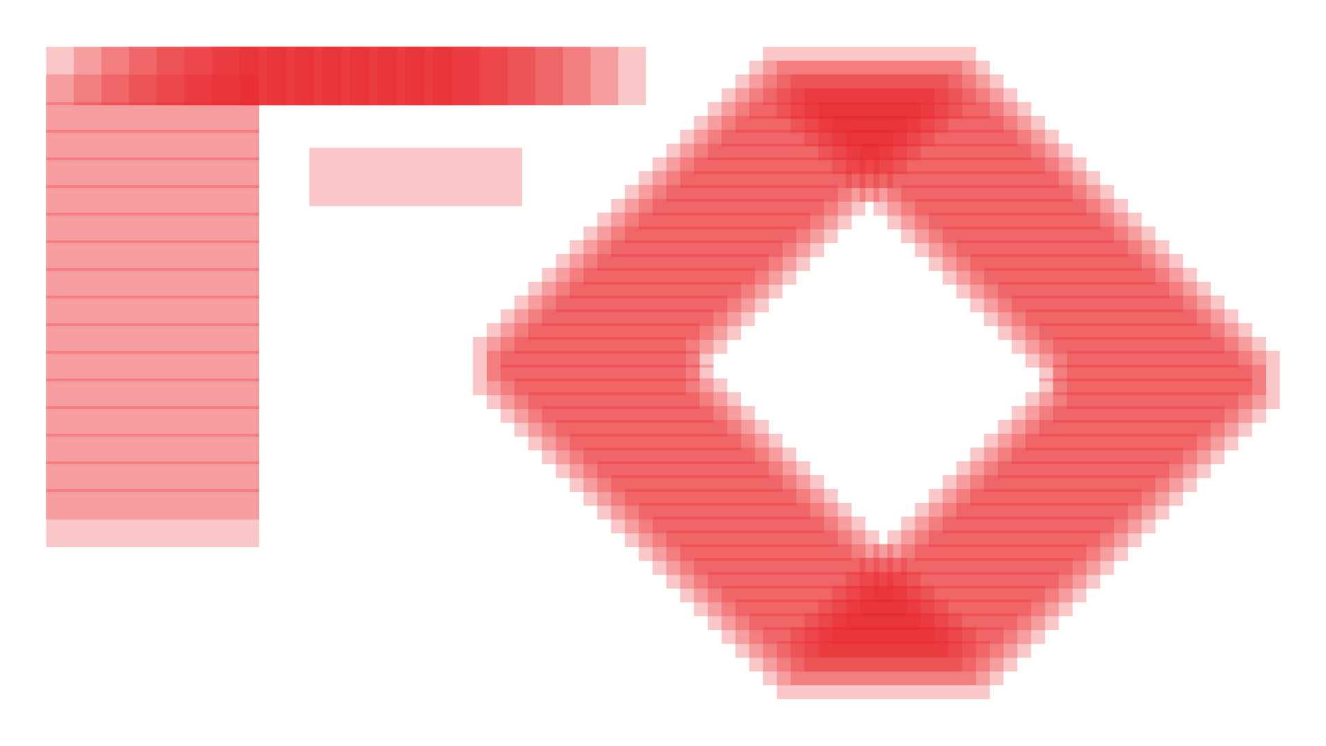

Dealing With Irregular Beam Shapes
Some laser sources have beams that are not circular. For example, some diodes have a rectangular-shaped dot that result in a different Kerf (and power) on the vertical and horizontal axes. There are a couple of ways to manage this:
  • Find the axis with the larger kerf and use that value, knowing some areas will be loose.
  • Find the Kerf with the test turned on a 45 degree angle, and then cut all parts on a 45 degree angle, which will give more consistent results but limit the size of objects cut.
Comparison of path angle on beam density
