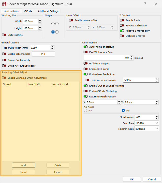

LightBurn has a setting to counter this, called Scanning Offset Adjustment, in the Basic Settings tab of Device Settings.

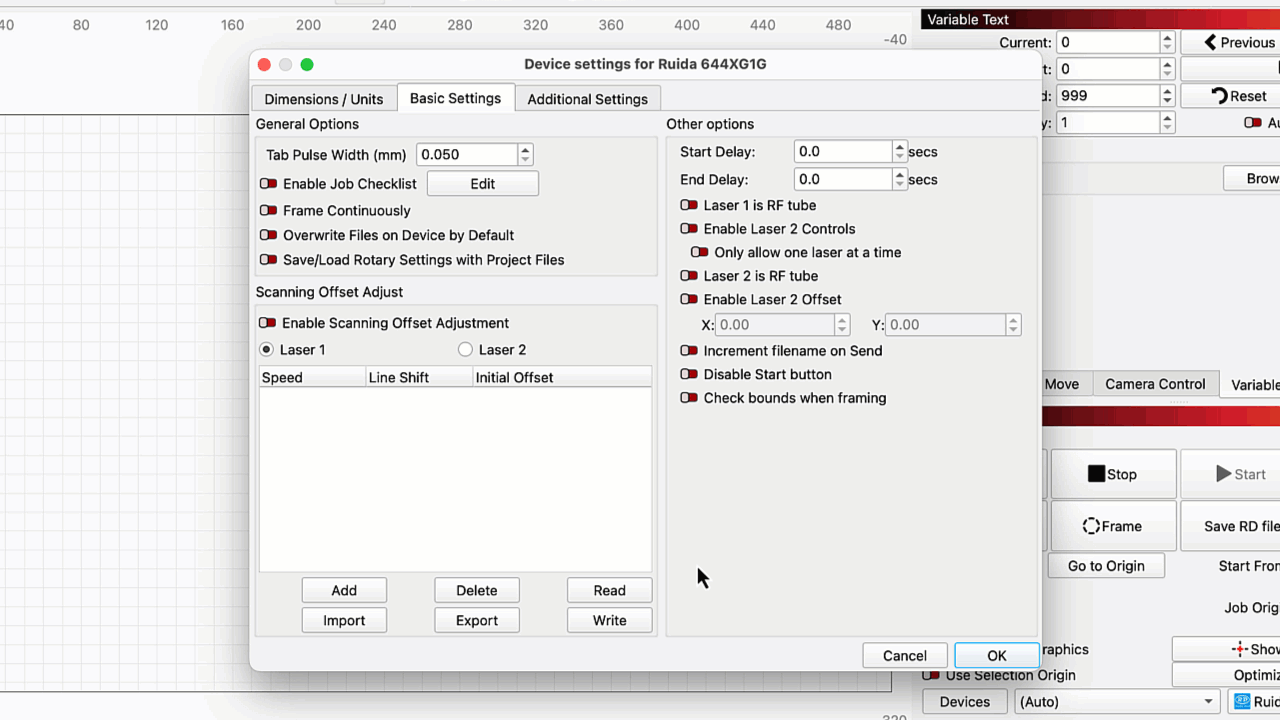

Some Ruida controllers allow the ability to directly Read Scanning Offset Adjustments stored in the controller's settings, or Write new settings from LightBurn.
These buttons only appear when LightBurn is directly connected to a Ruida controller that supports the Read/Write functions.

To use this feature, you need to measure the response of your machine at a few different speeds.
Create a rectangle in LightBurn, 50 mm wide and 10 mm high,
Make sure the rectangle is assigned to a layer set to Fill Mode, and apply an appropriate Power setting to visibly engrave the material you loaded into your laser without charring.
Set the Line Interval to 0.5 mm.
If you are on a GCode based device, enable Overscanning, and set it to 5% or greater to be sure the machine is not slowing down before reaching the ends. (Ruida devices overscan automatically).
Run the rectangle at multiple Speeds. At least two will be required for this process, but using more will improve the quality of your results. Make sure you use speed settings your laser is capable of reaching, and keep track of the speed used for each run. The exact speed settings you use will depend on your machine, but you should test several different speeds representing a range of speeds your laser can achieve.
To compensate for the misalignment of lines, measure the distance between the ends of the lines at each Speed. You'll need to enter half that distance in the next step.

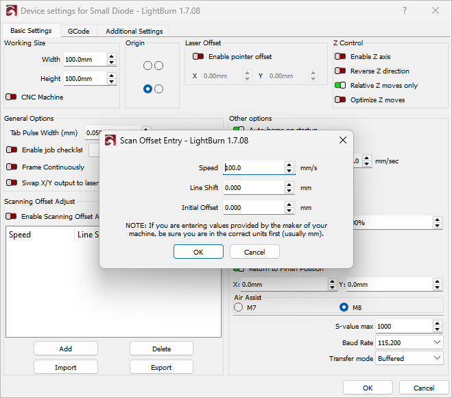

In the Scanning Offset Adjust section of the Device Settings window, click Add to enter the Speed and Line Shift (distance between ends of lines) values into the Scanning Ofset Adjustment table. LightBurn will use this information to compute the correct adjustments for other speeds as well.
Note
You will need to enter half the measured distance between lines — LightBurn moves each line by the amount you specify, so each pair of lines only needs to move half the distance.
Make sure to toggle Enable Scanning Offset Adjustment on, and click OK to exit the Device Settings window and save your changes.

If your machine has two laser sources, you may need to repeat this process and apply unique adjustments for each laser. Click the button next to Laser 2 to apply settings for the second source.

Read and Write Buttons
