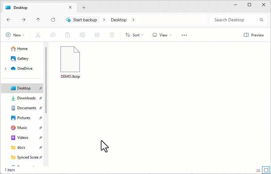

If you need to create a .lbdev file, you can extract one from a User Bundle if needed. To do this:
  1. Export a User Bundle as described above.
  2. Open the .lbzip file in Windows Explorer or in Finder.
  3. Change the extension of the file to .zip instead of .lbzip.
  4. Open the zip folder and copy the .lbdev file you're looking for to a suitable location.
