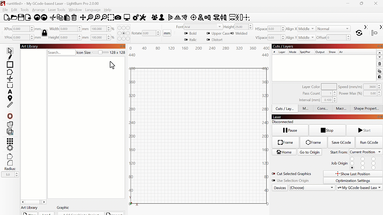

Undocking and re-docking the Art Library Window

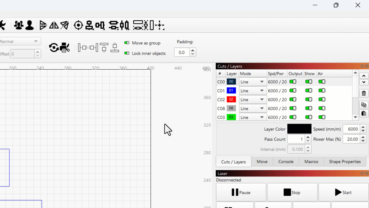

Undocking and re-docking the Tools Toolbar
