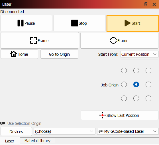

Start¶
The Start button in the Laser Window is the most common method of starting a project, and is available for all types of lasers.
When you press Start, LightBurn will immediately send the project to your laser and it will begin cutting or engraving.
There are a few exceptions to this behavior:
If you've made a settings or job positioning choice that could cause problems, LightBurn may give you a warning message, and ask you whether you'd like to go ahead with the job, or cancel and correct the issue. We strongly recommend correcting the issue. The warning message will tell you what the problem is, and offer advice on correcting it — be sure to read it in full!
If you have a Galvo laser, the Live Framing window will open instead. The same job control buttons that area available in the Laser Window appear in the Live Framing window as well, so you can Start the job from there, after checking positioning again, if necessary. You can bypass Framing by toggling off Require Framing Before Start in the Device Settings window.
For any type of device, you can toggle on Enable Jog Checklist in your Device Settings, to have LightBurn show a checklist that you'll need to confirm before starting the job. This is a great way to make sure you haven't forgotten about any crucial safety procedures before starting your job.
Click here to learn about alternate methods of starting a job
Some types of lasers have additional options for starting projects. If you have a DSP laser, you'll see the option to Send your project to your laser — this option will transfer the probject to your laser's controller. You can use the control panel to access the file and start it from there.
Both DSP and GCode-based lasers have the option to Save in Machine-Specific Format. If you Save in Machine Specific format, LightBurn will save the project with a file extension such as .nc or .rd. You can then transfer the saved file to your machine using a USB stick. This option is not available for Galvo lasers.
If you're using Beginner Mode you won't see this button in the Laser Window, but the option is also available in the File Menu.

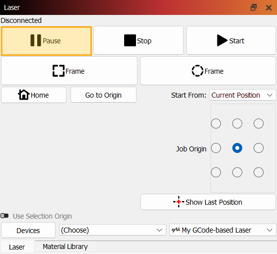

Pause¶
Click the Pause button while your laser is working to temporarily halt the job. You'll be able to click again to Resume.

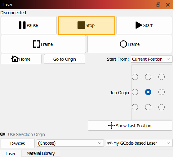

Stop¶
Clicking the Stop button will permanently halt your job, meaning you won't be able to resume right where you left off.
Warning
The Stop button should never be your only means of stopping a job in progress. Locate your laser's emergency stop switch, if available, or be prepared to use another method to compeletely cut power to the machine in the event of a fire. Consult your laser's manufacturer for guidance specific to your machine.
