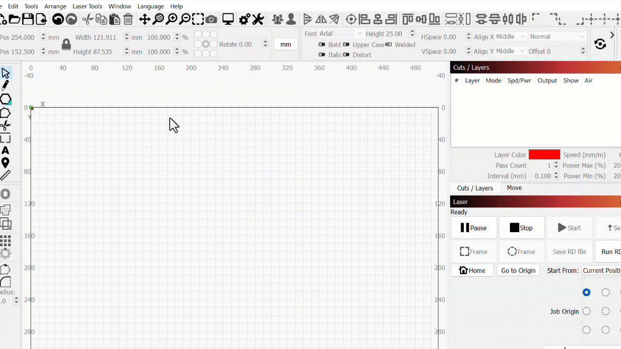

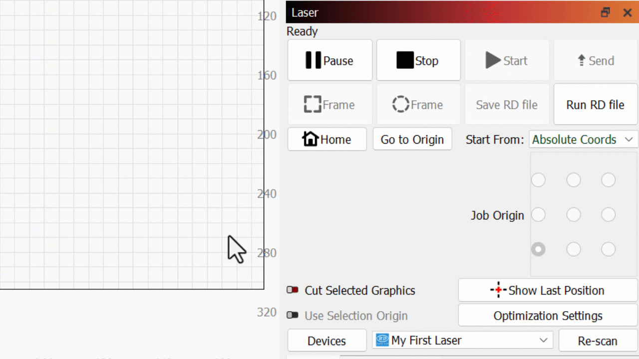

The output location of the test grid in your laser's work area is determined by the Start From mode you select before opening the Material Test Generator window. If you choose Absolute Coords, you'll have additional controls within the Material Test Generator window, but we'll be using Current Position in this guide.
- In the Start From drop down menu in the Laser Window, select Current Position.
In the 9-dot Job Origin selector beneath the drop down menu, select the center position.
Selecting Current Position and the center Job Origin location means the Material Test grid will be centered wherever the laser head is located when you press the Start button later on.

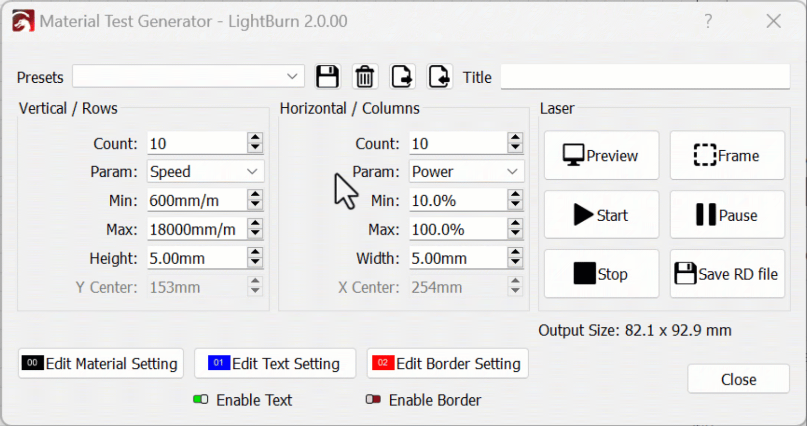

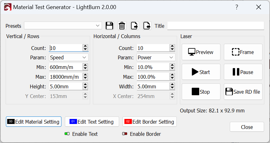

To open the Material Test, go to Lasers Tools → Material Test.
You'll see fields to select from a list of parameters to test, adjust the range of tested values, and change the size, position, and number of test boxes.
Instead of adjusting those fields manually, select a preset from the dropdown menu. You'll see two Built-In Presets each for Diode and CO2 lasers, one Cut test, and one Engrave test. Select the appropriate Engrave preset for your type of laser.
LightBurn will automatically populate the Material Test fields with a range of values that should provide a good starting point for almost all lasers of your selected type.

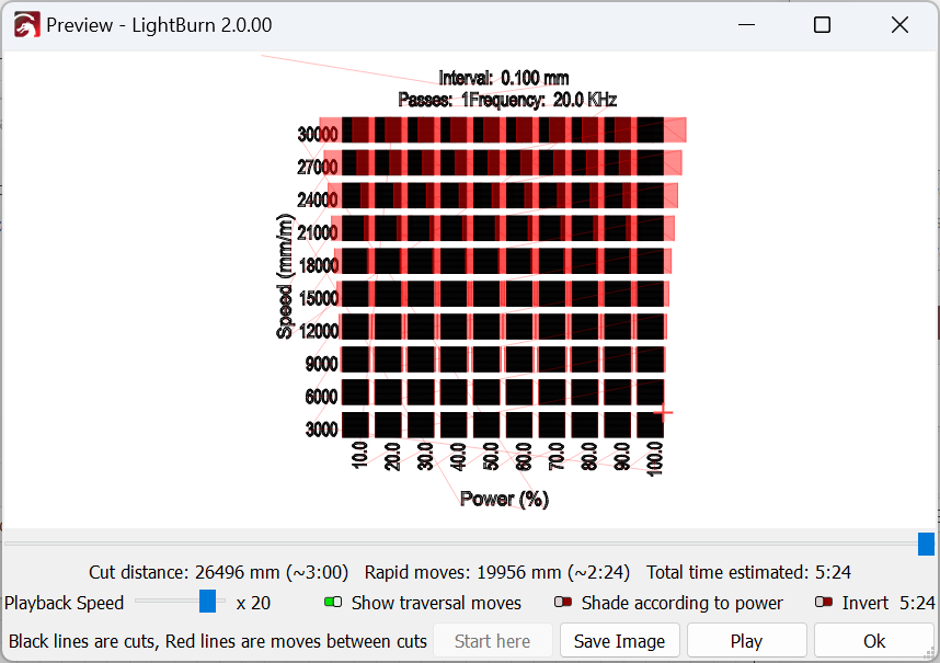

Previewing¶
LightBurn has automatically applied all of the important settings for you, but checking the Preview window before you start any job is still a good habit to get into.
Click the Preview button to open the Preview window.
You'll see a still image of what the final test grid will look like. Press Play to see a simulation of the order in which the grid will be engraved.
Click here to learn more about the Preview window
When you first open the Preview window, you'll see a still image of the final result of your project — the contours to be scored or cut by Line Mode will be indicated by black lines, and the areas to be etched or engraved by Fill Mode will be shown as solid black areas, or, if your Line Interval is relatively large (or you zoom in close enough) as parallel lines running across the filled shapes.
You'll also see red lines — these lines indicate the path your laser will travel while not firing. You can toggle Show traversal moves at the bottom of the Preview window to switch between showing these moves or not.
Press Play to see a simulation of the movements and lasering operations your laser will perform when you start the job. In addition to making sure the laser will outline or engrave the correct graphics and areas, you'll be able to make sure it performs those actions in the order you want.
By default, the simulation will play in a close approximation of the job's real runtime, and Total time estimated is shown in the bottom right. You can adjust the Playback Speed slider to speed up or slow down the simulation.
The order in which test boxes are cut or engraved is determined according to an ascending list of potential risk of burning or charring material.
In other words, boxes with the highest Speed and lowest Power will run first, followed by the next highest, lowest, and so on.

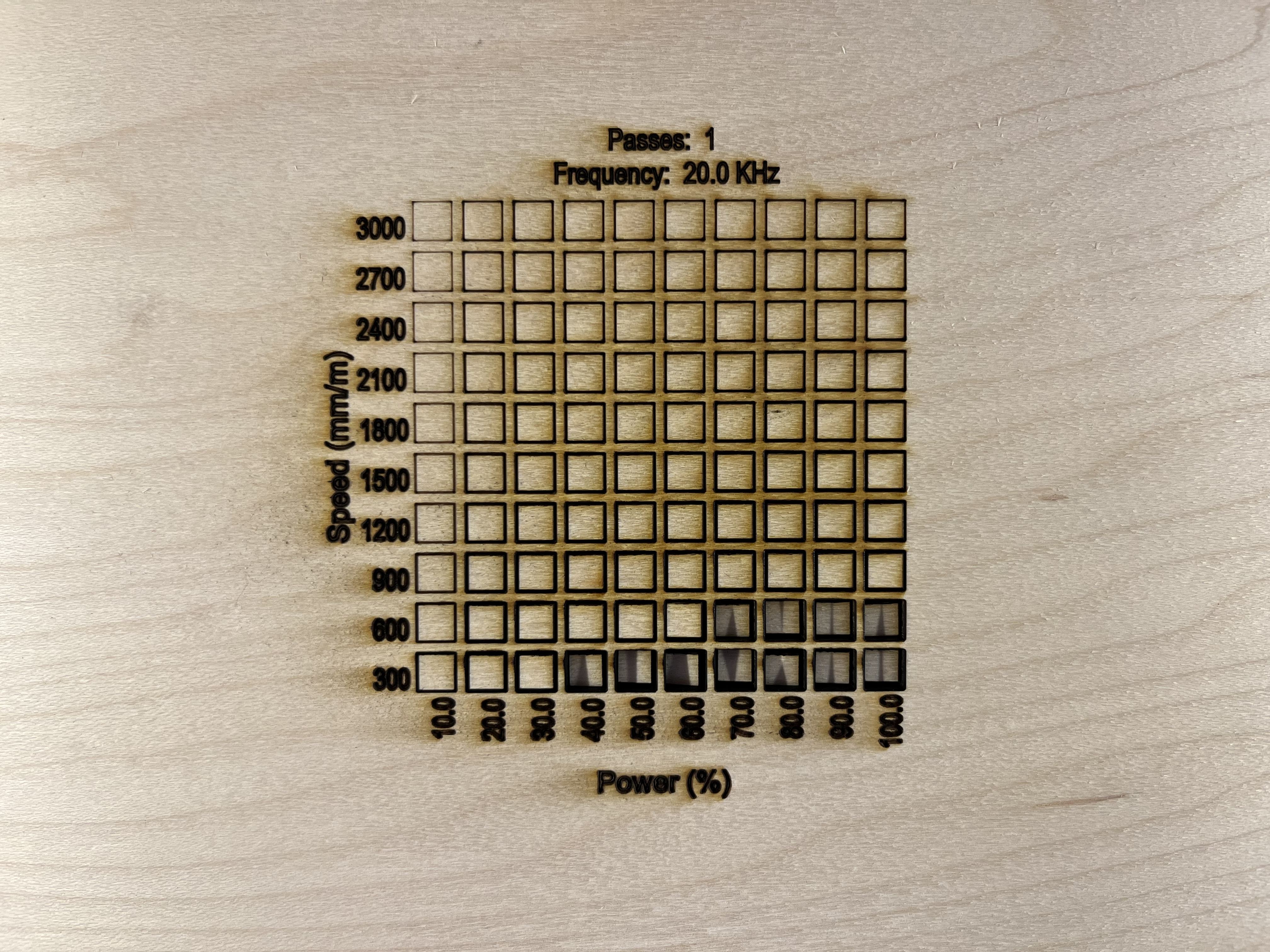

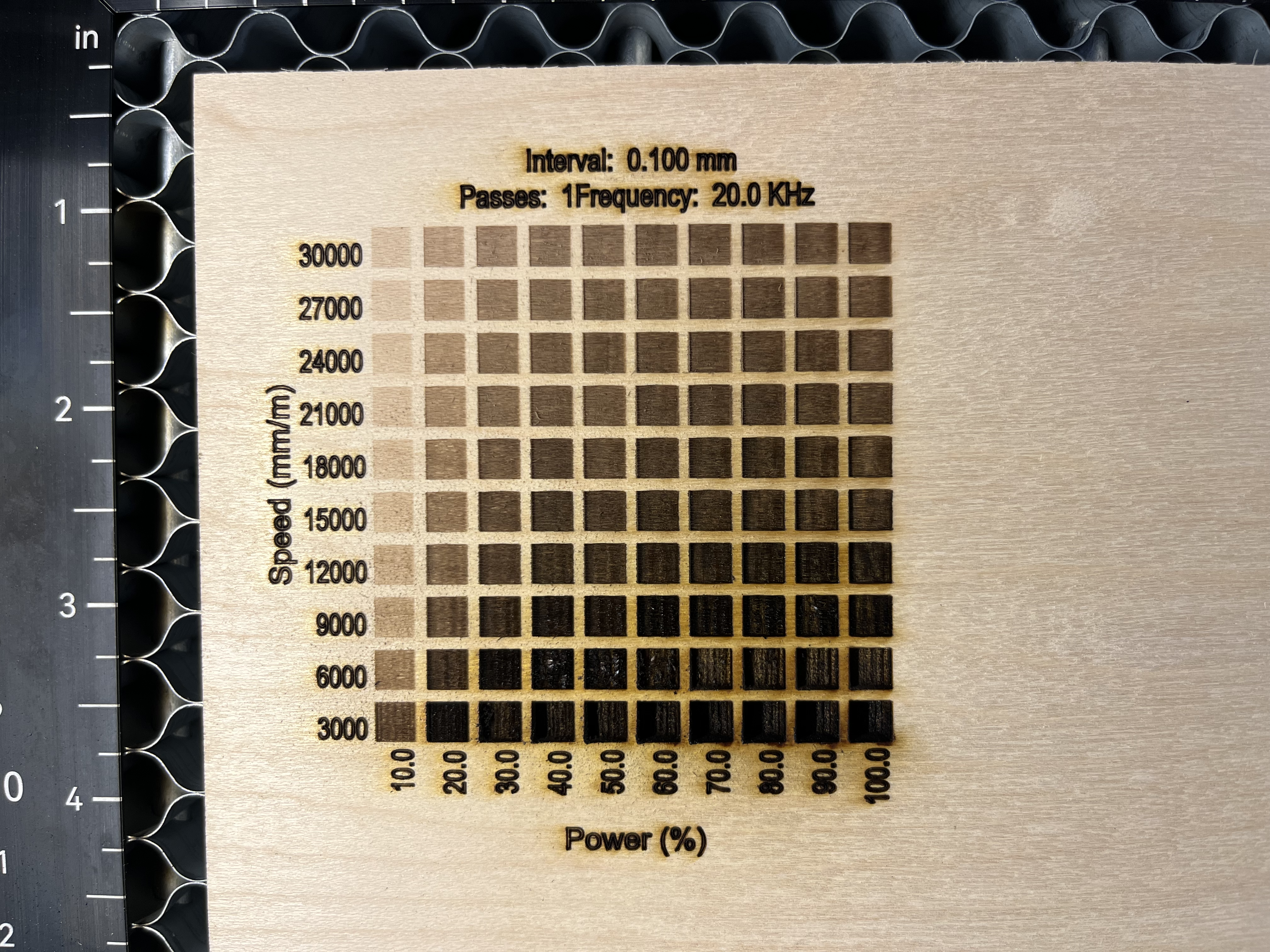

When it's finished, examine the results — find the box that achieves the nicest engraving and make note of them, apply those settings to a Fill layer in the Cuts / Layers Window, or create and save an entry in the Material Library.

When it's finished, examine the results. You're looking for the box that cuts through the most cleanly, without charring. If several cut through with similar amounts (or lack of) charring, you can select the one that achieved a clean cut at the fastest speed.

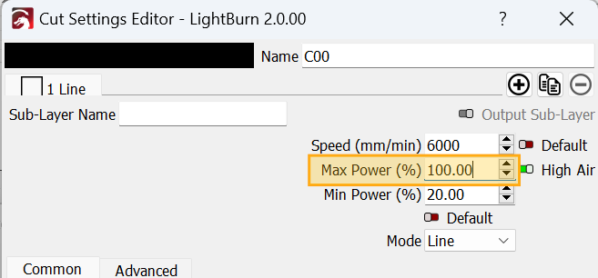

Make note of those settings, apply them settings to a layer set to Line Mode in the Cuts / Layers Window, or create and save an entry in the Material Library.

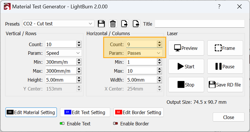

If none cut through, you'll need to make some manual adjustments.
In the second column, open the dropdown menu to replace the Power parameter with Passes.
In the same column, set Count to 9, and Min to 2.
Click Edit Material Setting in the lower left to open the Cut Settings Editor, and set the Max Power to 100.0%.
After Previewing and Framing, run the test again.
