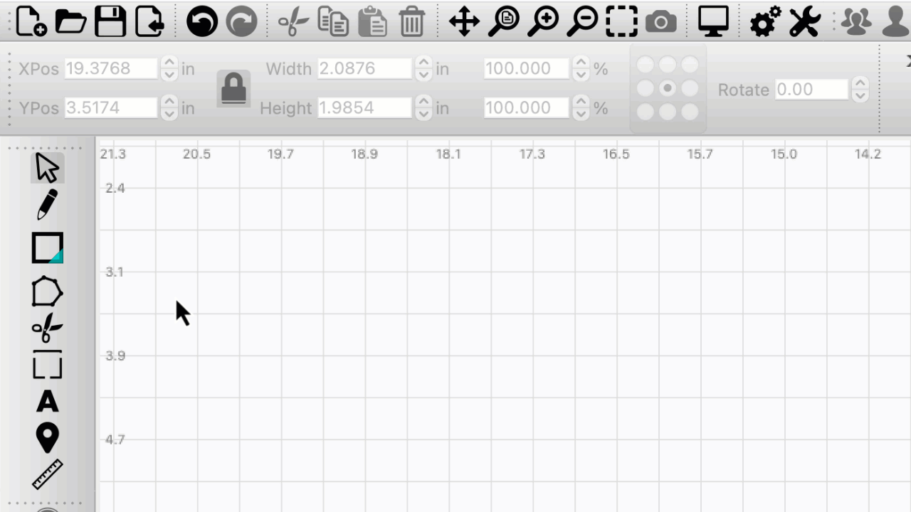

Draw Lines
You can use the Draw Lines tool to create custom lines and curves. Select the tool, click in your Workspace to place one end of a line, then drag and click again to place another point, and a line between. Press S to toggle between creating straight lines and curves between points.
Click here to see a full video guide on using the Draw Lines tool
Draw Lines demo

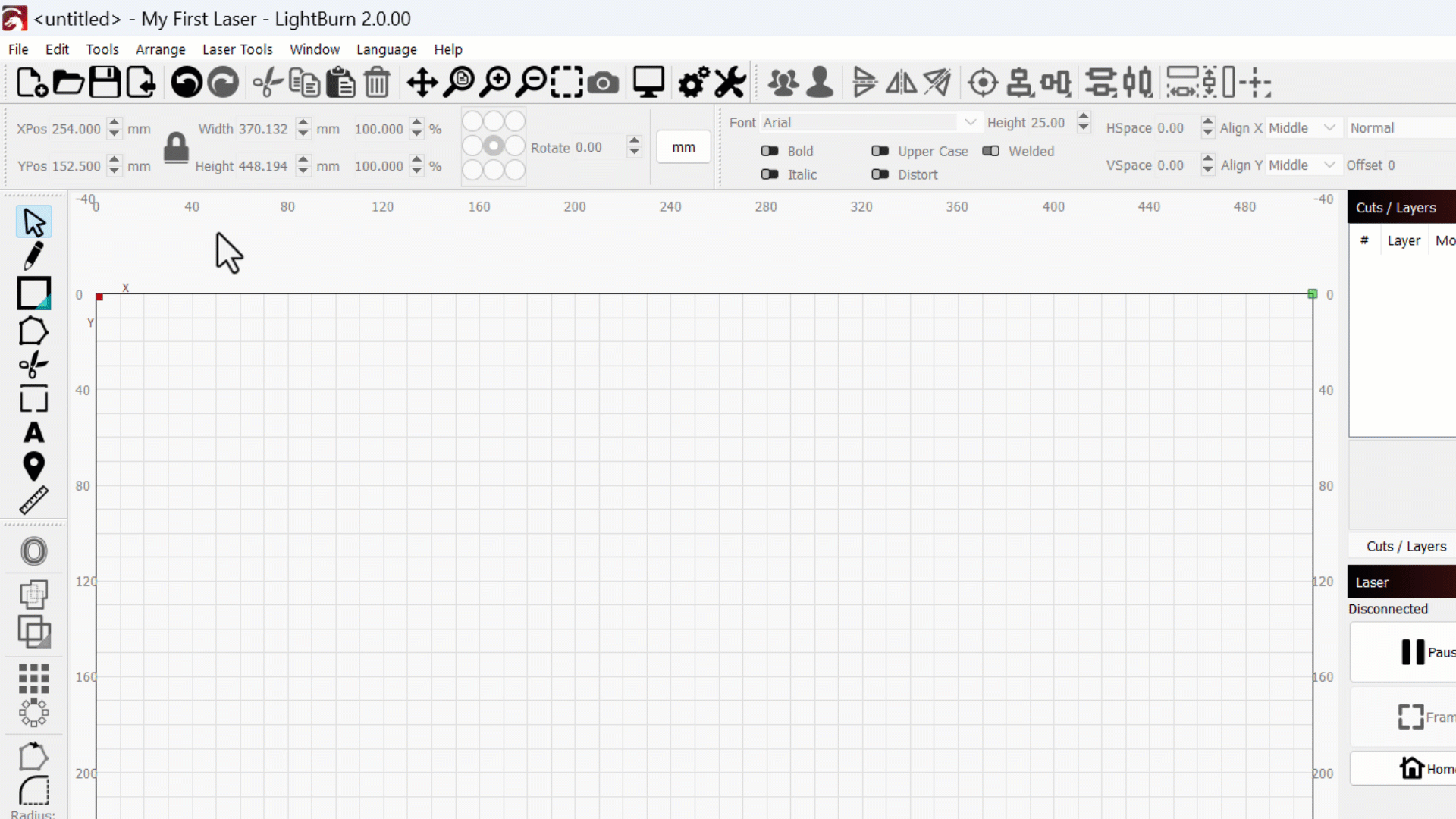

Draw Shapes
Click the arrow in the bottom right corner of the Draw Shapes icon to select from a menu of eight different types of shapes. Then click in your Workspace, hold, and drag to set the size of the shape. Release to finish creating it. If you hold Shift while dragging, the shape's width and height will be the same, so you can create perfect circles and squares using the Ellipse and Rectangle options.
Shape creation demo
