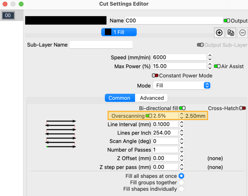

Users with GCode-based lasers have the option to enable or disable Overscanning in the Cut Settings Editor, and to specify the distance.
Overscanning distance is calculated as a percentage of Speed. You'll see the amount of required distance for your combination of Speed and Overscanning percentage to the right of the percentage field.
If you increase Speed, Overscanning percentage, or both, the amount of required distance will go up.
Overscanning setting for a GCode laser
The Overscanning setting for a GCode-based laser

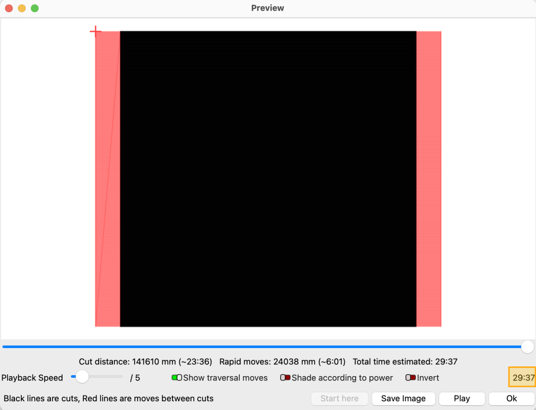

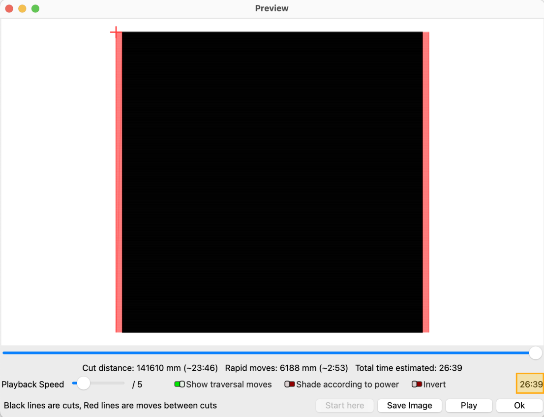

Medium speed job time
Set to 100 mm/second (6000 mm/minute), this graphic will take 26:39 to engrave.
High speed job time
The same graphic, now set to engrave at 400 mm/second (24,000 mm/minute), will take nearly 3 minutes longer to engrave, due to the high amount of Overscanning required.

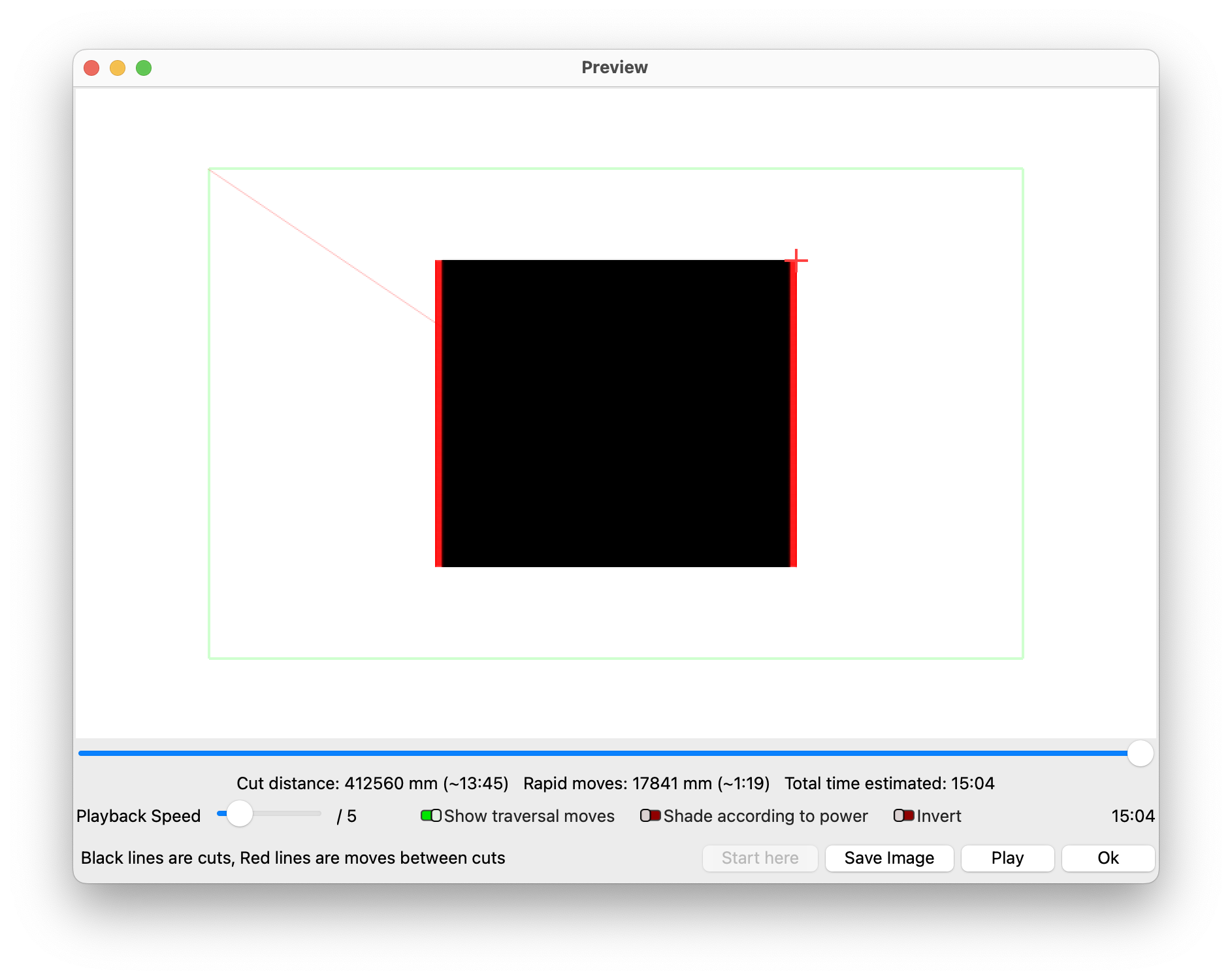

You can check for excessive Overscanning using the Preview window.
Make sure Show traversal moves is toggled on, and you'll see the additional Overscanning moves indicated as red lines (black lines indicate engraving or cutting moves).
The maximum boundaries of your laser's work area are indicated by a green outline. To see the outline you may need to zoom out by pressing - on your keyboard, or by using your mouse's scroll wheel (or two-finger dragging if you're using a trackpad).

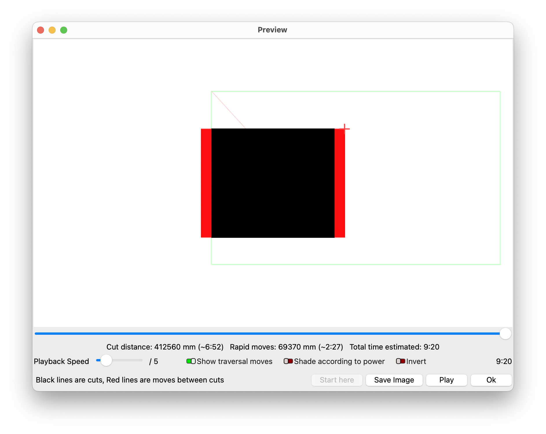

If the red lines cross the green border on one side, and you've selected Absolute Coordinates as your Start From mode, the Overscanning moves will command your laser to travel outside its work area. If you're using Current Position or User Origin, it may still be ok, depending on where you establish your custom origin.

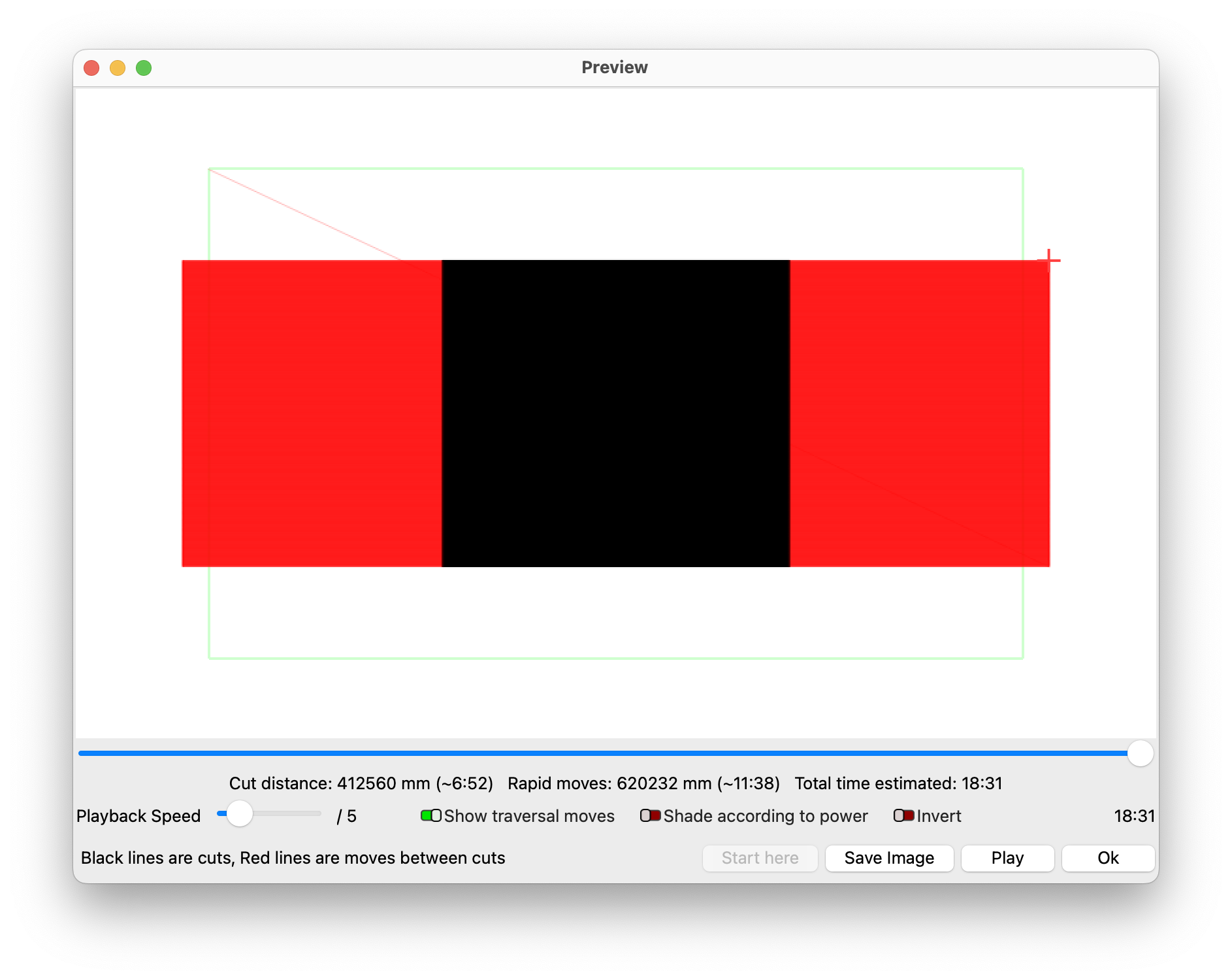

If the red lines cross the green border on two sides, no matter which Start From mode is selected, it means the Overscanning distance is excessive, and will command your laser to travel outside its physical bounds.
Potentially problematic Overscanning
Overscanning crossing a single side of the green outline — this will be a problem if the Start From mode is set to Absolute Coordinates, or if the custom User Origin or Current Position is too close to the edge.
Definitely problematic Overscanning
Overscanning crossing two sides of the green outline — this will be a problem no matter what Start From mode is selected.
