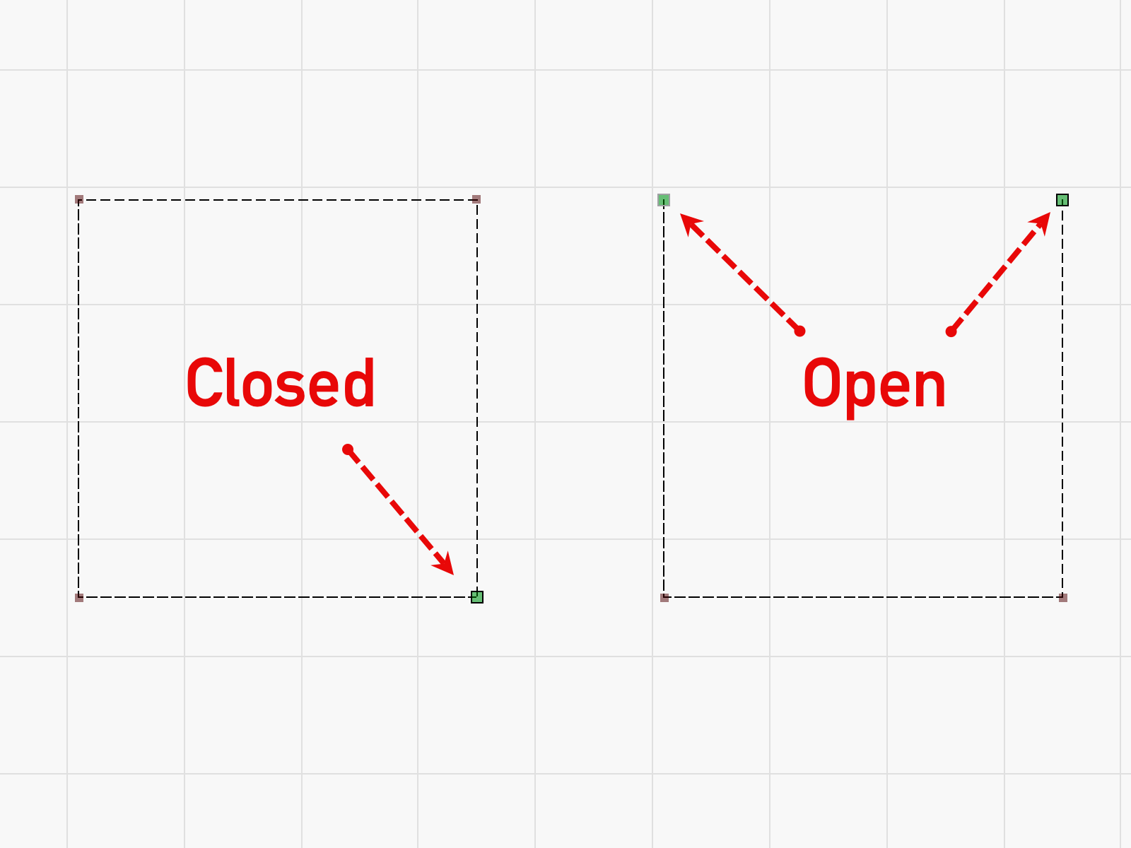

A shape is closed when it is a complete, continuous loop whose start and end points are the same. When a shape's start and end points are different, it is open.
You can view a shape's nodes by selecting it and enabling the Edit Nodes tool. Start and end nodes are green, and somewhat larger than connecting nodes.

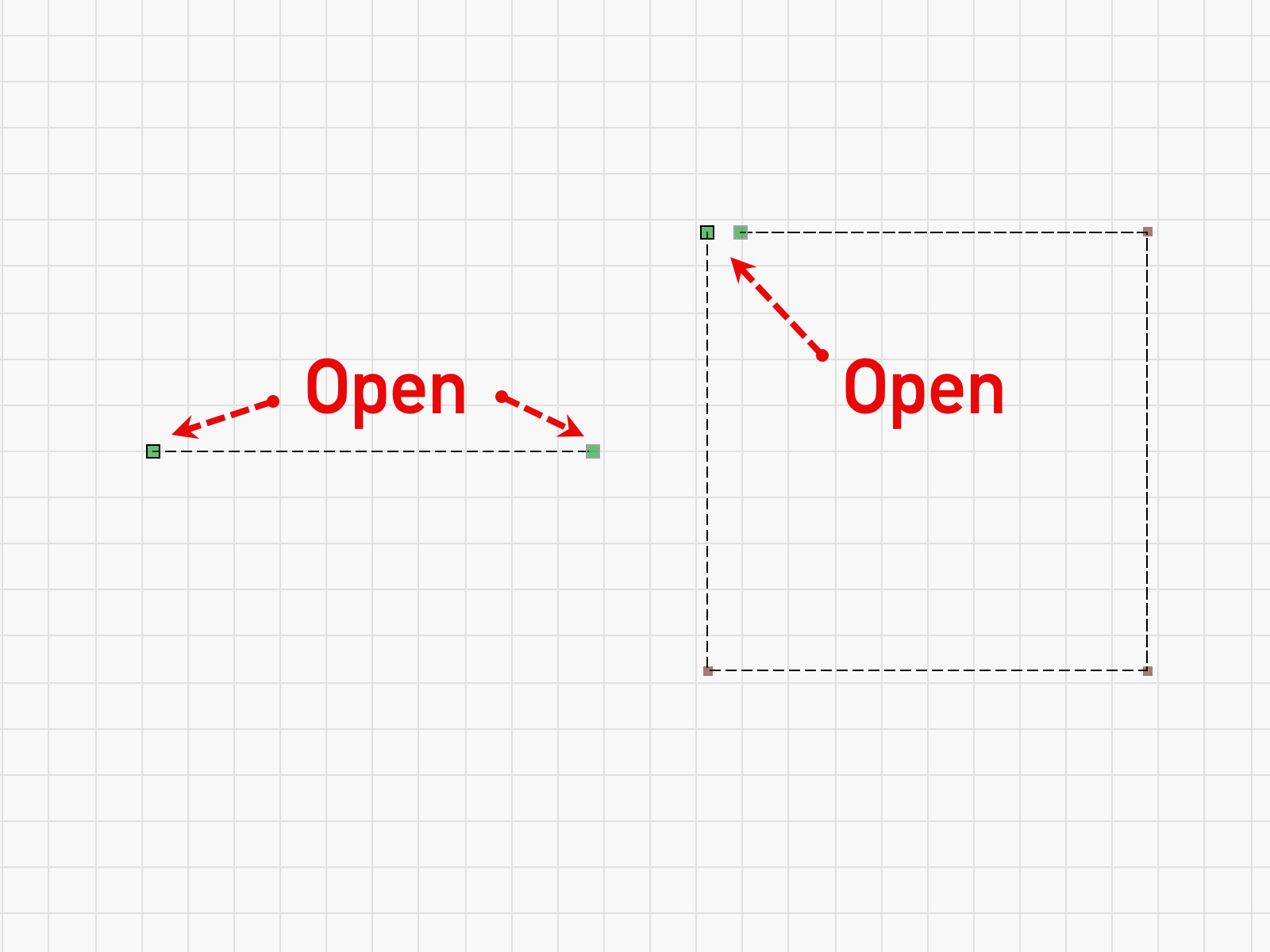

In some cases, as with simple line segments or shapes with large gaps, it's easy to see that a shape is open, but in others it may not be as obvious.
At times, the gaps can be very small, often so small that they are not visible without zooming in very close. Be aware: it is even possible for a start and end point to be directly on top of one another, but not connected, making a shape open.
LightBurn provides several methods for identifying whether a shape is open or closed.
Edit Nodes
As mentioned above, it is always possible to select a shape and the Edit Nodes tool to identify where its start and end nodes are, and whether they are the same, making a closed shape, or different, making an open shape.
In some cases, you may need to zoom in to see gaps.

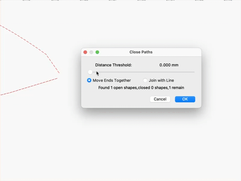

Close Selected Paths With Tolerance
Close selected paths with tolerance is also found in the Edit Menu, and, like Close Path, can only connect a shape with one start and one end node.
Unlike Close Path, this option opens a pop up menu that allows you to specify the Distance Threshold (tolerance), between start and end nodes you'd like to close.
You can also choose whether you'd like to join the start and end nodes by bringing the existing lines together with Move Ends Together, or by creating a new line segment between them using Join with Line.
At the very bottom of the window, you'll see a readout of how many open shapes were found, how many shapes have been closed, and how many open shapes remain in your Workspace.
Click OK to confirm the changes and close the selected shapes, or Cancel to discard them and leave the shapes open.
