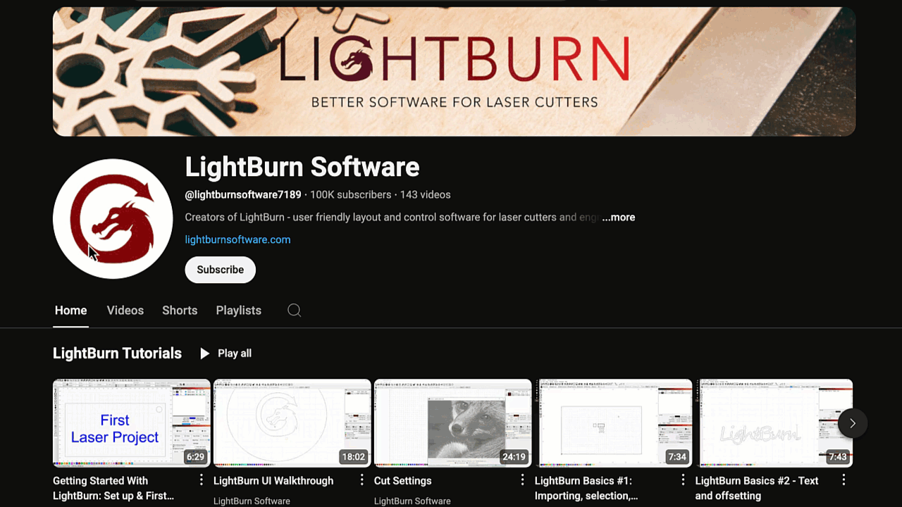

Quick Tip Videos
Check out our YouTube channel to see dozens of short videos with tips and tricks for using LightBurn effectively.
We're always producing new videos with time-saving tips, so be sure to subscribe while you're there so you never miss out.
Quick Tip Videos on LightBurn's YouTube channel
Visit Our Channel

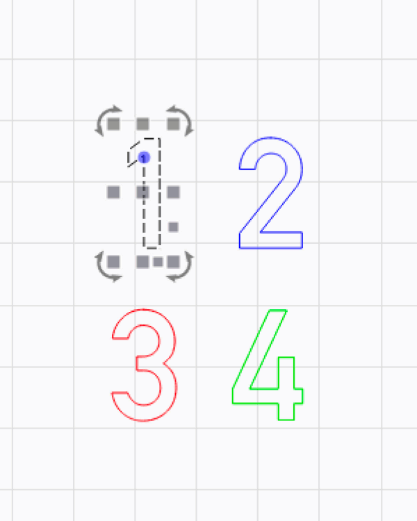

Tab Key Selection Cycling
Press Tab to cycle your selection sequentially through objects or Grouped objects in your Workspace. Press both Tab and Shift to cycle in reverse order.
Sequence is determined by the order in which the objects were created.
Learn More
Tab key selection cycling
