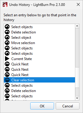

Undo History Window¶
LightBurn's new Undo History feature makes it easier to navigate a long undo list.
Go to Edit → Undo History to open the Undo History window. You can scroll through the list and select actions to preview your project as it was at that point in the project's history.
After selecting an action, click Ok to jump back to that action, undoing everything you've done since that point.
