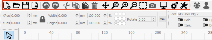

Accessing the Main Toolbar
The Main Toolbar is located on the left side of the top toolbar in LightBurn by default, to the left of the Arrange Toolbar.
Main Top Toolbar
If you have closed the Main Toolbar, go to WindowMain to re-enable it.
To restore it and all other toolbars and windows to their default positions, go to WindowReset to Default Layout.
Tip
The layout of LightBurn is highly customizable. For more information on enabling and disabling windows and toolbars, or rearranging the default layout, see Customizing the LightBurn Window.
Main Toolbar Options
Click any option in the image below to go directly to the relevant page for that tool, or scroll down for a list of options and descriptions.
