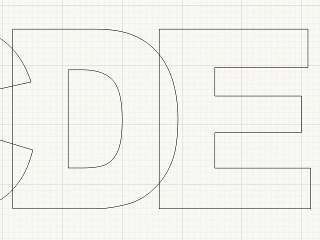

Use the Trim Shapes tool to cut line segments back to the next intersection with another line.
If a shape does not intersect with any other lines, Trim Shapes deletes the entire shape.

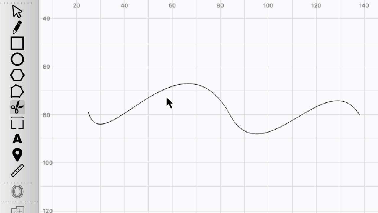

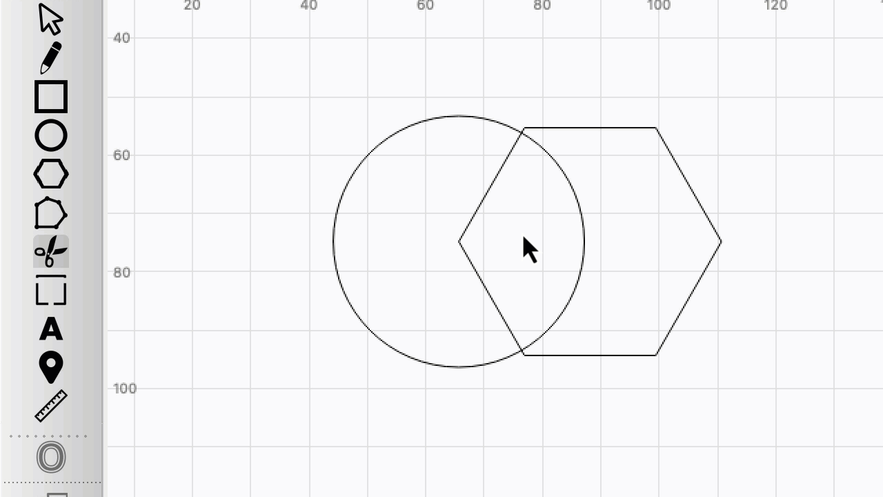

After activating the Trim Shapes tool, hover over any vector object in your Workspace to see a preview of the effect Trim Shapes will have on that object.
  • When you hover over a valid line segment, the cursor will change to the scissor icon, and the segment to be deleted will turn red.
  • Click to delete the segment.
Trim Shapes demonstration

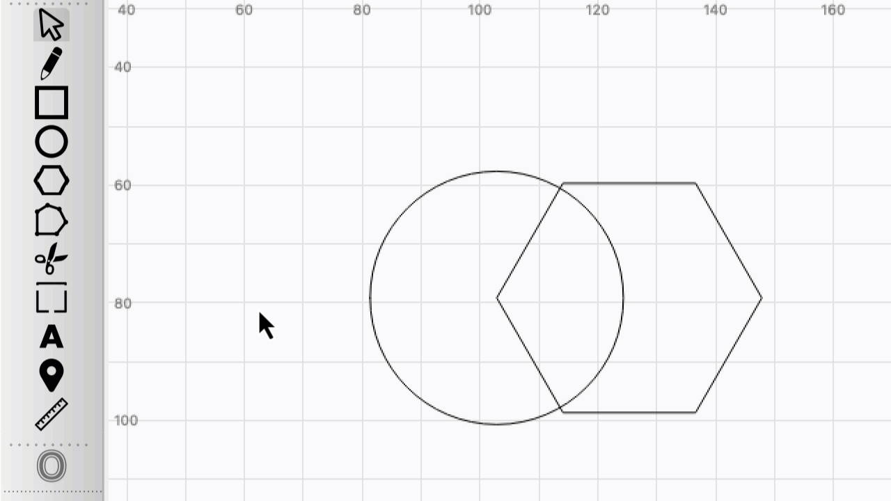

Primary Shapes
This feature works with Primary Shapes, but will remove the ability to edit their special Shape Properties, as they are Converted to Paths in the process.
If you hover over a shape that does not intersect with any other lines, the entire shape will be highlighted in red, and deleted when you click.
Trim Shapes — deleting whole shape

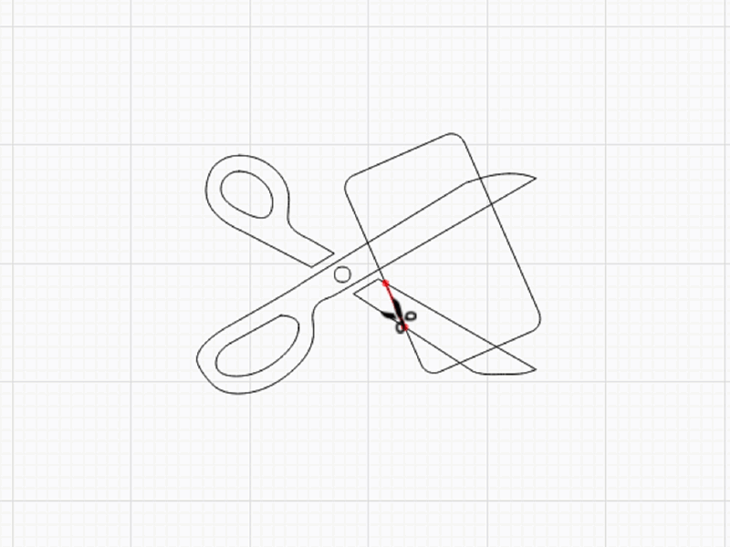

Auto-Joining With Trim Shapes
When possible, Trim Shapes joins the new vector objects at the points where they used to intersect, combining them into a single path.
When a shape has been joined with another, it will automatically be selected, and you'll see the animated dash pattern that indicates selected objects.
Trim Shapes Autojoining Demo
Note
Hold Ctrl / Cmd while clicking to disable automatic joining when using Trim Shapes.
Preserve Trimmed Line Segment
Sometimes, it's useful to preserve a copy of the trimmed line segment. Hold Shift while trimming to make a copy of the removed line segment and move it to the currently selected layer. LightBurn will warn you if this is the same layer the shapes being trimmed are on.
Demo of trim while preserving line segments
