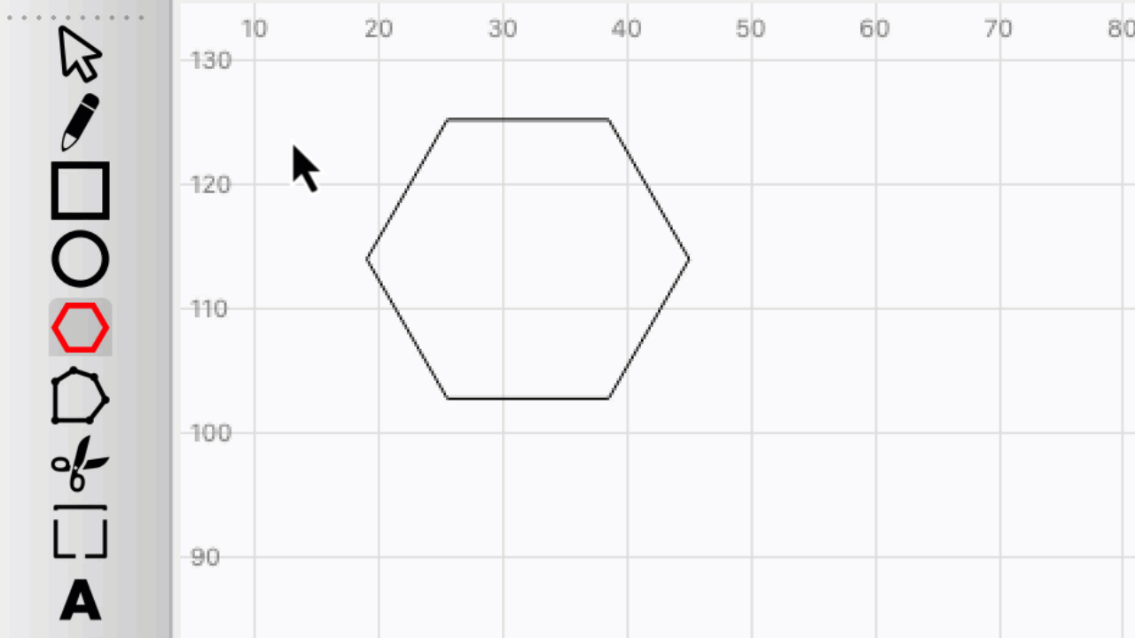

Making Selections
The Select tool is active by default. To reactivate it after using a different tool, click the cursor icon in the Creation Toolbar, or press the Esc key.
Select tool in Creation Toolbar
Click Selection
With the Select tool enabled, click any object in your Workspace to select it.

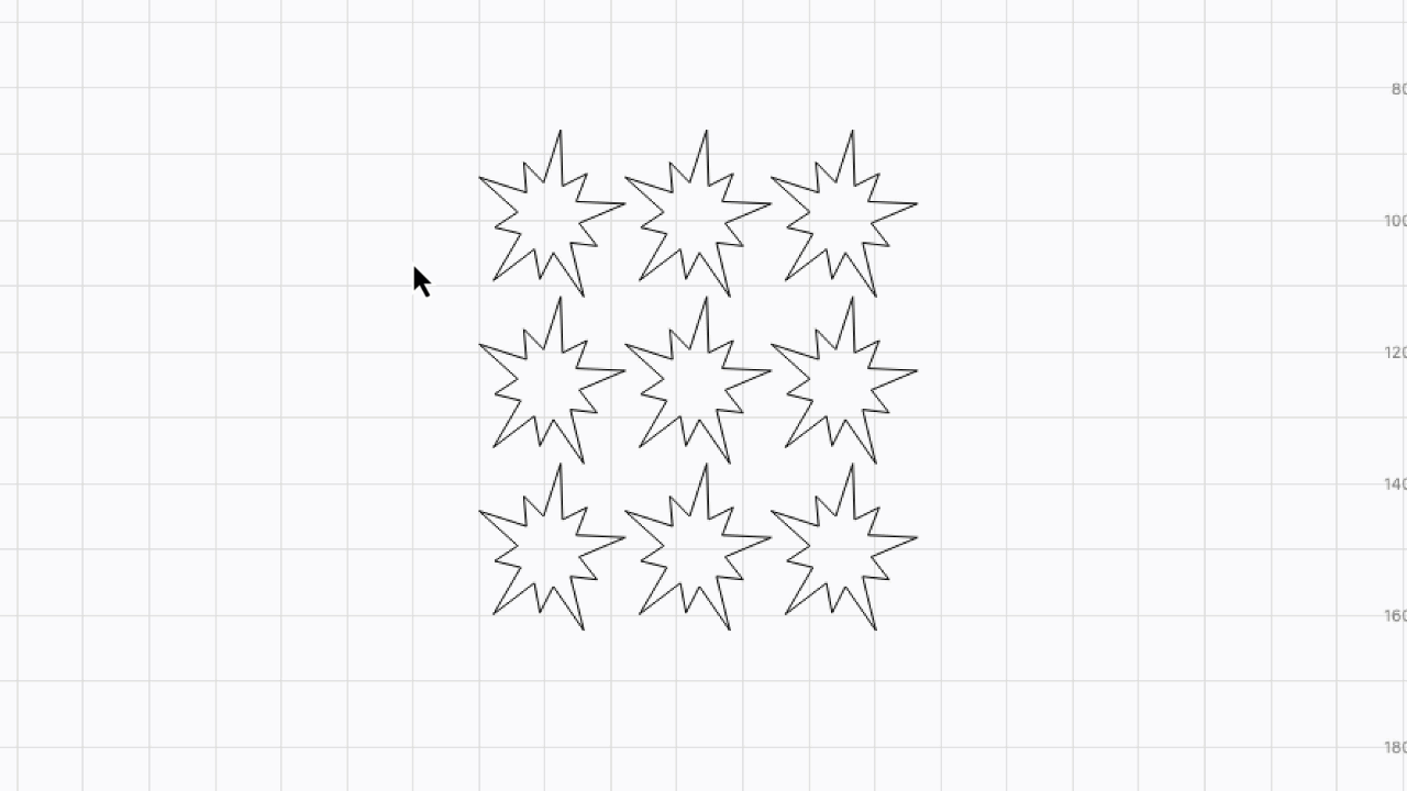

Box Selection
Select several shapes at once using one of two box selection options.

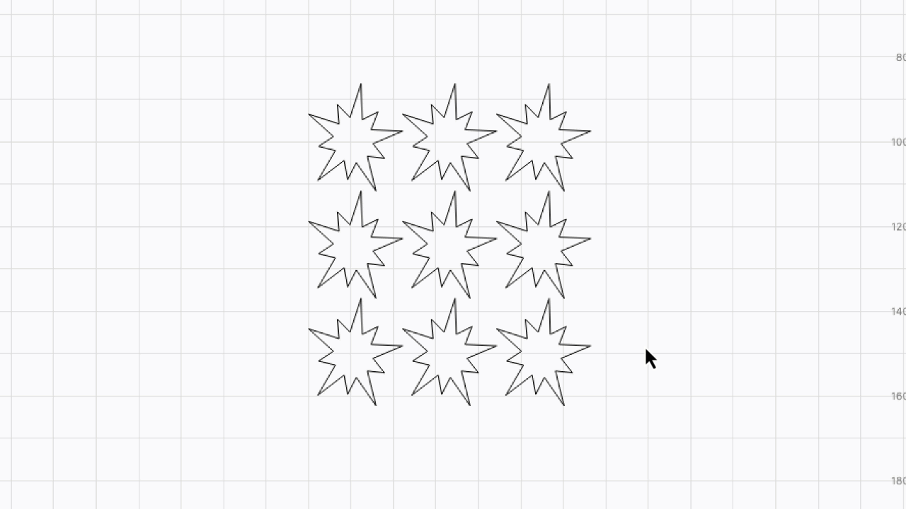

Enclosing Selection
With the Select tool enabled, click, hold, and drag to the right to create a red Enclosing Selection box. Release to select all objects that are fully contained within the box.
Enclosing Selection
Crossing Selection
Click, hold, and drag to the left to create a green Crossing Selection box. Release to select all objects that are fully contained or crossed by the lines of the box.
Crossing Selection

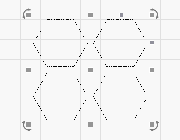

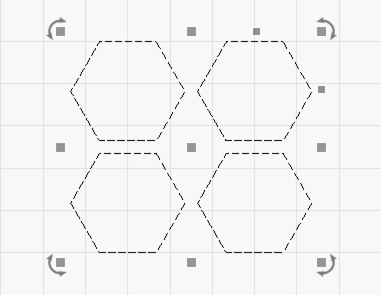

Selection Indicators
Selected objects are drawn with an animated dash pattern instead of solid lines. If you select Grouped objects, you'll see a dot-dot-dash pattern instead.
Ungrouped Objects Selected
Grouped Objects Selected

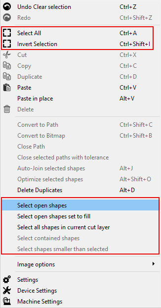

Additional Selection Tools
Several other selection options are available in the Edit Menu.
Select All
Ctrl / Cmd + A
Selects all graphics in your project.
Invert Selection
Ctrl / Cmd + Shift + I
Deselects all objects that are currently selected and selects all objects that are not currently selected.
Select Open Shapes
Selects all shapes in your project that are open, meaning they are not paths that form a closed, continuous loop. See Open vs. Closed Shapes for more information on open shapes.
Select Open Shapes Set to Fill
Selects all shapes in your project that are open, and assigned to a layer set to Fill or Offset Fill Mode. LightBurn is unable to fill open shapes — this tool is a useful option for identifying them.
Additional Selection options
Select All Shapes in Current Layer
Selects all shapes assigned to the active layer in the Cuts / Layers Window.
You can perform the same action by holding Shift while clicking on a layer in the Cuts / Layers Window.
Select Contained Shapes
Selects all shapes contained by the currently selected shape. To use this tool, the selected shape must be closed — a path that forms a continuous loop. The containing object remains in the resulting selection.
Select Shapes Smaller Than Selected
Selects all shapes that are smaller than the currently selected object. The currently selected object remains in the resulting selection.
