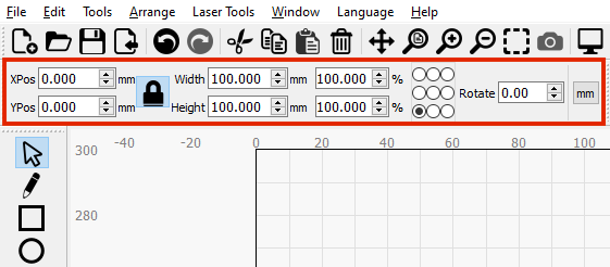

Accessing the Numeric Edits Toolbar
The Numeric Edits Toolbar is located in the top toolbar in LightBurn by default, to the left of the Text Options Toolbar.
If you have closed the Numeric Edits Toolbar, go to WindowNumeric Edits to re-enable it. To restore it and all other windows to their default positions, go to WindowReset to Default Layout
Numeric Edits Toolbar location

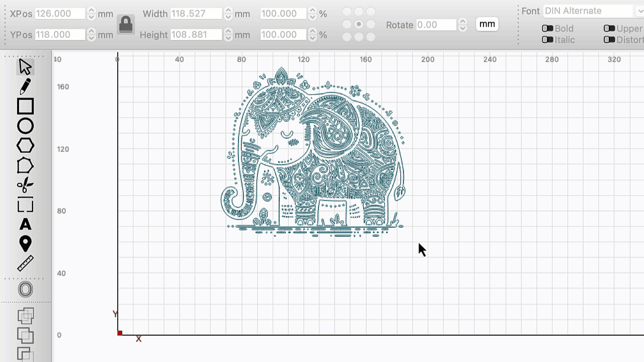

XPos and YPos
XPos and YPos display the current X (horizontal) and Y (vertical) positions of your selection, relative to the point in your selection indicated by the 9-Dot Control, and your laser's Origin.
The laser's Origin is indicated by a small red square in a corner of the Workspace. Positive XPos and YPos values are always within the Workspace, and negative values outside of it.
Adjusting either field will move the indicated position on the current selection to the new location you enter, and all objects in the selection will move in unison.
Adjusting X and Y Position Demo
Tip
You can adjust position by imprecise values directly in your Workspace using the Move handle on your selection.

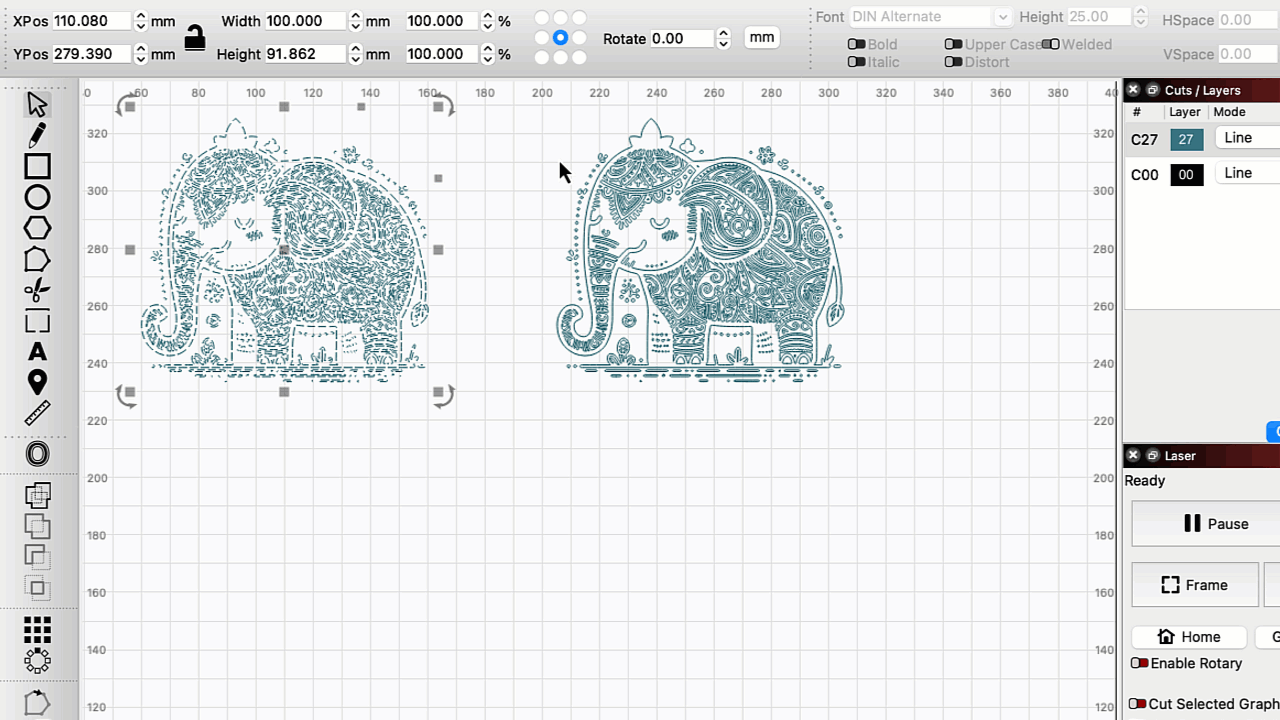

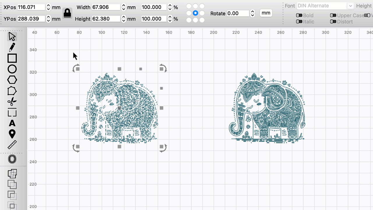

Width and Height
Width and Height display and determine the length of your selection in the X (Width) and Y(Height) dimensions. You can enter exact values in the field directly to the right of Width and Height, or change the size of either dimension by percentage in the fields to the right of those.
The chosen location in the 9-Dot Control determines an anchor point that objects will be rescaled in toward or away from.
Width and Height demo
Tip
You can adjust Width and Height by imprecise values directly in your Workspace using the Size handles on your selection.

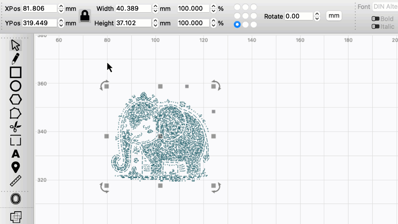

Lock
The Lock icon to the left of Width and Height determines whether the aspect ratio of the selection is maintained as objects are resized.
  • In locked mode — indicated by a highlighted, closed lock icon — the proportions of your selection remain consistent as they're resized.
    As an example, a rectangle that is currently 50 mm wide and 25 mm tall is twice as wide as it is tall, for a 2:1 aspect ratio. If the aspect ratio is locked, changing the width to 80 mm will automatically change the height to 40 mm.
  • In unlocked mode — indicated by an unhighlighted, open lock icon — the proportions of your selection will not remain consistent as they're resized, and will instead change independently.
  • Click the icon to change modes.
Lock Demo

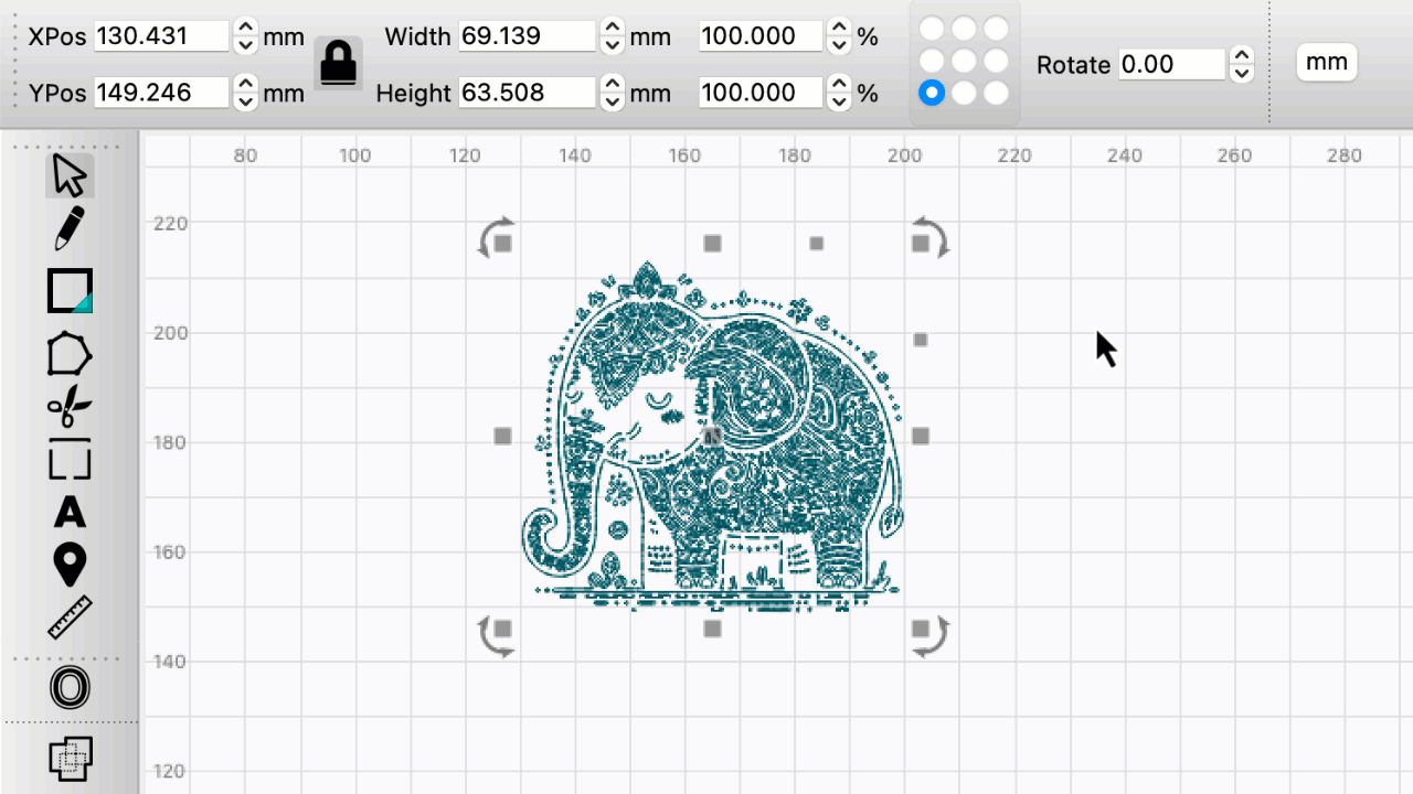

Rotate
Use the Rotate field to turn the current selection by a precise number of degrees. Positive values rotate the selection clockwise, while negative values rotate it counterclockwise.
The chosen location in the 9-Dot Control determines the center of rotation.
Rotate demo
