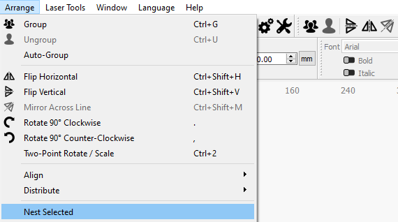

  1. Select any graphics you'd like to nest along with a container shape — usually a shape that has the same dimensions as the material you are going to cut the nested graphics out of — then go to the Arrange Menu and click Nest Selected.
    Important Note on Inner Shapes
    LightBurn does not export graphics that are contained inside another graphic — this means all of the graphics you'd like to nest must be outside the container shape you choose.
    Once your graphics have been nested within the container shape and re-imported, LightBurn will automatically move any shapes that were contained within them so they maintain their relative position.
    Nest Selected in the Arrange Menu

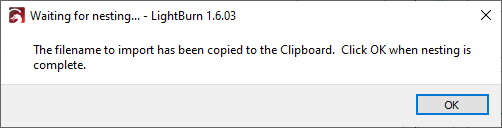

  2. Your default web browser will automatically open to SVGnest.com, and a dialog window will open in LightBurn, informing you that an SVG has been created and its file name (LightBurnNest.svg, along with a file path), has been copied to your clipboard.
    Nest Selected Dialog Box

  6. Back in LightBurn, click OK in the dialog box. Your file browser will open — navigate to the location of the SVG you downloaded from SVGnest, and import it into LightBurn.
    Note
    LightBurn will automatically delete the LightBurnNest.svg file it created and exported after you import the new file from SVGnest.
