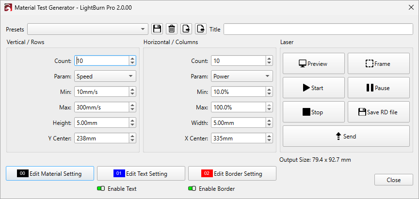

Material Test Dialog
The Material Test dialog as it appears for a DSP laser
After opening the Material Test Generator, you'll be able to configure your test pattern. By default, the Material Test Generator will create a 10x10 grid of boxes with varying Power and Speed. Use the Param dropdown to select different parameters to test.

Test Configuration
Use the settings below to configure your test grid. The parameters tested can be Power, Speed, Interval, or Passes. Frequency and Q-Pulse width can also be tested, if your laser supports those settings.
Test Grid Settings Explanation
Count How many rectangles are in each row/column
Param The setting being tested along this axis
Min The lowest value to be used for this setting
Max The highest value to be used for this setting
Height/Width The height/width of each rectangle in the test grid
Y Center/X Center The position of the center of the test grid (if using Absolute Coordinates)

The three buttons at the bottom of the dialog box open the Cut Settings Editor, where you can adjust the settings to use in your test. There are two switches to enable or disable the text labels and border.
Button Explanation
Edit Material Setting Base settings for the test — the two settings chosen in Param will be varied in the grid, but all other settings applied here will apply to every test box
Edit Text Setting Settings to use for the text labels
Enable Text This switch controls whether text labels are output
Edit Border Setting Settings to use for the border around the test grid — available in LightBurn 1.5 and higher
Enable Border This switch controls whether the border around the test grid is output

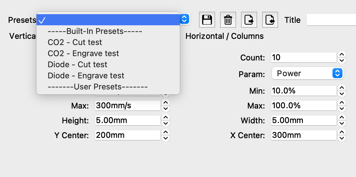

There is also a dropdown allowing you to select a saved Preset. This is useful if you have custom settings you like to run frequently, such as a smaller test pattern you want to use on metal tags, or a range of settings you want to test on various woods.
At the top are buttons allowing you to save, delete, export, and import presets.
To locate the presets saved on your computer, go to FilePreferencesOpen Prefs Folder. You'll find the material_test_presets.lbmt file inside the presets folder.
Presets can also be exported in a User Bundle.
Built-in Presets
LightBurn provides four Built-in Presets for users with Diode or CO2 lasers. All four are selectable from the dropdown menu in the Material Test Generator dialog window.
