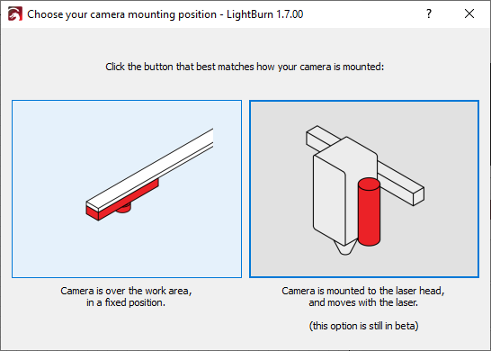

Selecting Camera Position
To begin the alignment process, go to Laser ToolsCalibrate Camera Alignment or right-click in the Camera Control window and select Calibrate Camera Alignment from the context menu.
Select the option on the right side: Camera is mounted to the laser head, and moves with the laser.

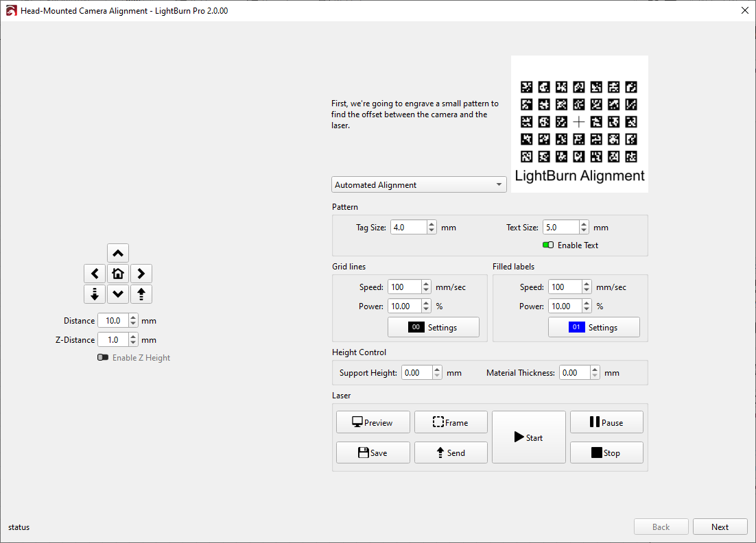

The rest of this process will be completed within the Head-Mounted Camera Alignment Wizard, which will command your laser to engrave a pattern onto a piece of material, such as card stock, paper, cardboard, or thin wood, and ask you to tag points on the pattern.
Pattern Engrave Settings Step
Step 1
Place your material in the center of your laser's work area.
Step 2
From the dropdown menu, select Automated Alignment (recommended), or Manual Alignment.
Step 3
Enter appropriate Speed and Power settings to get a moderately dark engraving without burning through. This will vary based on your laser and the material you're using, so we can't provide these for you.
Step 4
Frame the pattern to make sure it's positioned on the material you're using.
If necessary, you can adjust the size of the Pattern to fit your material, but make sure it is small enough that your camera will be able to see a substantial portion of the pattern at once.
Step 5
Start the engraving. If it's not dark enough, you can adjust the settings and run it again. When the pattern is clearly visible and easy to see, click Next.

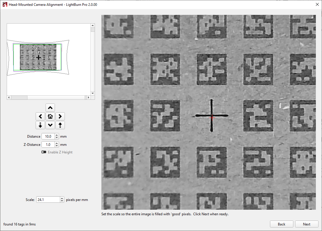

Adjust the Scale value in the lower left of the window until the entire image is filled with "good" pixels.
  • None of the black fisheye effect along the borders should be visible.
  • Make sure no areas that are badly lit or blurry are visible.
  • The best part of the image is typically directly in the center.
Note
Zooming in for a tight focus on the sharpest areas of the image will lead to higher quality captures, but longer scanning times when the camera captures your laser's work area.
Click Next to proceed to the next step.

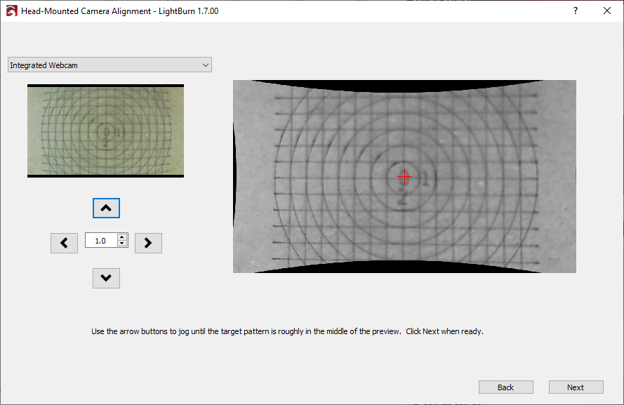

Centering the Laser Over the Pattern
Jog Laser Over Manual Pattern Center
Use the Jog arrows to move the laser head, and with it the camera, until the pattern is postioned roughly in the center of the camera's field of view.
The field in the center of the arrows controls the amount of distance the laser will move with each click.
When the pattern is centered, click Next to proceed to the next step.

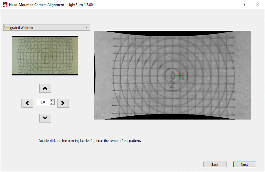

Tagging the Pattern
Next you'll mark four locations near the center of the pattern, and finally four more around the outside of the grid.
When you double-click, a red "+" mark will appear. If you place one incorrectly, you can double-click near it to shift it around.
  1. Double-click the center of the grid to place a red "+" mark there. When the marker is accurately placed, click Next.
    Double-click center
  2. Double-click the intersection nearest to Point 1 in the engraved pattern. Click Next when you're satisfied with the location.

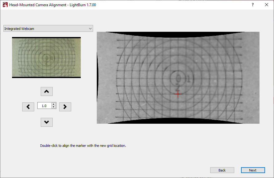

  3. Based on the location you clicked for Point 1, LightBurn will predict a new location at the next grid intersection over. If the "+" mark is not perfectly aligned to a grid intersection, double-click at the closest intersection to align it. Click Next.
    Double-click near point 1

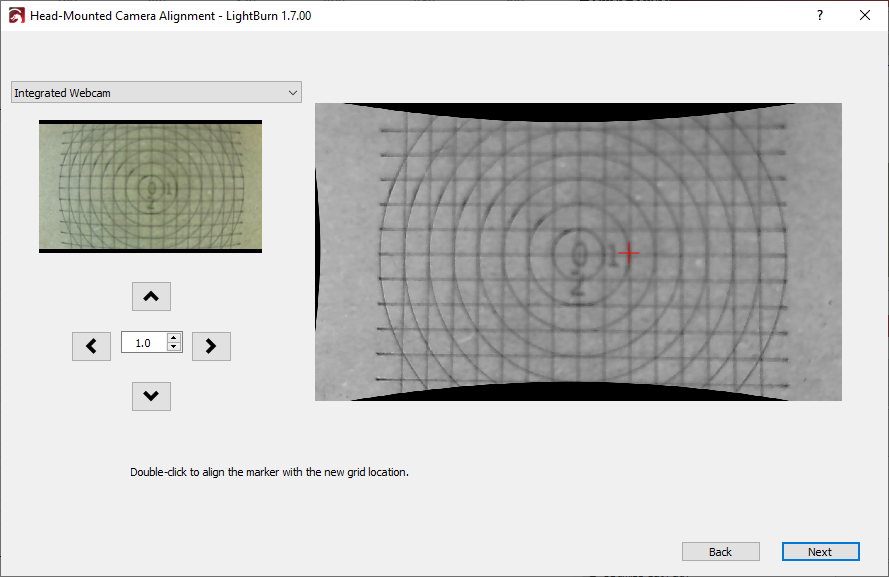

  5. Based on the location you clicked for Point 2, LightBurn will predict a new location at the next grid intersection over. If the "+" mark is not perfectly aligned to a grid intersection, double-click at the closest intersection to align it. Click Next.
    Double-click near point 2

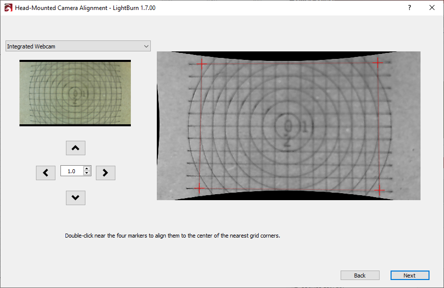

  6. LightBurn will now predict 4 intersections around the outside of the grid. If they are not perfectly positioned over an intersection, click the nearest intersection to realign them to that point. Click Next when each "+" is aligned to the nearest intersection.
  7. Double-click a point to Jog the laser to that location — the point should be centered in the camera's field of view after it is finished jogging.
If the alignment is accurate, click Next to close and finish the process. If it's inaccurate, click Back until the beginning of the tagging process, and try tagging the points again.

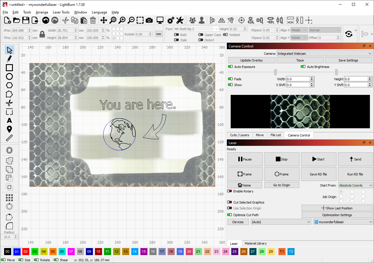

Capturing an Overlay
Click Update Overlay in the Cameras Window to command your laser to jog, pause, take a capture, and repeat, producing multiple images that LightBurn will stitch together to produce an Overlay.
  • If you have an object in your selection, the laser will jog to take captures of only the area within the selected object, and produce an Overlay confined to that area in your Workspace.
  • If you have nothing in your selection, the laser will jog to take captures of the entire work area and produce an Overlay that covers your entire Workspace.
Example Head-Mounted Camera Overlay
