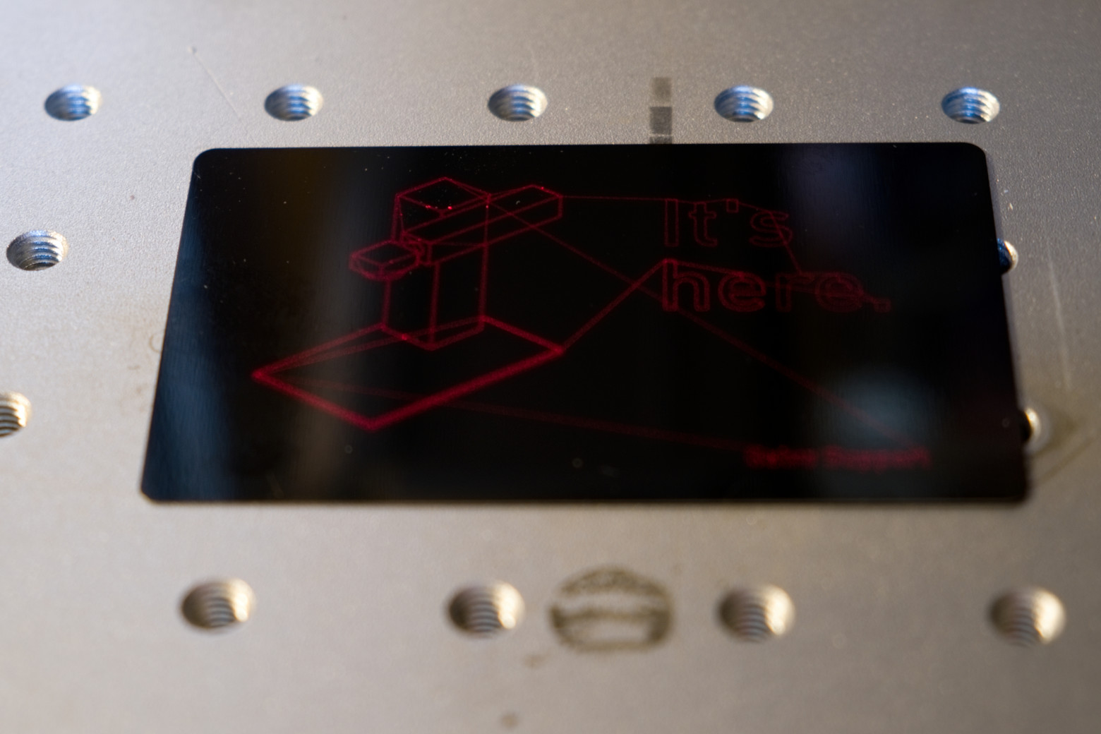

Galvo Framing
Quick Reference: Galvo Framing
  • Hero Image
    Outlines projects in your laser's work area using a red dot light.
Framing is a function of Galvo lasers that outlines projects in your laser's work area using a red dot light, allowing you to see where your design will output on a physical object.
Click the Frame button in the Laser Window or press F1 to open the Live Framing window.
Note
You may need to hold the Fn key while pressing F1 to open the Live Framing window.
By default, the Live Framing window will also open when you press the Start button in the Laser Window, but you can disable Require framing before start in your Device Settings.
The Live Framing window contains options that determine the style of framing, which graphics are framed, and how many times to repeat a given project.
You can Start, Stop, and Pause your projects from the Live Framing window, which remains open while your job is running.
While framing, you can nudge, rotate, and rescale graphics, adjusting them in your Workspace and live-updating them in your laser's work area.
Click any option in the image below to jump directly to the relevant section for that option, or scroll down for a list of options and descriptions.
