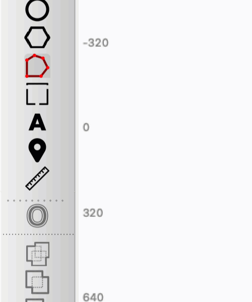

To enable Edit Nodes, click on the Edit Nodes icon in the Creation Toolbar or press Ctrl/Cmd + ` on your keyboard.

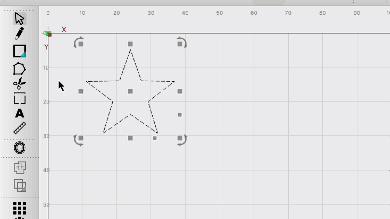

What is a valid object?
The Edit Nodes tool works on vector paths. Paths must be ungrouped. Text Objects, Primary Shapes, and Barcodes must be converted to a path before using Edit Nodes.

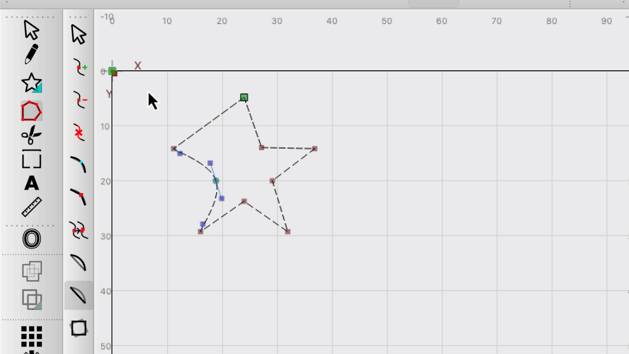

Edit Nodes Toolbar¶
When you enable the Edit Nodes tool, an additional toolbar will appear to the right of the Creation Toolbar.
Hover over any button in the Edit Nodes Toolbar to see a tooltip explaining the action it will perform.
Click on the desired node tool, then click on a valid node or line in your Workspace to perform that action.

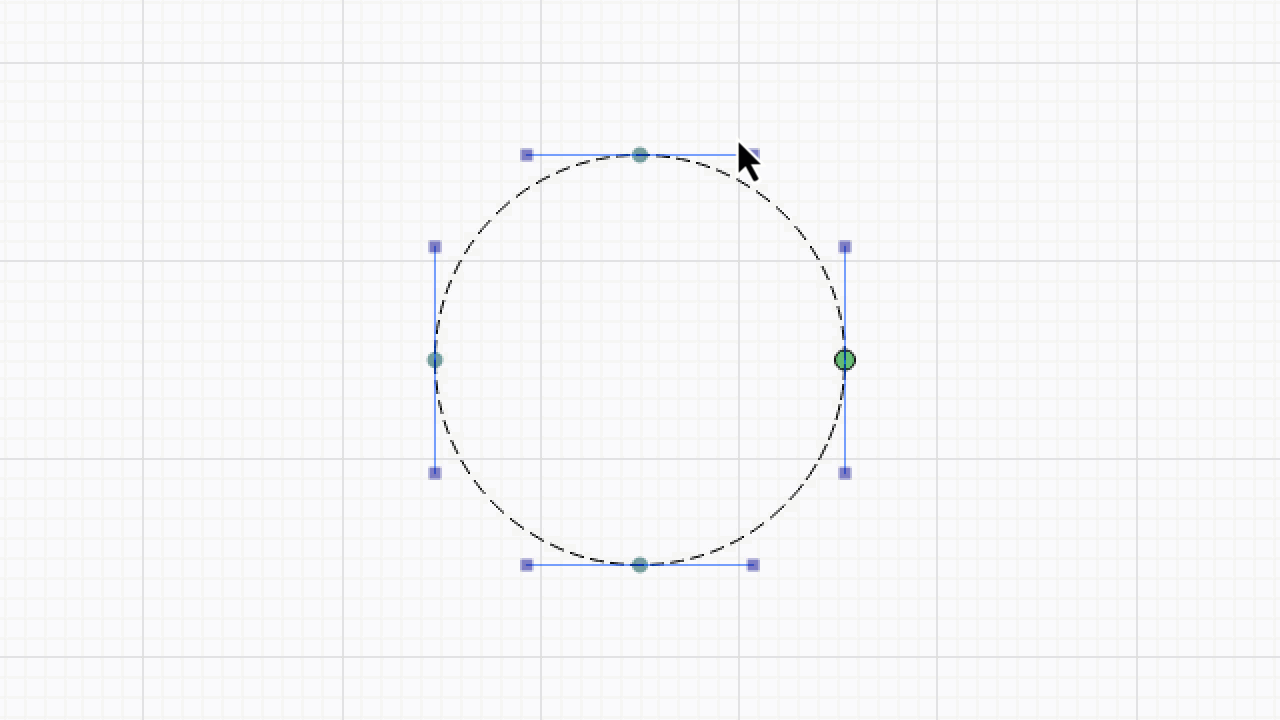

With the Select action enabled in the Edit Nodes Toolbar, you can select and adjust nodes and lines directly with your mouse.
Click and and drag on nodes, handles, or curves to move them.
Click any node or handle to select it, and then use the keyboard arrow keys and modifier keys to move it by the increments set in the Shape Move Increments fields in the Settings window.
With a node or handle already selected, hold Shift while clicking on another node or handle to add it your selection, then drag or use the arrow keys to move each selected node or handle in unison.
Click any straight line and drag to automatically turn it into a curve.
Drag disconnected nodes on top of one another to automatically join them, turning the lines on either side into a single shared path.

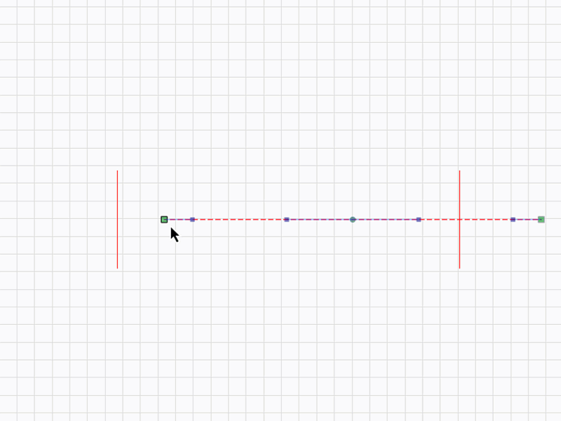

| Trim line | T | Cut line under mouse back to the next place it intersects with another line | Hover over curve or line and press key |
| Extend line | E | Extend line to nearest intersecting path | Hover over an open end point and press key |

You can only use Edit Nodes with paths. You can create paths with Draw Lines or the Trace Image tools. Otherwise you can Import vector objects into LightBurn from another source.
To use Edit Nodes with other, built-in vector objects, you must first use Convert to Path to turn them into standard paths. This requirement applies to:
- Text Objects
- Primary Shapes: Rectangles, Ellipses, and Polygons
- Barcodes
You cannot use Edit Nodes with Grouped objects. Ungroup them first.

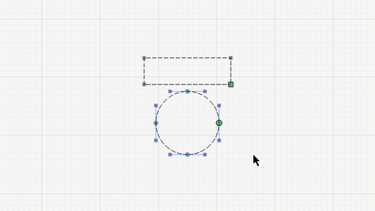

Snapping allows you to align your nodes or handles to specific points on existing objects.
Constrain Movement¶
Hold Shift while moving a node or handle to constrain movement to a 90° or 45° angle from its starting position, indicated by temporary guidelines in your Workspace.
If you select multiple nodes or handles at once, only the movement of the last-selected node or handle will be constrained, and the other nodes or handles will move along with it.
Trim and Extend Demo¶
There is also a separate tool, Trim Shapes that you can use to perform the Trim Line function.
