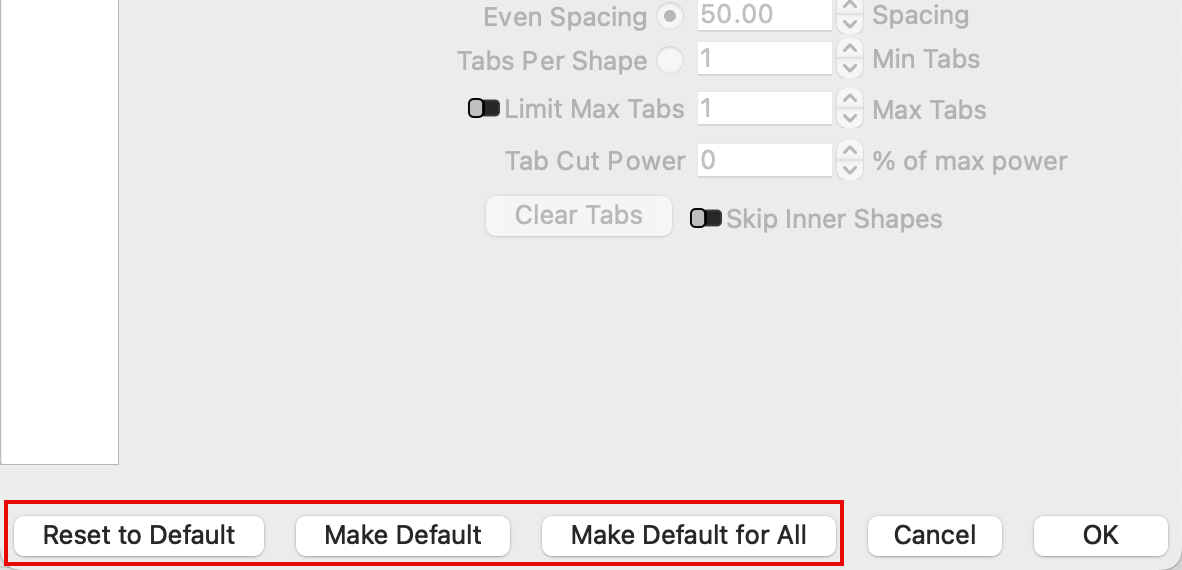

Setting Defaults
At the bottom of the Cut Settings Editor, there are three buttons to manage default layer settings.
Make Default: remember the settings for this palette color. Whatever your current settings are will become the default for this color. Default settings are saved separately for each device profile.
Reset to Default: reset the layer to the default settings. Hold Shift while clicking Reset to Default to reset to LightBurn's universal defaults.
Make Default for All: your current layer settings will become the default for all palette colors.
Make Default, Reset to Default, and Make Default for All buttons

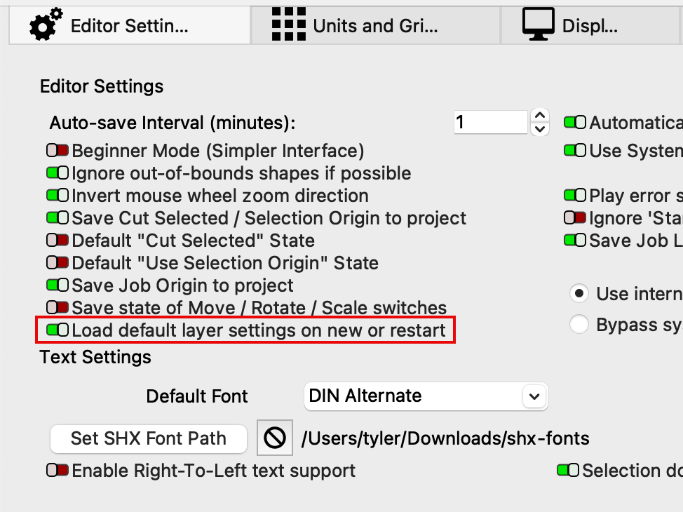

Load Default Layer Settings on New or Restart
To automatically load defaults instead, enable Load default layer settings on new or restart in the Editor Settings tab of the Settings window.
Load default layer settings on new or restart toggle
