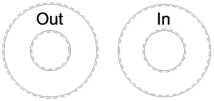

Kerf Offset
Closed Shapes Only
This feature only works with shapes that are closed. A shape is closed when it is a complete, continuous loop whose start and end points are the same. When a shape's start and end points are different, it is open.
See Open vs. Closed Shapes for more information.
Kerf refers to the thickness or width of a cut made by a cutting tool. The kerf of a laser is much narrower than that of a saw blade, but the extra material removed can interfere with close-fitting parts such as tabbed boxes or inlays.
Kerf Offset compensates for the extra material removed by offsetting the path of the laser to the outside of closed shapes (for positive values) or the inside (for negative values). This doesn't modify the underlying shape, so you can use your design on lasers with different kerfs by adjusting the Kerf Offset value.
The image below shows how Kerf Offset (dashed lines) relates to the original shape (solid lines).

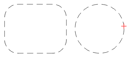

Perforation Mode
Enable Perforation Mode to specify a distance to Cut, followed by a distance to Skip.
As the laser traces the contours of shapes assigned to this layer, it will turn on over the specified Cut distance, and off over the specified Skip distance.
Perforation Mode is useful if you're trying to cut fold lines in card stock, stitch holes in leather, or make dashed lines.
Use Perforation Mode to reduce effective power output
This can also help when using delicate materials with a powerful laser. With very low cut and skip values, the beam is rapidly switched on and off, reducing the effective power output. Try starting with cut and skip values of 0.1 mm each, and adjust the ratio between cut and skip to tune it further.

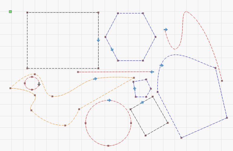

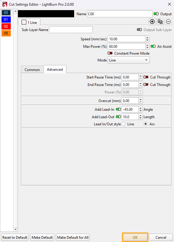

Lead-In / Lead-Out
Screenshot of multiple shapes with different Lead-In and Lead-Outs
Lead-In and Lead-Out are optional lines or curves added to the start or end of a cut. You can toggle each on or off individually, and specify their Angle, Length, and Style.
When cutting thick material, particularly if using Cut Through delays, or cutting metal, there is often a mark left at the start of the cut that is slightly thicker than the rest, and can leave an indent on an otherwise smooth edge. With this setting, you can add a small line to the start or end of a cut, so that mark happens off the cut line itself.
Screenshot of the Cut Settings Editor with the Lead-In/Out controls highlighted
The Angle value controls the placement of the lead line — a positive number tells LightBurn to put the lead line outside the shape, and a negative number means to put it inside. You can choose to make the lead a straight Line, or a short Arc.
The shape above on the left is using an Arc set to +45 degrees, so it starts outside the shape. The one on the right is a Line set to -20 degrees, so it appears inside the shape.

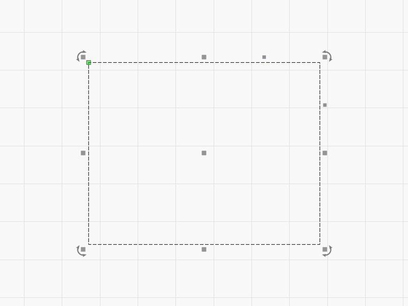

Set Lead-In/Out Start Points
  1. Click on the design element. Elements created with the Shape tool may not display any nodes or points along the selected elements, while path-based objects will display their nodes.
    Screenshot of a rectangle created with the Create Shapes tool that does not display any object nodes
    Rectangle Created With Create Shapes Tool | No Visible Nodes
  2. With the desired shape selected, click on the Edit Nodes Edit Nodes Icon tool in the Creation toolbar and either:
    Objects Created With Draw Shapes Tool
    No Visible Nodes
    Convert to Path
    Objects created with the Draw Shapes tool may need to be converted to a Path object in order to access the object nodes.
    Screenshot of rectagular object that has been converted to paths with visible nodes
    Visible and Editable Nodes
    a. With the object selected, click on the Edit menu and select Convert to Path, or on your keyboard press Ctrl/Cmd + Shift + C.
    Objects Created With Draw Lines Tool or Path-based Objects
    b. Continue to the next step.

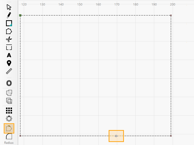

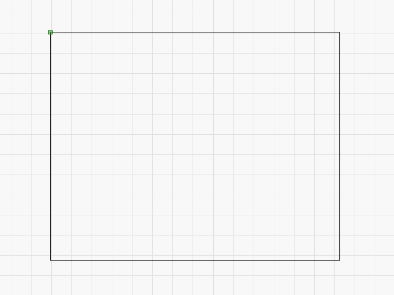

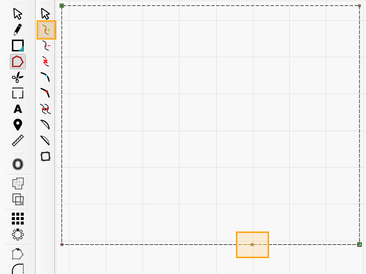

  3. Add an new node along the edge/face of the desired Lead-In/Out location. Curved shapes may be able to use existing nodes. Nodes that anchor acute angles (less than 90°) may not be compatible with internal Lead-In/Out locations.
    Screenshot of rectangle shape with extra node added to the bottom face
  4. Select the Set Start Point tool and click on the new node to set that node as the shape's Lead-In/Out location.
    Screenshot of rectangle shape with Start From added to a node at the bottom face

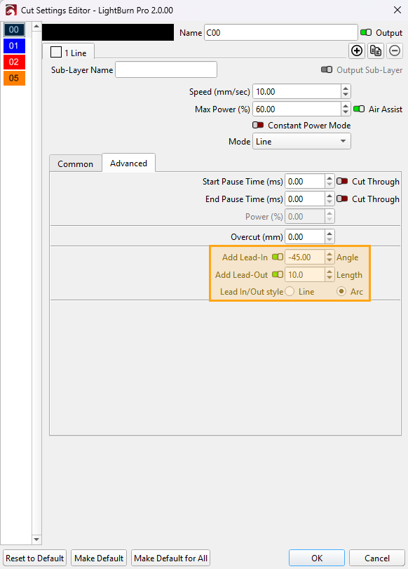

Activate Lead-In/Out at Start Points
Shapes with active Lead-In and Lead-Out points will share the same angle, length, and style settings on that layer. Assign shapes to different layers to use different Lead-In/Out settings in the same project.
  1. Open the Cut Settings Editor to activate the Lead-In/Out for that shape by double-clicking the assigned layer.
  2. In the Advanced Tab, activate the Lead-In and/or Lead-Out toggle and set your
    1. Desired angle, with positive angles for Lead-In/Outs external to that object, or negative angles for internal Lead-In/Outs. Lead-In/Outs assigned to lines will use positive values for Lead-In/Outs above the line and negative values for Lead-In/Outs below the line.
    2. Desired Lead-In/Out length
    3. Choose between Line or Arc-shaped Lead-In/Outs.
  3. Click on OK to save the Lead-In/Out settings for all shapes assigned to that layer. Use different layers for different Lead-In/Outs settings within the same project.
  4. Assign additional Lead-In/Out points to any remaining shapes as desired and repeat the process for each additional layer as needed.
  5. Click on the Preview Icon in the main toolbar to view the updated Lead-In/Outs for each assigned shape and start the job when ready through the Laser window.

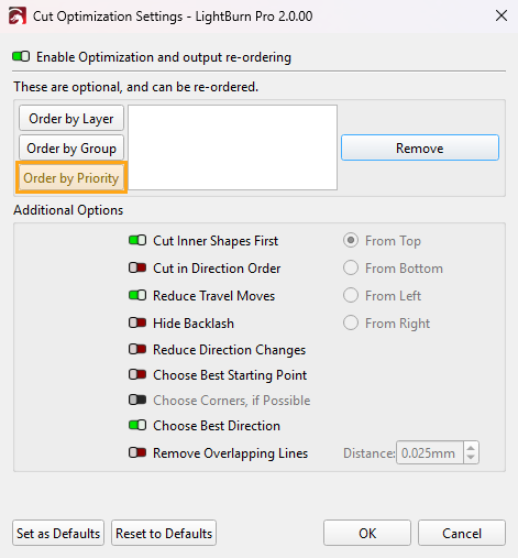

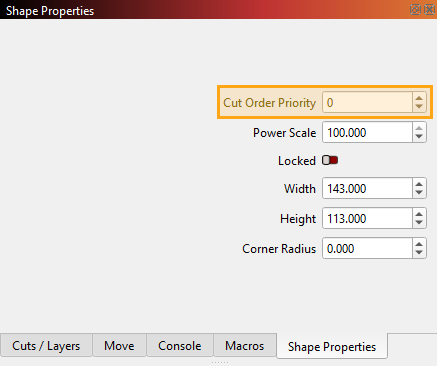

Reducing Travel Moves
Set Cut Order Priority

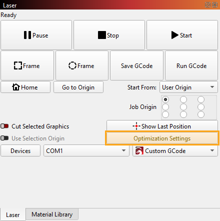

Reduce the travel moves your laser cutter makes by manually setting the Cut Order Priority of each shape to align the Set Start Point assigned to one shape to the Start Point location on another shape.

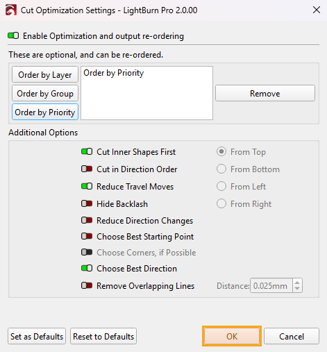

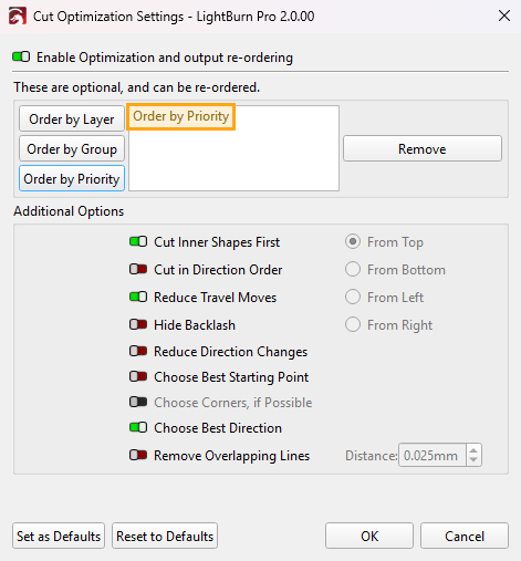

  1. Click on the Optimization Settings button in the Laser window to open the Cut Optimization Settings window.
    Screenshot of the Laser window with the Optimization Settings button highlighted
  2. Click on Order by Priority to use the Cut Order Priority assigned to each shape. Click on the Remove button as needed to remove existing entries or reorder by clicking and dragging on each Order by item.
    Screenshot of the Cut Optimization Settings window with Order by Priority highlighted
  3. Click OK to save the new job priority settings.
    Screenshot of the Cut Optimization Settings window with the OK button highlighted
  4. Open the Shape Properties window to assign the Cut Order Priority to each shape by selecting the Shape Properties tab found in the right-hand side of the main window by default and assign a priority to each shape starting from 0 (zero), onwards..
    Screenshot of the Shape Properties window with Cut Order Priority highlighted

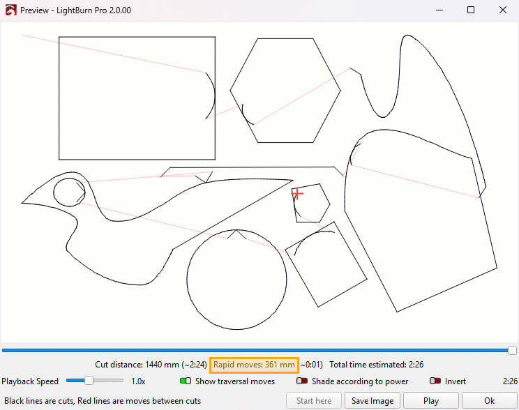

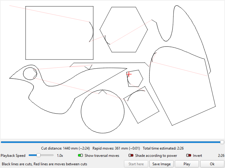

  5. Open the Preview window by selecting the Preview window found in main toolbar Preview window button in the main toolbar to view the updated cutting path and start the job once ready.
    GIF of the Preview window showing different travel path lengths
