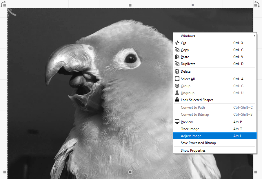

To open the Adjust Image tool, do any of the following:
  • Double click on the image.
  • Select any image, right-click, and choose Adjust Image from the context menu
  • Press Alt/Option+I.
Opening the Adjust Image window from the right-click context menu

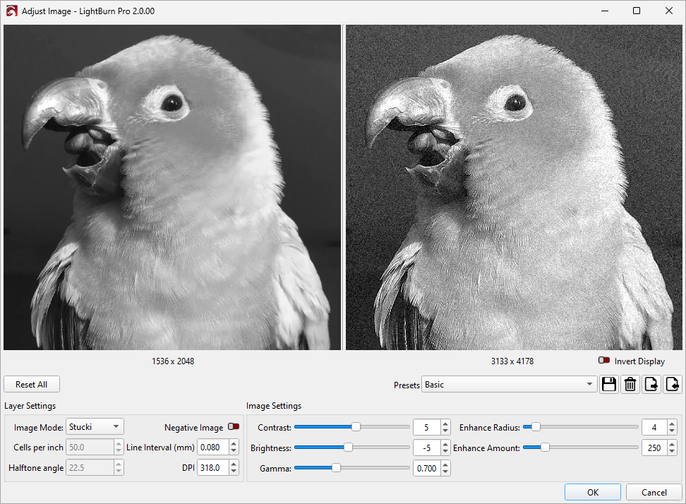

Adjust Image Window
The Adjust Image window
The original source image is displayed in the top left of the Adjust Image window. The result of your chosen settings is displayed as a processed image in the top right.
Making any adjustment allows you to see an immediate preview of the processed output, side-by-side against the source image.
Click and drag to pan around the image, and use the mouse scroll wheel (or two-finger dragging if you're using a trackpad) to Zoom In and Out. The source image and processed image are kept in sync while zooming and moving around.
Zoomed in on image in the Adjust Image window

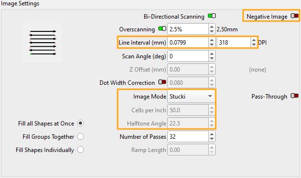

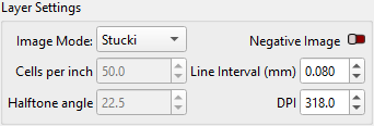

The Layer Settings group on the left contains settings that correspond to those found in the Cut Settings Editor, as highlighted below:
Corresponding settings in the Cut Settings Editor
For more information on these settings, see Cut Settings — Image Mode.
After adjusting settings, click OK to confirm and automatically apply changes to the Layer Settings for the image you are adjusting, or Cancel to discard the changes and leave the settings unchanged.
Note
These settings will affect any image on the same layer as the one you have selected.

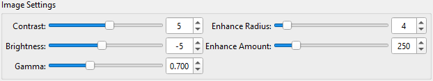

Image Settings
The Image Settings group on the right contains settings that correspond to those found in the Shape Properties Window. Adjust these settings by dragging the sliders or directly editing the numeric value of each property.
For more information on these settings, see Shape Properties — Image.
As with Layer Settings, click OK to confirm changes, or Cancel to discard them.

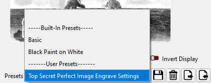

Presets
Presets dropdown menu
You can select Presets from the dropdown above Image Settings on the right side of the Adjust Image window.
Selecting a Preset automatically applies all the settings saved to it, overwriting your existing settings.
LightBurn provides two Built-In Presets, as well as the option to save your own frequently used image settings as User Presets.
  • Basic is a good starting point for your own engravings or for creating User Presets.
  • Black Paint on White is similar, but inverted for engraving light marks onto dark surfaces.

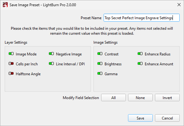

Save Image Preset
Save image preset window
The first button next to the Presets' dropdown allows you to save your current settings as an image Preset.
  1. Enter a name for your Preset in the Preset Name field near the top right of the window.
  2. You can choose which Layer and Image Settings are included in the Preset by toggling the switches next to each option.
  3. Click All to include all settings, None to exclude all settings, or Invert to include settings that are currently excluded, and exclude settings that are currently included.
    Excluded settings well be ignored when loading the Preset later.
  4. Click Save to store the selected settings as a Preset, or Cancel to exit without saving.
