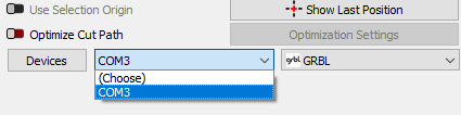

  3. Select the device in the Laser Window:
    • If you see Ready right below the title bar of the window, your laser is connected and ready to use.
    • If you see Busy and a green progress bar, your device is busy doing something. Many GRBL devices will home themselves when first connected, so you'll see the Busy message until homing is complete.
    • If you see Disconnected, your device is not connected. Make sure you have the correct serial port selected (the dropdown that says COM3 in the screenshot below). If your laser still isn't connecting, select (Choose) in the same dropdown and then reselect the serial port to reset the connection. If you're still unable to connect, see Troubleshooting: Connection Problems.
      Serial port dropdown

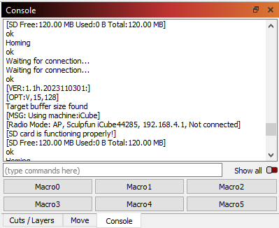

Immediately after you connect to your laser, you should see a series of messages in the console describing your laser's status.
You need information about your laser's network status, shown in the line starting with Radio Mode:
[Radio Mode: AP, Sculpfun iCube44285, 192.168.4.1, Not connected]
Your laser won't send the exact same message, but you should see something similar. Here's what each part of the message means, based on the example above:
Message Meaning Explanation
Radio Mode: AP Network type, typically either AP or STA If you see AP here, your laser is in Access Point mode, allowing you to connect directly to the laser over WiFi. If you haven't changed your laser's network settings, it will likely be in this mode. If you see STA here, your laser is in Station mode and will attempt to connect to an existing WiFi network. This is not universal, and some devices are configured differently.
Sculpfun iCube44285 WiFi network name, or SSID The name of the WiFi network the laser is either broadcasting (in Access Point mode) or attempting to connect to (in Station mode).
192.168.4.1 Laser's IP address This is the IP Address of the machine — it's how a computer knows where to find it on a network.
Not Connected Connection Status This tells you whether your laser is connected with any devices over the network connection.

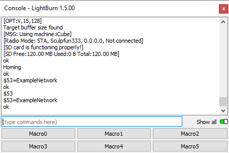

Network type $50 Typically STA
SSID $53 The name of the WiFi network to connect to
Password $54 The password to connect to the WiFi network
Each command given is entered into the text box at the bottom of the Console Window and followed by pressing Enter.
To check the value for any of these parameters before changing it, you can use the parameter without assigning a value. To change the value, add =YOURVALUE after the parameter. As an example, $53 will show the name of the WiFi network to connect to. $53=MyWifiNetwork will configure the laser to connect to a network called "MyWifiNetwork".

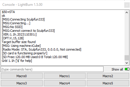

Set Network Type
Use $50=STA to set your laser to Station mode. This tells it to connect to an existing network.
Don't worry for now if you see [MSG: No SSID] or a similar message in the Console window. This is your laser's way of telling you that it doesn't know what network to connect to yet.

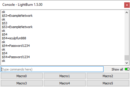

Set Password
Use $54=Password1234 to set the WiFi password, replacing "Password1234" with your actual password. The screenshot above also shows how to use $54 to check the saved password.
Make sure you type in your password accurately, including capitalization. This should be the password to connect to WiFi, not the login info for your computer or any accounts you may have.

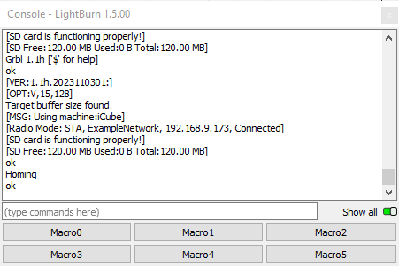

Check Connection
After configuring network settings, you may need to restart your laser to get it to connect. The Radio Mode status message now shows updated network settings and ends with Connected:
[Radio Mode: STA, ExampleNetwork, 192.168.9.173, Connected]
Make sure you write down the IP Address (192.168.9.173 in the example above) for easy access in Part 4.
