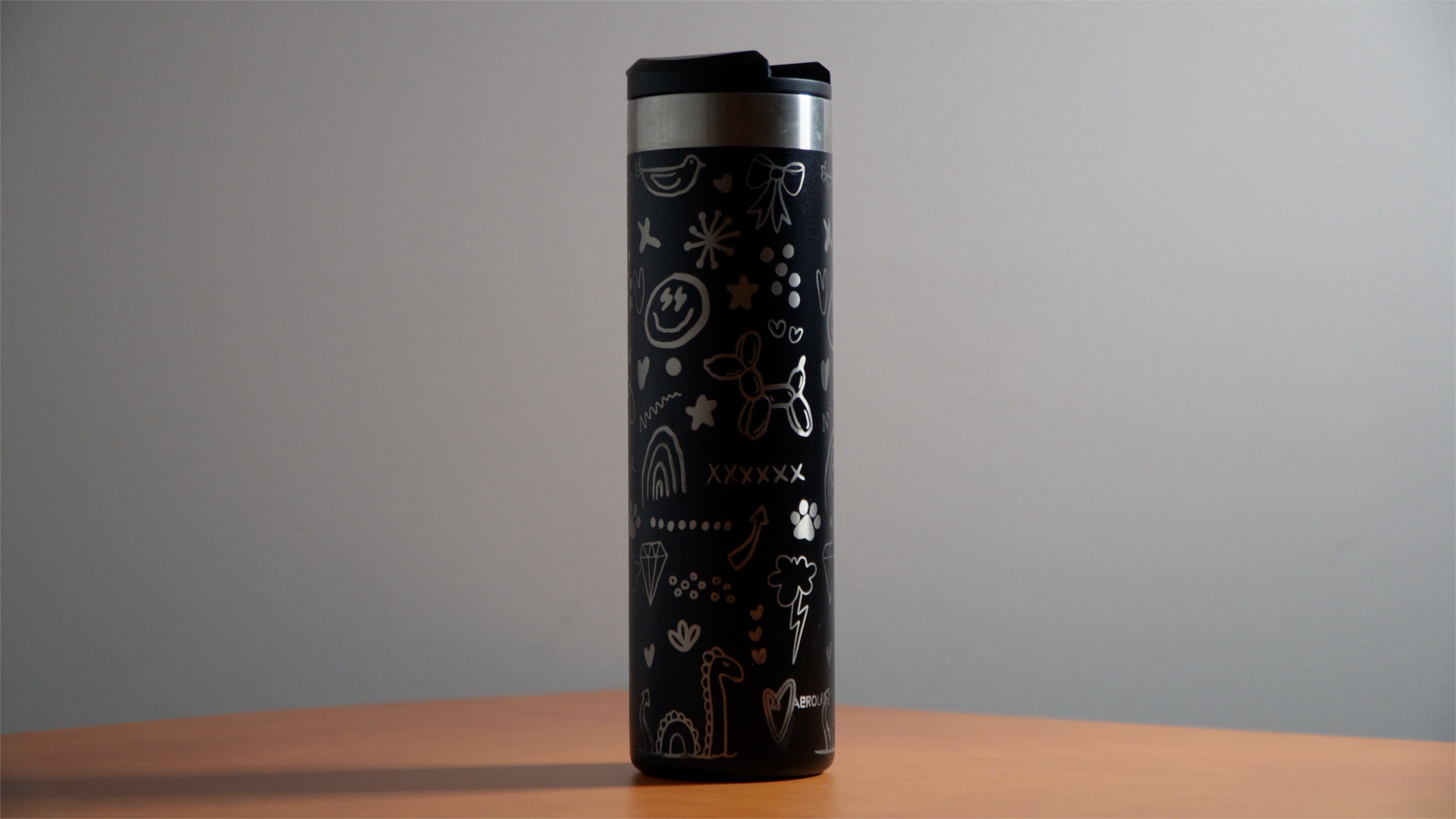

Full wraps utilize a design that goes all the way around the cup, so you can’t tell where it begins and ends. They can be simple or complex, tightly grouped or loose, but they will all require similar steps to ensure they come out the way you expect.
Learn how to start tackling this popular design style and make it yours.

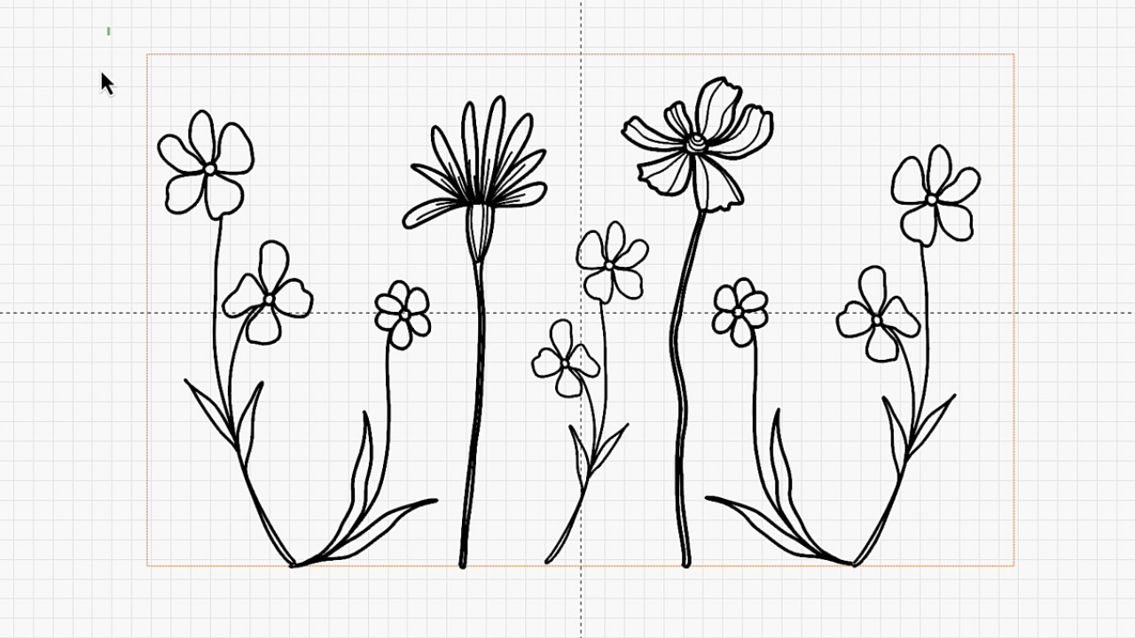

  • Things to think about when selecting a full wrap design, or creating your own

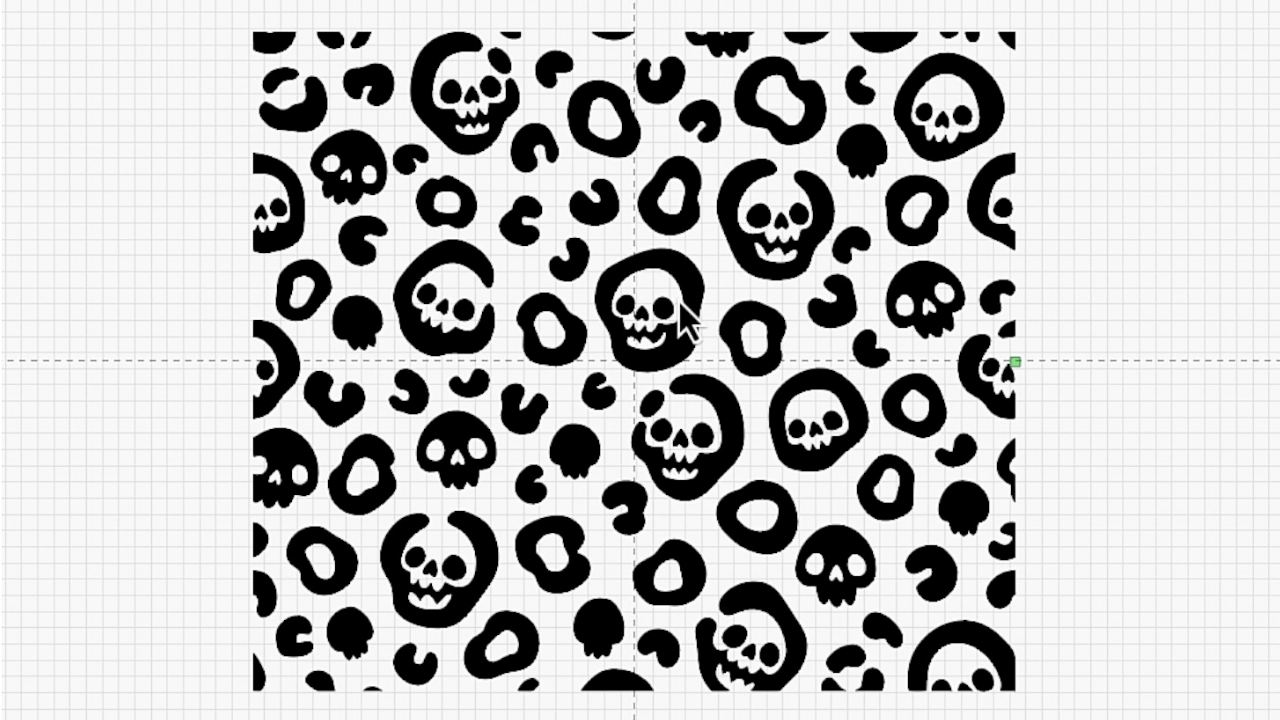

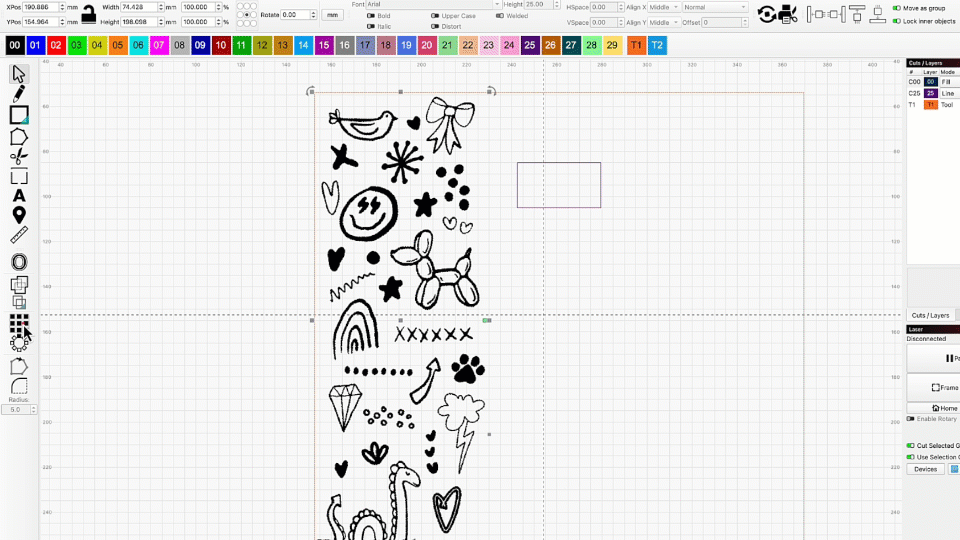

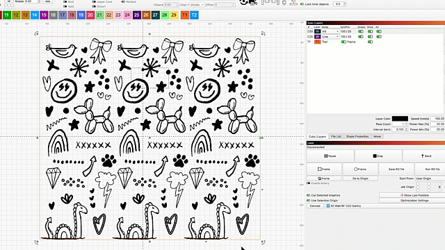

  • How to create a template and full wrap design using the following tools:
    • Tool Layers, to make a template of your tumbler in your LightBurn Workspace
    • Grid Array, to duplicate a design until it fits the circumference of your tumbler

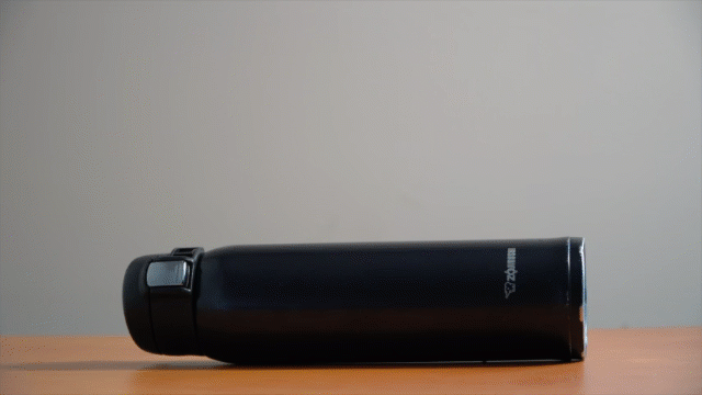

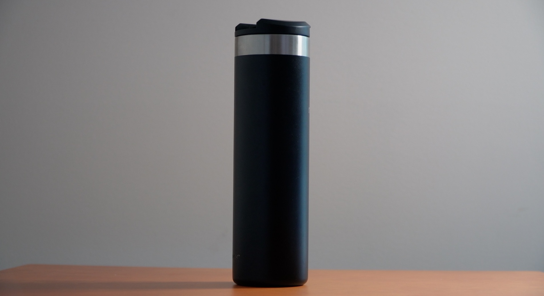

Choosing a Tumbler

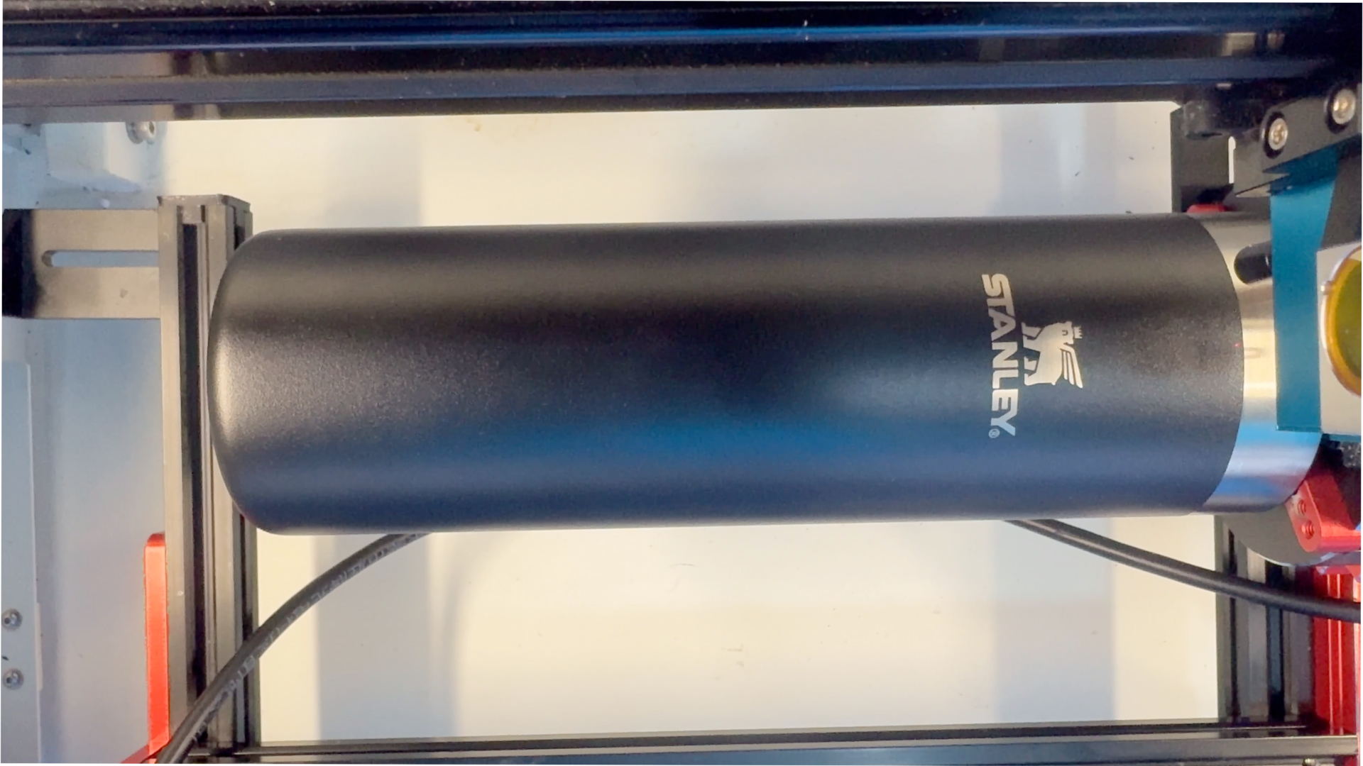

Your choice of tumbler affects the difficulty level of completing a full wrap engraving. We recommend starting with the easiest — a straight-sided tumbler — and that's what we'll use for the rest of this guide. Below we've outlined some considerations for more challenging tumblers as well.

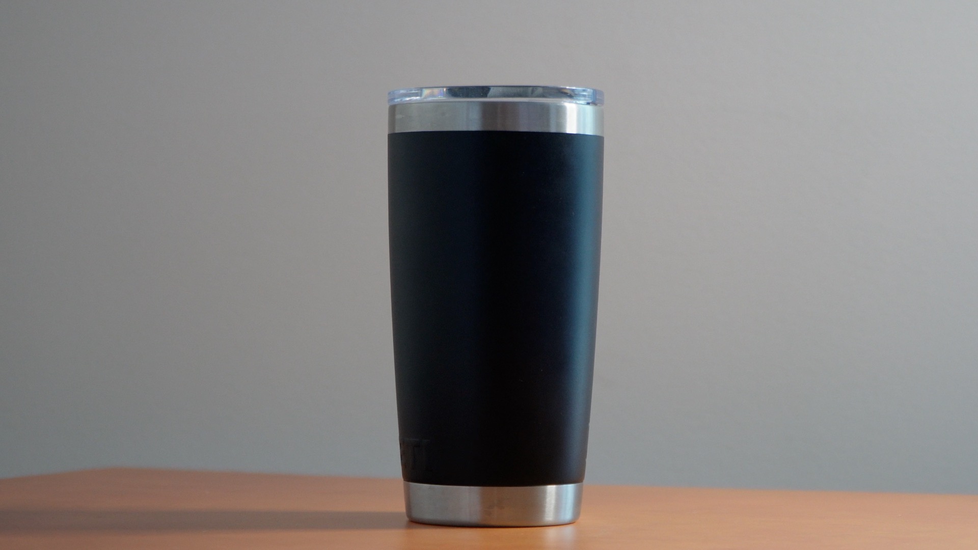

Easy
Straight-sided tumblers are the easiest to work with, and what we recommend for beginners. With a straight-sided tumbler, you don't have to deal with multiple focus levels, work around any tapers, or compensate for distortions.
A straight-sided tumbler
Intermediate
Tapered tumblers are somewhat more difficult. You’ll need to ensure your laser is in focus at multiple distances from the cup's surface, and you may see some distortion of your graphics at the taper.
Tip
You can compensate for distortion caused by tapers using our Taper Warp tool.
A tapered tumbler
Hard

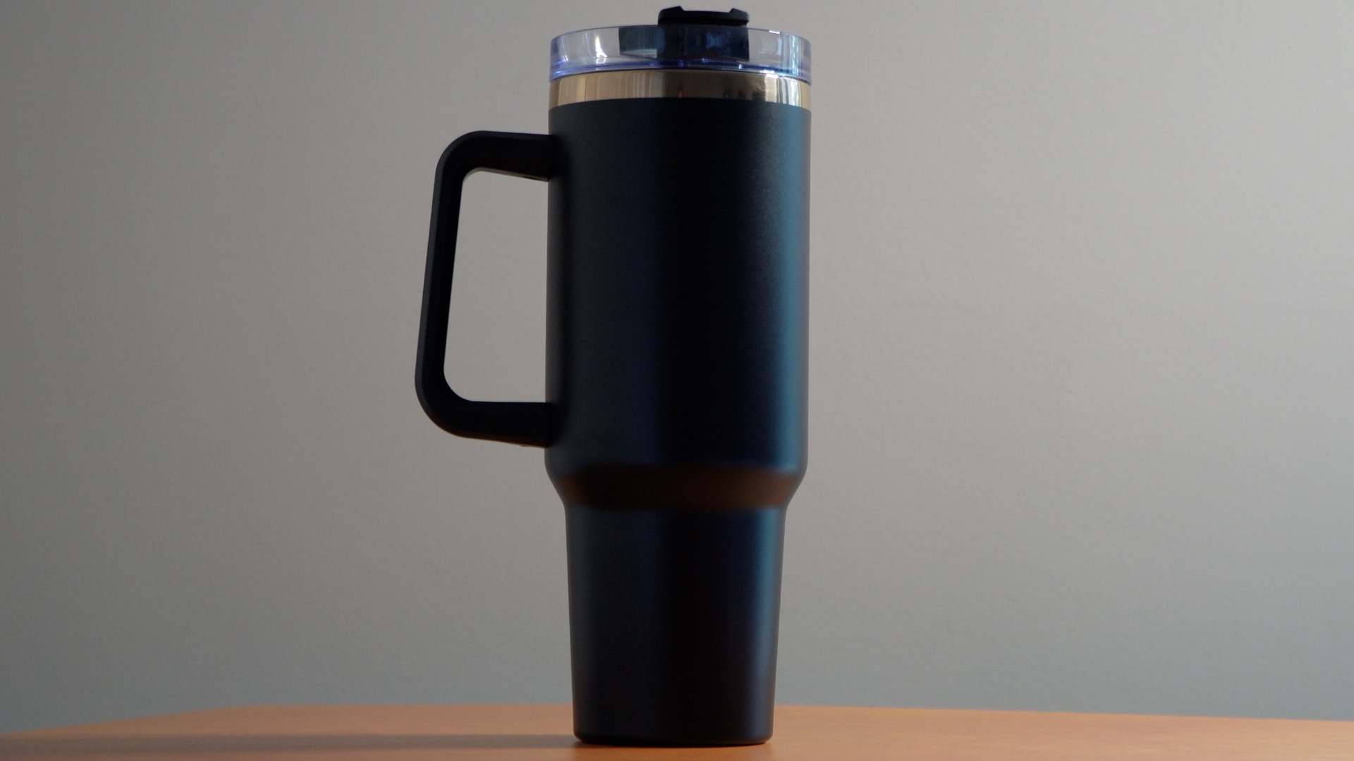

Tumblers with step downs are the most difficult to work with. The dramatic differences in circumference make it more challenging to get all your measurements and focus right, in addition to distorting your designs.
A tumbler with a step down

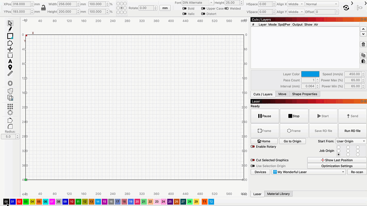

Configuring the Rotary

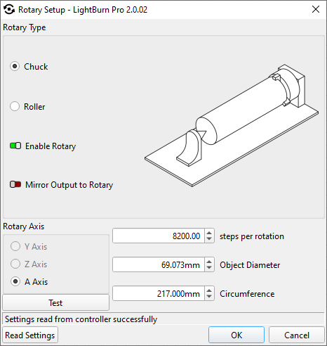

Before running your first rotary job you’ll need to open the Rotary Setup window to establish some important values, and enable Rotary Mode.
  1. Go to Laser ToolsRotary Setup to open the Rotary Setup window.
    Rotary Setup window for a Chuck style rotary and a DSP laser
  2. In the steps per rotation field (mm per rotation if you're using a GCode-based device), enter the number of motor steps required to turn your rotary 360°.
    • In most cases, this value will be provided by the manufacturer of your rotary or machine. If you can't find it in their public resources, we recommend reaching out to them for assistance.
    • If you're still not sure, you can use the Test button to find the correct value. When it's correct, pressing the Test button will cause your rotary to make one complete rotation, then return to the start.
    • Once this value is set correctly, you never need to change it again.
    • See Rotary Mode for more information on configuring a rotary with your model of laser.
    • If you're using a Galvo laser, you'll see additional options to control Split Size and Overlap. See Rotary Mode (Galvo) — Split Setup for information on these settings.

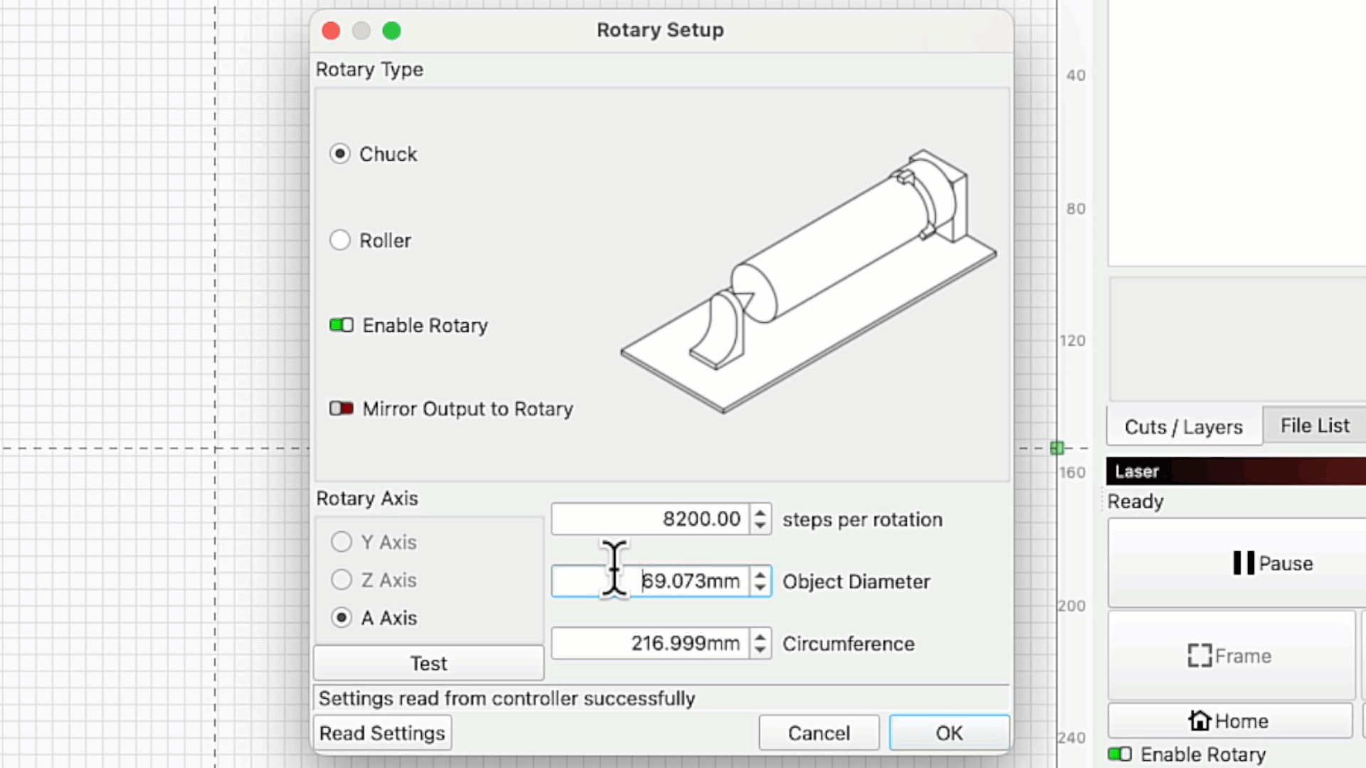

  3. If you’re working with a Chuck style rotary, you will also need to enter the Circumference of the object you’re placing in your rotary, to ensure your laser's output is scaled properly.
    Note for Roller style rotaries
    For Roller style rotaries, Circumference does not affect output scaling, but you'll still need to know this value when you set up your full wrap design.
    You will also need to accurately enter the diameter of your rollers. This value is usually provided by your rotary's manufacturer, but you can measure it with high-precision calipers if not.
    1. Use seamstress' tape to wrap around the tumbler and measure its circumference, then enter it in the Rotary Setup window.
      Measuring tumbler circumference with seamstress tape
      Entering tumbler circumference
    2. If you're using calipers, measure the tumbler's diameter, and enter it in the Object Diameter field. LightBurn will automatically calculate the Circumference based on the diameter.
  4. Make sure the Enable Rotary switch is toggled on, so LightBurn will tell your laser to use its rotary axis, and scale output appropriately.

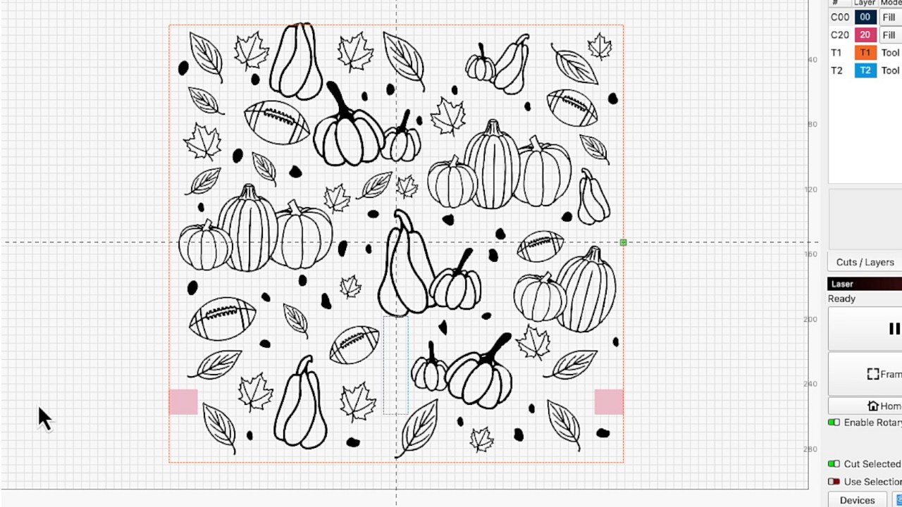

Before laying out our design, we'll create a template to represent the engraveable area of our tumbler.
  1. Measure your tumbler. In addition to the circumference measurement you took earlier (or derived from the diameter), you'll need to know the length of the cup.

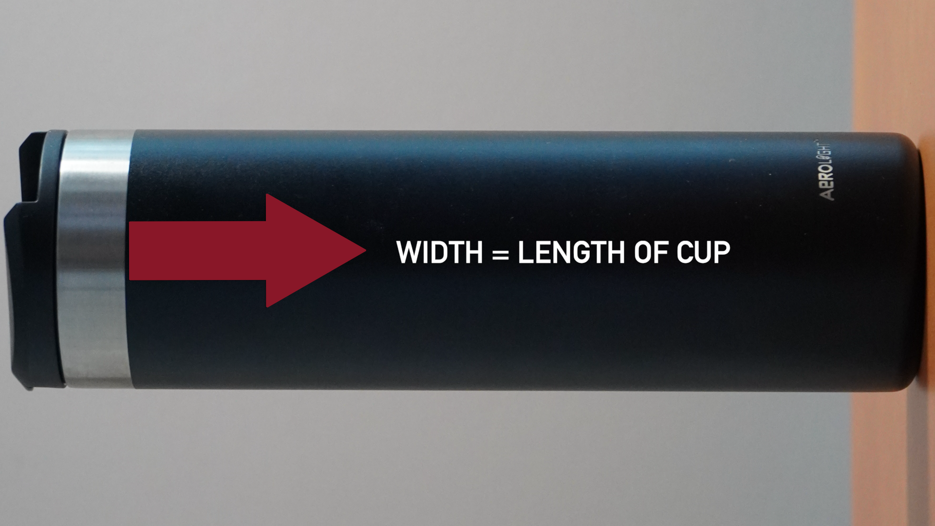

  3. In the Numeric Edits Toolbar, set one of the rectangle's sides to match the cup's length, and the other to match the cup's circumference.
    Quick Reference: Numeric Edits Toolbar

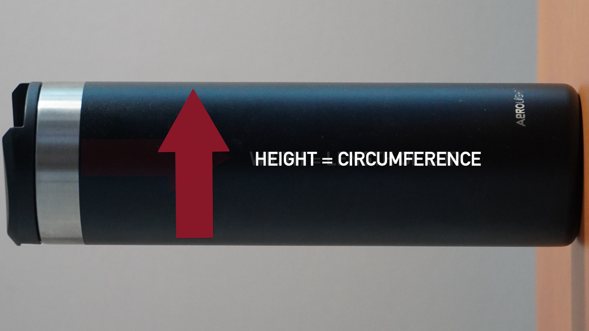

    Note for Galvo Users
    If you're using a Galvo laser, the correct orientation depends on whether you have set your rotary to the X or Y axis. See Rotary Mode (Galvo) — Rotary Axis for more information.
    You can orient the rectangle however you'd like while you design, but remember which side is which, and, if necessary, take care to rotate it 90 degrees later, before sending the job to your laser. In the final orientation, the rectangle’s Height should match the cup’s circumference, and its Width should match the cup’s length.
    Tumbler circumference = Workspace height
    Tumbler length = Workspace width

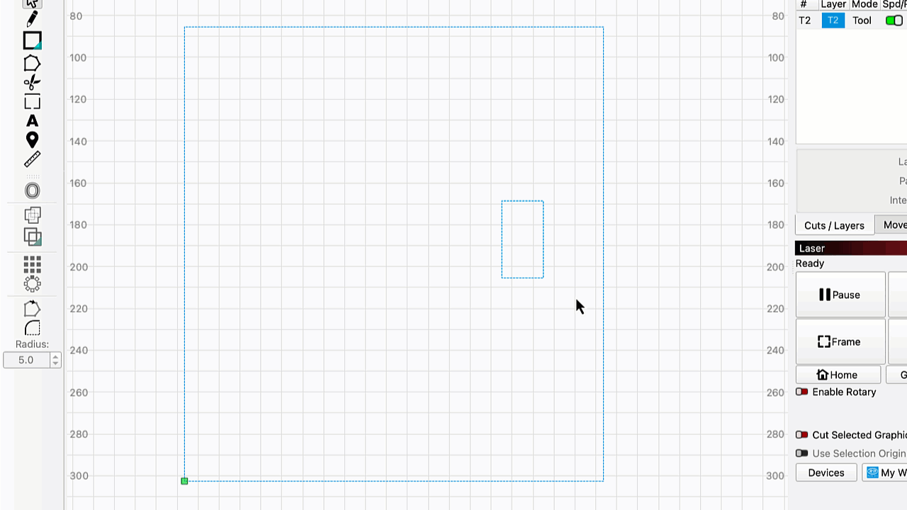

  4. Set the rectangle to a Tool Layer. Tool Layers are special layers that are never sent to your laser, so this rectangle will now serve as a guideline only, with no risk of accidentally engraving it onto your tumbler.
    Creating a Rrctangle, adjusting its dimensions, and setting it to a Tool Layer

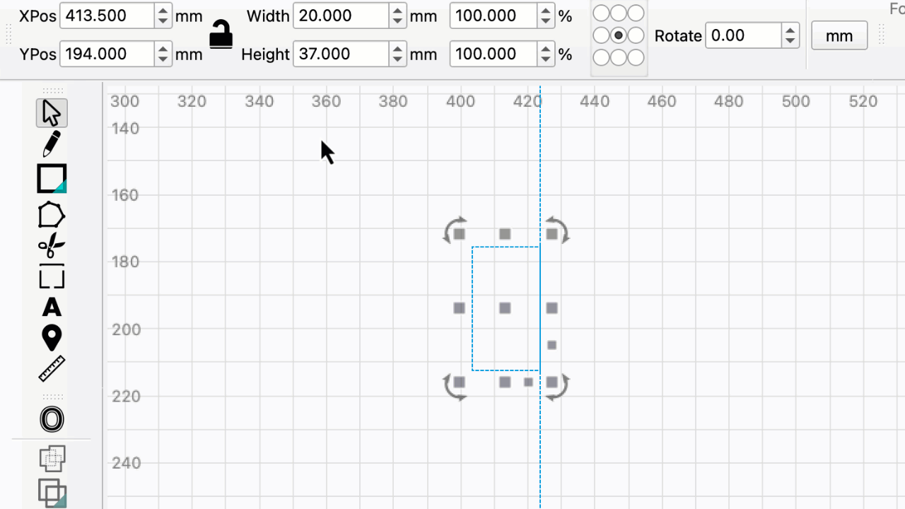

  5. If your tumbler has a logo you'd like to work your design around, get a rough measurement of its dimensions, and its distance from the top of your cup.
    Tip
    If you're using a CO2 laser and your tumbler has a logo that you don't want to work your design around, you can cover it with aluminum tape instead. CO2 lasers can't penetrate aluminum.

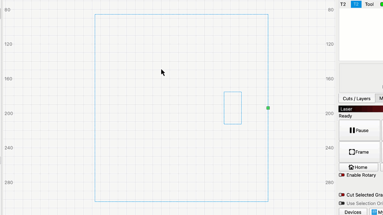

  6. Create another rectangle, also set to a Tool Layer, and set its dimensions to match the measurement of the logo — making sure that the Height and Width values are entered correctly for your template's current orientation.
  7. With the Selection tool active, hover over the side of the logo outline that is oriented parallel to the side of the template representing the cup's circumference, until you see the midpoint Snapping icon appear.
    Quick Reference: Snapping
    • Snapping demo
    • LightBurn's automatic Snapping tools help align objects to other shapes in your Workspace, or to the Workspace grid itself — when you move objects close to a valid location, they will snap to that point.
      As you hover your cursor over an object, the icon will change to indicate when it is over a node, line, midpoint, center, or intersection. Use these Snapping points when selecting, moving, or creating objects to ensure exact alignment.
      More Info → Snapping
    • Object Snapping Points
      Snapping Point Icon Description
      Node The cursor is over any node in a vector graphic, or the corner of an image.
      Midpoint The cursor is over the exact halfway point between two nodes.
      Center The cursor is over the center point of an object.
      Intersection The cursor is over the intersection of two lines.
      Line The cursor is over a line, but not a node, midpoint, or intersection on that line.
  8. Click and drag the logo outline from that point, until you see the midpoint snapping icon appear again on the side of the larger template, then release to place the outline there.
    Snapping logo outline box to template side
  9. In the Numeric Edits Toolbar, adjust the X Position or Y Position of the outline to move it as far in from the side of the template as the logo is from the end of the cup.

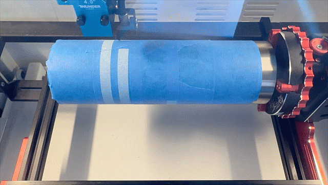

Before moving forward, it's a good idea to test the template to make sure it is sized correctly, and the logo outline is positioned appropriately.
  1. Create a thin rectangle that spans the length of your template in the dimension matching your cup's circumference.
    You can use Snapping to make sure the rectangle starts at exactly one side and ends at exactly the other.
    Creating a thing rectangle using Snapping
  2. Set the layer the thin rectangle is on to appropriate Speed and Power settings to lightly etch the surface of the painter's tape, without going through.
    The precise settings for that will depend on your laser, but we recommend starting with a very low power to begin with. If it's too low, you can always increase and test again. But if it's too high, you'll burn through the painter's tape and might waste a tumbler.

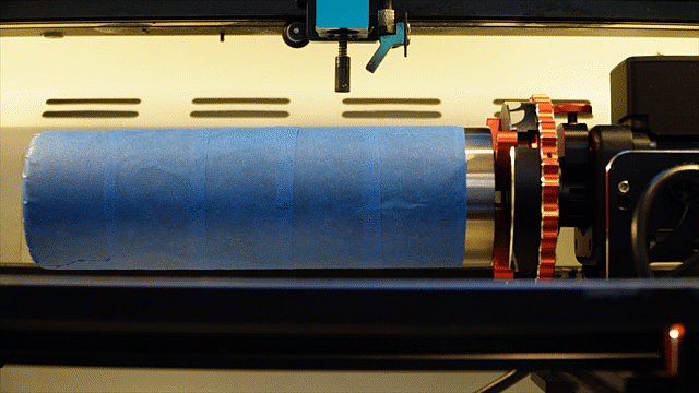

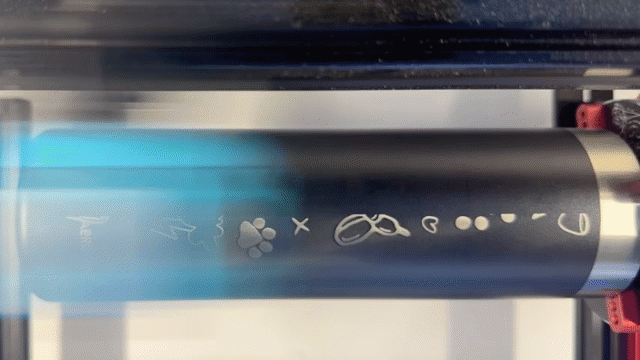

  3. Completely wrap your tumbler with painter's tape, and place it on your rotary.
  4. Make sure your laser is connected to LightBurn, and Rotary Mode is enabled.

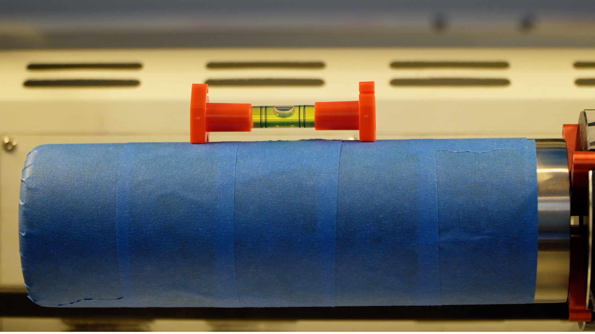

  5. To get a good engraving on your tumbler, it will need to be perfectly level on the rotary. Place the tumbler on the rotary, then a level on top of the tumbler, and adjust the angle of the rotary until it's precisely level.
    Level on top of tumbler placed in rotary
  6. Lasers need to be focused correctly to achieve good results — the space between the laser and the surface of your material must be set to precise distance. Focus the laser according to your laser's user guide — we used a DSP laser, with auto-focus capability.

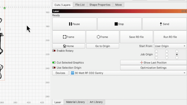

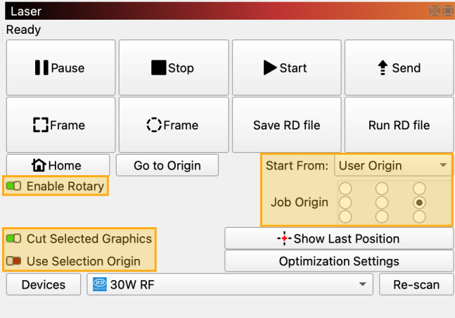

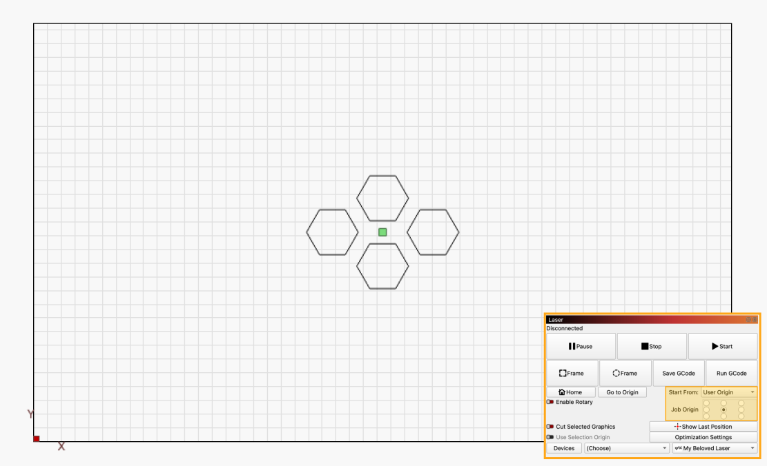

  7. In the Laser Window, set the Start From mode to User Origin, and the Job Origin to either the center-right or center-left.
    With these options selected, the rectangle will be engraved to the left (for a center-right Job Origin) or the right (for center-left) of your custom origin, at the same distance from the edge of the cup as the edge of the template.
    Learn More: User Origin

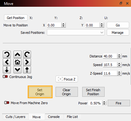

    User Origin works almost exactly the same as Current Position, except that the starting location is programmable. To set a User Origin, you must first jog your laser to the location you want your job to start from, then set the origin.
    Some lasers with digital displays, such as those with Ruida controllers, have an Origin button which you press to set the origin. GCode-based systems use the Set Origin button in the Move Window in LightBurn to do the same thing.
    For supported systems, use Clear Origin to remove and reset a custom-set origin.
    Set and Clear Origin
    After setting the origin, you are free to jog your laser around its work area. With User Origin selected as the Start From mode, the laser will always move back to start the project in a position relative to the programmed location.
    You can also use the Go to Origin button in the Laser Window to command your laser to travel back to the origin you've set.
    As with Current Position, the Job Origin setting determines how output will be oriented relative to the user-defined origin.
    Here, the Job Origin is set to the lower left:
    User Origin Bottom Left
    Notice the location of green Job Origin indicator. This represents whatever location you've set for your custom origin. When you start the job, the laser is going to move from wherever it is currently located and cut the four hexagons up and to the right from the programmed origin location.

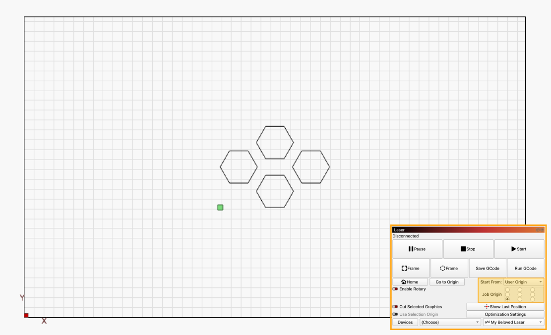

    Why is the Job Origin offset from the graphics?
    When using Current Position or User Origin, the green Job Origin indicator is always located on a corner, side, or at the center of an imaginary box — the smallest possible rectangle that can fully contain all graphics you're sending to the laser.
    Below, we've added a Tool Layer to represent that imaginary box. Notice how the Job Origin moves around the box as we change the location in the 9-Dot selector.
    Changing Job Origin
    Now imagine that you want to etch this four hexagon pattern onto a coaster or a phone case. Lining it up from the lower left is not easy. If you change the Job Origin setting to center, you get this instead:
    User Origin Center Job Origin
    The job will be centered around the custom origin you set. If you position the laser head directly over the center of the item you want to etch before setting the User Origin, the output will be centered on the item.

  9. Press the Set Origin button in the Move Window, or the Origin button on your machine's display, if your laser has a Ruida controller.
    Where's the Set Origin button?
    The Set Origin button is presented in the Move Window, which is docked behind the Cuts / Layers Window by default. If you don't see it, go to WindowMove to re-enable.
    This button is only available if you are using a GCode-based laser. If you're not sure what kind of laser you have, see Identifying Your Laser.
  10. Press the Start button in the Laser Window to run the job.
    Running the test
  11. If your rotary set up is correctly, and you've measured your object accurately, the starts and ends of the thin rectangle engraving should line up perfectly.
    If they come up short, you need to increase the Height of the template. If they overlap, you need to decrease it. Then run the test again. This may require some trial and error, but once you've got your template sized correctly for a particular tumbler, you can Save and reuse it in the future.

Hard
  • Graphics that are very tightly spaced, with little to no margin for error.
  • Lots of straight lines or geometric shapes that will show clear distortions.
  • Seamless patterns — these not only leave zero room for error, they are also challenging to size correctly to any given object.
Hard design example

Now we’re ready to place our elements into our design. First we'll place our graphics, and then we'll use Grid Array to make a repeating pattern from them.
  1. You can use any graphics you like for this step — Import SVG artwork, or create shapes, text, or custom paths using LightBurn's Creation Tools.
    We chose to work with imported artwork.
  2. We'll keep all of these shapes assigned to the same Fill Mode layer, since we're going to engrave them all with the same Speed, Power, and Interval settings.
    What cutting/engraving settings should I use?
    The exact settings required to achieve good engravings, or to cut through material, are highly dependent on your type of laser.
    While we can provide some rough guidelines, the best source for specific recommendations is usually your laser's manufacturer.
    Always pay attention to units of distance and time when entering Speed settings
    When entering Speed values recommended by your laser's manufacturer or other LightBurn users, make sure to use the same units of distance and time as those from the recommendation, or to convert the values to your preferred units.
    A given number of millimeters per second is much faster than that same number in millimeters per minute. Mixing up units can lead to reduction in power output due to unexpectedly high speeds, or excessive power output — and even fire — due to unexpectedly slow speeds.
    Change your Control Units in the Dimensions / Units tab of the Device Settings window. LightBurn automatically converts any existing values when you switch between units.
    The two primary settings controlling the depth of a cut or the darkness of an engraving are power and speed.
    Power controls the laser's intensity. Higher powers allow you to cut deeper or make darker marks for engravings, but at the cost of potentially charring or melting edges, producing excessive smoke, and making a wider kerf.
    Speed controls how fast the laser moves. Lower speeds will deliver more power and heat to the material, as the laser takes longer to pass over any one point. Higher speeds can complete a job faster, but will require higher power. High speeds can also exacerbate or make any existing mechanical issues more apparent.
    Info
    For a deeper dive into the relationship between these settings, see Speed vs. Power.
    There's another crucial setting for layers set to Fill ModeLine Interval. The Interval setting determines the distance between the parallel lines your laser scans as it engraves your graphics. Smaller Line Intervals lead to lines that are closer together. As a rule, you want the scan lines to be as close together as possible without overlapping (which can lead to overburning).
    While we've noted that manufacturer recommendations are the best place to begin looking for cut settings, LightBurn also has a built-in Material Test that you can use to test different combinations of Speed, Power, Passes, Line Interval, and other settings. The Material Test works by automatically setting up a grid of boxes that will be cut or engraved at a range of different settings.
    See Material Test for more information.
  3. Arrange the artwork until you have a grouping you're happy with.
  4. Next select all the graphics and open Grid Array. Increase the number of rows and columns until the pattern fits across the Width and Height of your template.
    Quick Reference: Grid Array
    • Hero Image
    • The Grid Array tool creates copies of an object (or objects) in regularly spaced rows and columns, and includes options to adjust spacing, mirror the shapes, randomize orientation, and more.
      More Info → Grid Array
    Using the Grid Array tool to pattern a design
  5. Delete any graphics that are overlapping with the logo outline box, and rearrange anything nearby, if necessary to make the graphics surrounding the box look more organic.
  6. Once you're happy with the placement of your design, Select everything, then Group it and Duplicate it.
    Quick Reference: Grouping
    • Hero Image
    • The Group tool combines collections of objects into single units, and the Ungroup tool splits Groups back into the individual objects that make them up.
      Normally, all objects are independent of one another, and can be manipulated individually. But it's sometimes helpful to treat a collection of things as a single unit, to make sure they keep their relative position and size when you're moving them around.
      More Info → Grouping
    • Location
      Arrange Toolbar
      ArrangeGroup/Ungroup
      Right-clickGroup/Ungroup
    • Keyboard Shortcuts
      Grouping
      Windows: Ctrl+G
      Mac: Cmd+G
      Ungrouping
      Windows: Ctrl+U
      Mac: Cmd+U
  7. We're going to Snap the Grouped copy to an edge of the original, so we can get a sense of how the design will look when it's wrapped around our tumbler, and make sure there is no obvious seam.
    If we're not happy with how it looks, we can make some adjustments until we are.
    Duplicating the entire design and checking the wrap
  8. Make sure to Delete the copy once you're done making adjustments.

  1. Make sure your laser is connected to LightBurn, and Rotary Mode is enabled.
    Note
    If you aren't working around a logo on your tumbler, you can skip the rest of this section, and Frame your entire design before moving on to engraving it.
  2. In the Laser Window, enable Cut Selected Graphics, but make sure Use Selection Origin is disabled.
    • Using Cut Selected Graphics will tell LightBurn to only send objects currently in your Selection to the laser when you Frame or Start the job. For this test, we only want to Frame one thing — the outline that represents the tumbler's logo.
    • Keeping Use Selection Origin disabled will mean LightBurn still includes everything that isn't being sent when calculating Job Origin. We want to make sure we include the entire tumbler template when we calculate origin, rather than just calculating it based off the logo outline.
    Learn More: Cut Selected Graphics and Use Selection Origin
    By default, LightBurn outputs all graphics in your Workspace when you Preview, Frame, Start, Send, or save a project in a machine-specific file format. This works well if you have one design in each project, but is less ideal when storing multiple designs within the same file.
    In order to output only specific design elements, you can enable Cut Selected Graphics instead.
    Cut Selected Graphics Preview demo
    Use Selection Origin allows you to choose whether to orient output relative to the entire project's Origin, or just the Origin of the graphics in your selection.
    The Job Origin is indicated on your design as a green square. You'll see its position move as you toggle Cut Selected Graphics and Use Selection Origin on and off in different combinations.
    Use Selection Origin demo
    See Cut Selected Graphics / Use Selection Origin for more information.
  3. Select the logo outline, and the logo outline only.
  4. As before, set the Start From mode to User Origin, and the Job Origin to either the center-right or center-left — the same side of your cup that is closest to the logo.
    Changing Job Origin
    Settings in the Laser Window
  5. Jog the laser head so that it is to the right or left of the logo, and still roughly centered between its top and bottom.
    Laser in Position
  6. If you're using a GCode-based laser, press the Set Origin button in the Move Window. If you're using a DSP laser, use the Origin button on your laser's controller.
  7. Press the Frame button in the Laser Window — you should see the laser trace a path around the logo on the cup. If it's off by a bit, jog the laser, update the User Origin, and try again, until you get it as close as possible, and are sure your engraving won't overlap with the logo.

Make sure your tumbler is still level on your rotary and your laser is still in focus. Refer back to Testing the Template Steps 5-6 if you're not sure.
This is the big moment — we're going to engrave our tumbler.
  1. Ok, not quite yet. If you're nervous, you can keep the painter's tape from the earlier test on, and adjust your settings to lightly etch it, as a final step to verify your design, rotary setup, and alignment.
  2. If you're ready, now it's really the big moment. Press Start in the Laser Window. If you're using a DSP laser, you can also choose to Send the project to your laser, and start it from the controller.
    Engraving the tumbler
  3. How does it look? Prior to removing it from the rotary, make sure the engraving made it all the way through the powder coating. With a Chuck style rotary, you can run a second pass, if needed, to clean up any spots before you take it off.
  4. After we remove the tumbler from the rotary, we'll give it quick spray with a cleaning product and a scrub with a magic eraser to clean up remaining powder coat residue, and we’ve got a great looking tumbler.
  5. We did it! Look at that perfect wrap!
    Completed tumbler
