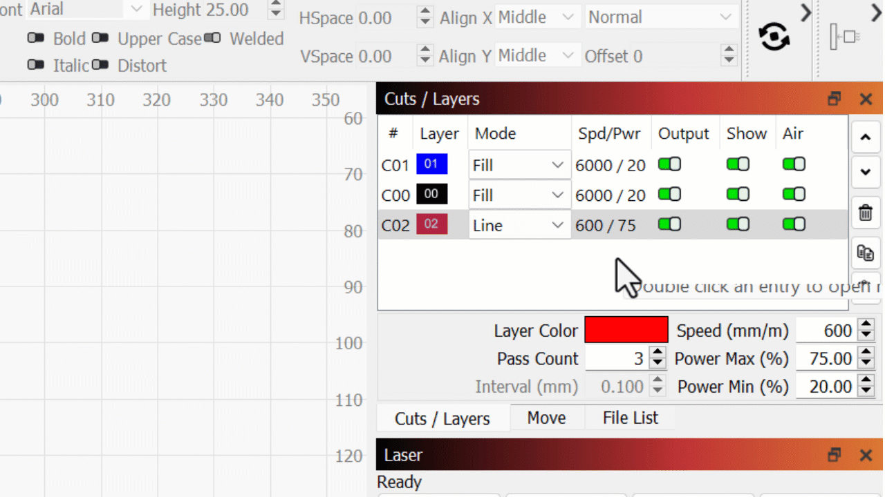

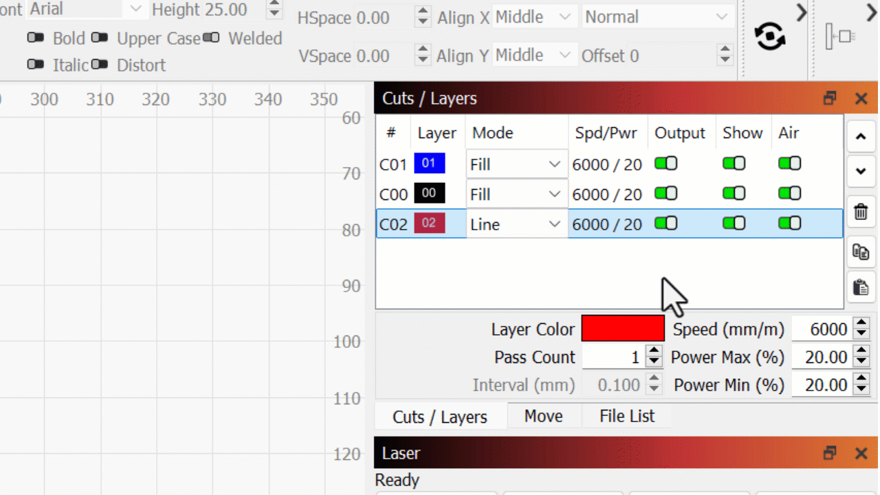

The most important settings for layers set to Line or Fill Mode are accessible directly in the Cuts / Layers Window. Click in any of the fields to adjust a given setting:
Adjusting cut settings through Cuts / Layers Window
Tip
Double-click in a field to select and overwrite current settings.
You can also double-click any layer in the Cuts / Layers Window to access the Cut Settings Editor. You'll see the same essential settings that are available in the Cuts / Layers Window in the Cut Settings Editor, along with several more advanced settings. For now you can ignore the more advanced settings — we just want you to know they're there for down the road.
Opening Cut Settings Editor

Line Mode
For Line Mode, when you're just starting out you only need to worry about a few settings: Speed, Power, and Passes. As a general guideline, relatively slow speeds and relatively high powers produce the darkest burns.
If you command the laser to move quickly, or with low Power, it will likely just etch the surface (sometimes called scoring). If you move slowly and with high power, especially with a CO2 laser, the laser will cut deeper, or even completely through the material. The only difference between surface marking and cutting with Line Mode is the Power and Speed you set.
If you have a high-powered laser, it should be able to cut through many types of materials with a single Pass, but if you have a relatively low-powered laser, you may need to set multiple Passes to achieve a clean cut. The exact number depends on your machine and material.

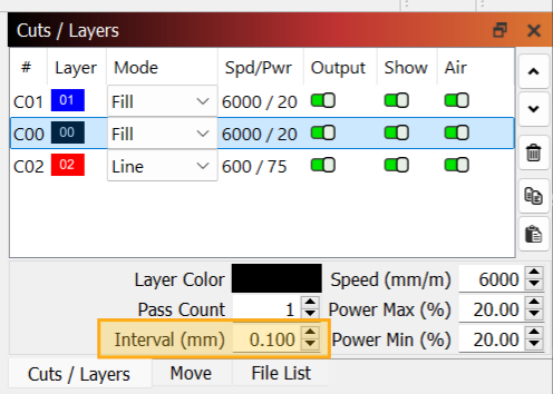

Fill Mode
For Fill Mode, the darkness and depth of an engraving is also determined by the Speed and Power settings, and follows the same principle: relatively slow speeds and high powers tend to produce the darkest, deepest etches.
But there's another crucial setting for layers set to Fill Mode — Line Interval. The Interval setting determines the distance between the parallel lines your laser scans as it engraves your graphics. Smaller Line Intervals lead to lines that are closer together. As a rule, you want the scan lines to be as close together as possible without overlapping (which can lead to overburning).
The necessary Line Interval for optimal results depends on your laser and the material you're engraving, but LightBurn's default value of .100 is a reasonable starting point for most lasers and materials.
Interval in Cuts / Layers Window
