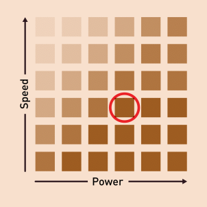

material test example
The image to the right shows a simplified example of a test grid similar to what LightBurn's Material Test Generator produces. This example helps show the relationship between speed and power:
  • In the top left corner, where the speed is high and the power output is low, the mark is faint and barely visible.
  • The marks get darker both going to the right (increasing power) and going down (decreasing speed).
  • In general, to make darker marks or deeper cuts, you can increase power, decrease speed, or do both.
You might also have noticed that the bottom right corner isn't noticeably darker than the circled mark. Beyond a certain point, increasing power or decreasing speed has limited usefulness. In this example, the circled mark would get similar results to a slower and higher power cut, but faster and with reduced power consumption.

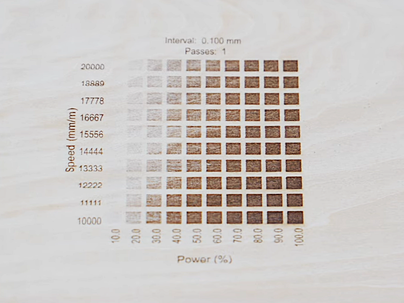

For a more realistic example, see the picture below showing an actual material test. As with the example above, the marks get darker and deeper with increasing power and decreasing speed.
material test example 2
