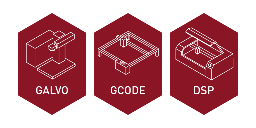

Controllers and Firmware
icons of a Galvo, DSP and GCode
The controller — and the firmware it runs — determines whether or not a machine is compatible with LightBurn, and what type of license you need.
A controller is essentially a computer within your laser, and the firmware it runs determines the type of instructions it can translate into signals it delivers to the motion system.
LightBurn needs to know what type of firmware your laser's controller is running to know what "language" to speak to the machine. In most cases, LightBurn can automatically identify the firmware if you set up your machine using Find My Laser, but you'll need to be able to identify the controller yourself in order to complete a manual setup.
LightBurn is currently compatible with three main categories of controllers: GCode, DSP, and Galvo.
  • To connect to a GCode-based laser, you'll need a LightBurn Core license.
  • To connect to a DSP or Galvo laser, you'll need a LightBurn Pro license. LightBurn Pro licenses also support GCode-based lasers.
Below is a brief description of each type, as well as a list of common controllers/firmware used by each. If you're not sure what controller or firmware your laser uses, consult your machine's manufacturer, or contact us at [email protected].
GCode
Most entry-level diode lasers use GCode-based controllers.
Supported controllers/firmware: GRBL, Smoothieware, Marlin, FluidNC, grblHAL, xTool
DSP
DSP controllers are common in more industrial-grade machines. If your machine is a CO2 laser in a metal case and has an LCD display, it is most likely a DSP model.
Supported controllers: Ruida, Trocen, TopWisdom
Galvo
Galvo lasers use a fixed scanning head mounted to an arm, and project the beam from above. If your laser uses EZCAD2 or SeaCAD as its default software, it is this type of laser.
Supported controllers: EZCAD2, EZCAD2 Lite, EZCAD3, BSL
