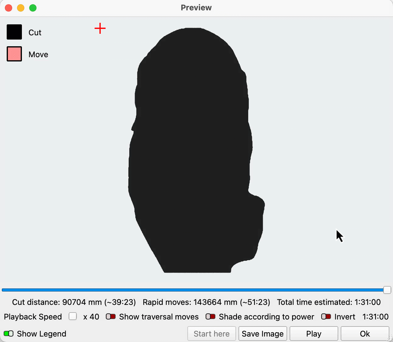

Solid Black Images
Description¶
Image engravings appear as solid black shapes, with no detail.
Solution¶
- If you are using Grayscale mode, make sure Shade according to power is enabled, or you will be unable to see any detail.
If you are using 3D Sliced mode, make sure you have set the Image layer to engrave multiple Passes, and, for best results, that you've set an Angle Increment.
When set up properly, with Show traversal moves enabled you should see the red areas of the Preview expand with each pass, as the laser travels over rather than engraving progressively larger (and lighter) areas of the image.
