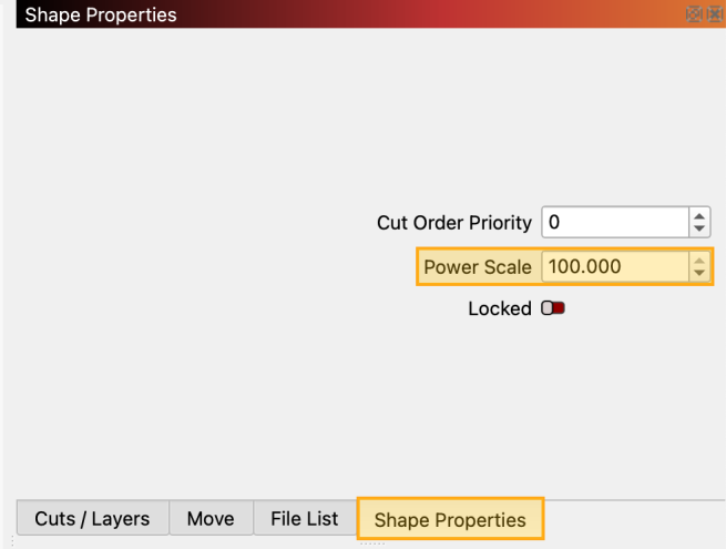

Description¶
Graphics are rendered in a shade of gray rather than black.
Solution¶
When Shade according to power is toggled on in the Preview window, graphics with Power Scale values set below 100 are rendered in shades of gray. The lower the Power Scale, the lighter the shade of gray.
Power Scale reduces power output as a percentage between Min Power and Max Power. For devices that do not support the Min Power setting, power is scaled as a percentage between 0 and Max Power.
Increase Power Scale to 100 if you did not intend to reduce power output for the shapes depicted in gray.
