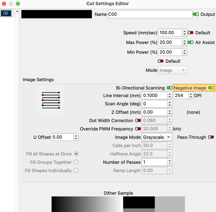

To invert an image engraving, toggle on the Negative Image switch in the Cut Settings Editor or Adjust Image window.
The Negative Image option is useful when you're engraving on slate or another material whose original surface is darker than the mark your laser will make on it.
If you are working with a light material, you should not enable this switch.

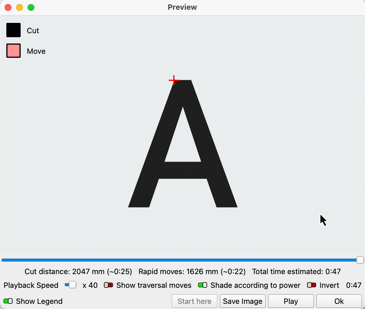

If the Invert switch is toggled on in the Preview window, engraved areas will show in white, and unengraved areas in black. This is intended to represent how your artwork will look when it's engraved on slate, granite, or another dark material upon which the laser's mark will be lighter than the original surface finish.
This switch only affects the representaton in the Preview window and makes no difference to how your laser will actually engrave your graphics.
