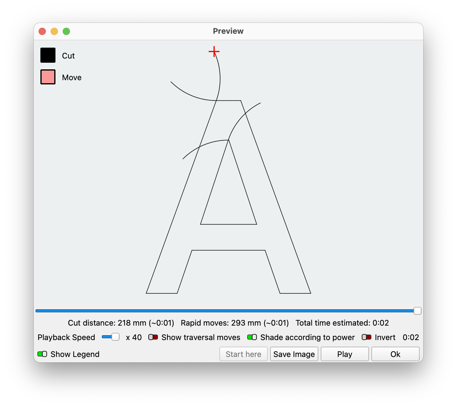

Unwanted Lead In / Lead Out lines in the Preview window
Description
Extra lines appear at the starts and/or ends of closed cutting paths.

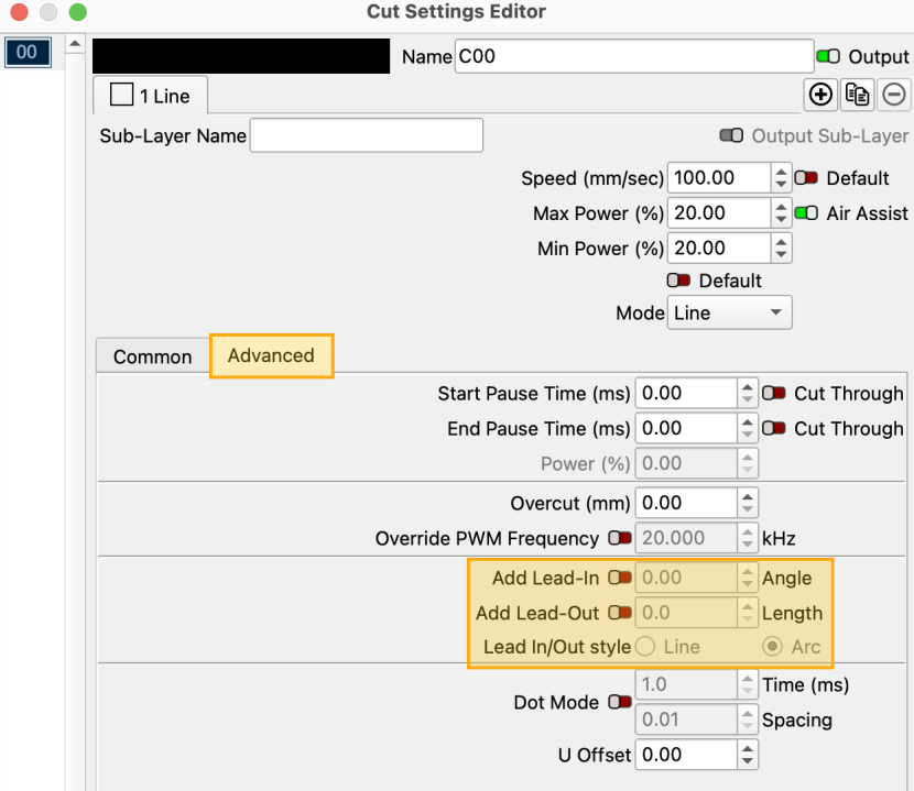

Solution
These lines are due to enabling Lead-In or Lead-Out in the Advanced tab of the Cut Settings Editor.
Lead-In / Lead-Out lines are intended to compensate for excessive burning at the starts or ends of cuts by extending the cut line, so the mark is left off of the cut part.
If you did not intend to enable this setting, open the Cut Settings Editor, switch to the Advanced tab, and toggle off Add Lead-In and/or Add Lead-Out.
Lead-In and Lead-Out disabled in the Cut Settings Editor
