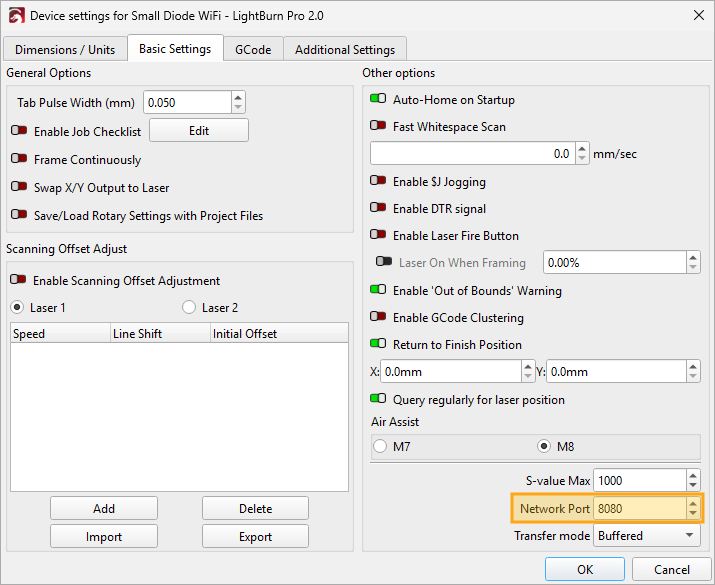

Network Connection Port
If you're connecting to the laser over a network instead of with a USB cable, you may need to change the network port setting in Device Settings.
The Network Port setting is in the bottom right of the Basic Settings tab of the Device Settings window. The default setting is 23, but some devices use a different port. Try setting the port to 8080, and if it still doesn't work, check your laser's user manual for more information.
