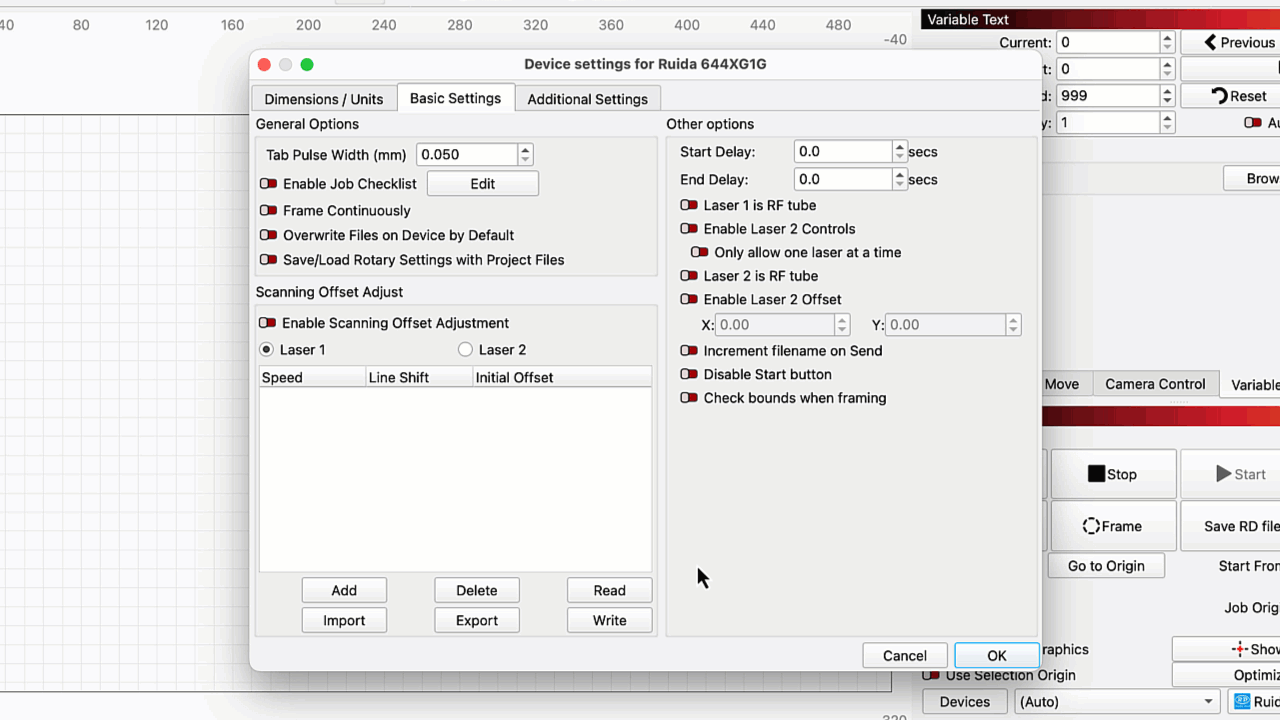

The Basic Settings tab of Device Settings contains the most commonly used settings, and is available regardless of device type.
The image below shows the Device Settings window for a DSP device — several alternate options will be presented if you are using a different type of device.
Click any option in the images below to jump directly to the relevant section for that option, or scroll down for a full list of options and descriptions, for both DSP and GCode-based lasers.
The Basic Settings tab of Device Settings on a DSP laser
The Basic Settings tab of Device Settings on a GCode laser
General Options
Tab Pulse Width
When using Tabs, the Tab Pulse Width allows for additional control of the Tab Cut Power setting. Change this length to increase or decrease the width of the pulses used to simulate reduced power cuts.
Enable Job Checklist
When this setting is enabled, LightBurn will display a text box with a list of items whenever you Start or Send a job to your laser. This is typically used as a reminder of things that need to be done before starting the laser, such as turning on an exhaust fan or putting on protective glasses.
To create a custom checklist, click the Edit button.
Frame Continuously
This setting alters the behavior of the Frame button. When enabled, LightBurn will frame your project repeatedly until stopped, instead of a single time.
Continuous Framing is often useful for adjusting material placement within the laser.
Overwrite Files on Device by Default
When enabled, LightBurn will automatically overwrite pre-existing files of the same name when sending a project to your laser's controller. Keep this setting disabled to receive a warning message whenever LightBurn will need to overwrite a file in order to send a new one.
Save/Load Rotary Settings with Project Files
When enabled, LightBurn will include rotary settings when saving a project, and will load those settings when re-opening the file. This can streamline job setup when working with rotaries.
Scanning Offset Adjust
This setting is used to compensate for minor delays in your power supply causing the laser's firing point to be a little behind where it should be when scanning back and forth at high speeds. For more information, see Scanning Offset Adjustment. For an example of what Scanning Offset problems might look like, see Troubleshooting: Blurry Edges.
Use the Enable Scanning Offset Adjustment switch to toggle between enabling or disabling your saved offset values. If your machine has multiple laser sources, click the buttons next to Laser 1 and Laser 2 to switch between viewing and applying settings for each source.
The Add, Delete, Import, and Export buttons allow you to create, edit, load, and save your Scanning Offset settings. You can use this to Import settings provided by your machine's manufacturer, share adjustments with other users, or back up your settings before making changes.
Read and Write Buttons
Some Ruida controllers allow the ability to directly Read Scanning Offset Adjustments stored in the controller's settings, or Write new settings from LightBurn.
These buttons only appear when LightBurn is directly connected to a Ruida controller that supports the Read/Write functions.
Reading Scanning Offset Adjustments from a Rudida controllers

DSP Devices
These settings are only available for DSP lasers.
Start and End Delay
Start Delay allows you to set a delay before the job starts cutting, and End Delay allows you to delay the end of the job after the cut is complete. This is typically used to allow the exhaust fan to start up and spin down.
This feature is only available on Ruida controllers, and only works if the controller's wiring is compatible. Your success in enabling it will be dependent on your specific hardware.
Laser Is RF Tube
Enable this switch if your laser has an RF tube.
If your laser has a single tube, only the adjust the Laser 1 is RF Tube switch. If your laser has two tubes, you can enable this switch for either Laser 1 or Laser 2 individually, as appropriate.
This will disable an automatic warning message, intended for CO2 lasers, which is sent when you start a job which uses an RF tube and includes a layer whose Min Power is set to zero.
Enable Laser 2 Controls
This setting enables controls for a second laser tube within the same machine. Enable this setting only if your machine has two laser tubes.
Only Allow One Laser at a Time
Enable this switch to automatically disable the alternate tube when you enable Laser 1 or Laser 2.
In other words, when you enable Laser 1, LightBurn will automatically disable Laser 2, and vice versa.
Enable Laser 2 Offset
If you are using a dual head laser, use this setting to specify the position of the second laser head relative to the main one.
See Dual Laser Control for more information on dual laser setup.
Increment Filename on Send
This option will automatically increment file names when sending jobs to your laser, to make identifying separate runs easier and maintain your file history. Your file name must contain a digit in order to auto-increment.
Disable Start Button
Use this setting to disable the Start button.
On some lasers, streaming a job with the Start button can be unreliable, so this feature allows you to ensure that all jobs are sent to the laser using the Send button, which transfers the entire job to the laser before it can be started.
Check Bounds When Framing
Enable this setting to have LightBurn check that a job won't travel out of bounds when Framing.
Network Timeout
This setting determines how long LightBurn will attempt to communicate with a networked device before reporting a communication failure. Increasing the value from the default of 5000 ms (5 seconds) can help with slower connections.
IP Address/Hostname
The IP address or hostname to use when connecting to a networked device. This value is set when adding a device, and can be viewed or edited here.
