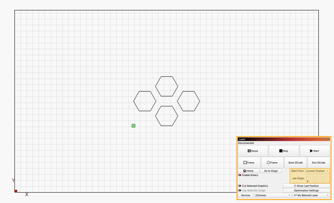

Current Position
With Current Position selected, your job outputs relative to wherever the laser head is located when you press the Start button. The Job Origin control in the Laser Window tells LightBurn how to orient output relative to the laser head.
In this image, we're starting from the Current Position, with the Job Origin set to the lower left:
Current Position Bottom Left Job Origin
Notice that the green Job Origin indicator has moved. This represents the position of the laser when you start the job, so the laser is going to move slightly up and to the right from wherever it is, cut the four hexagons, and go back to where it started.
Why is the Job Origin offset from the graphics?
When using Current Position or User Origin, the green Job Origin indicator is always located on a corner, side, or at the center of an imaginary box — the smallest possible rectangle that can fully contain all graphics you're sending to the laser.
Below, we've added a Tool Layer to represent that imaginary box. Notice how the Job Origin moves around the box as we change the location in the 9-Dot selector.
Changing Job Origin

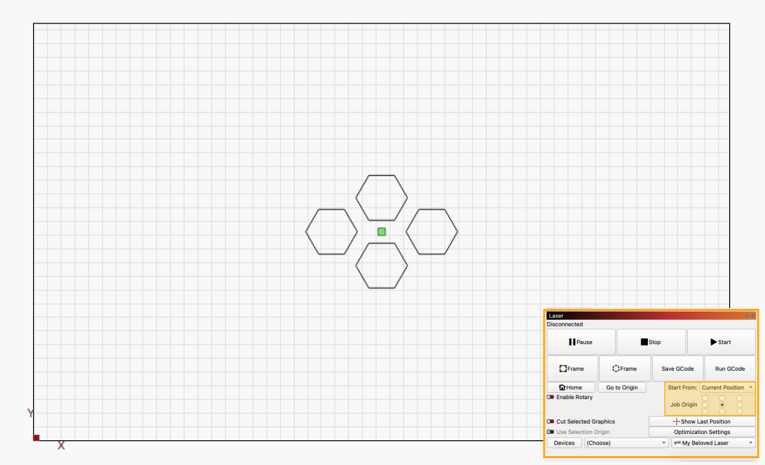

Now imagine that you want to etch this four hexagon pattern onto a coaster or a phone case. Lining it up from the lower left is not easy. If you change the Job Origin setting to center, you get this instead:
Current Position Center Job Origin
The job will be centered around the current position of the laser head. If you position the laser head directly over the center of the item you want to etch, the output will be centered on the item.
