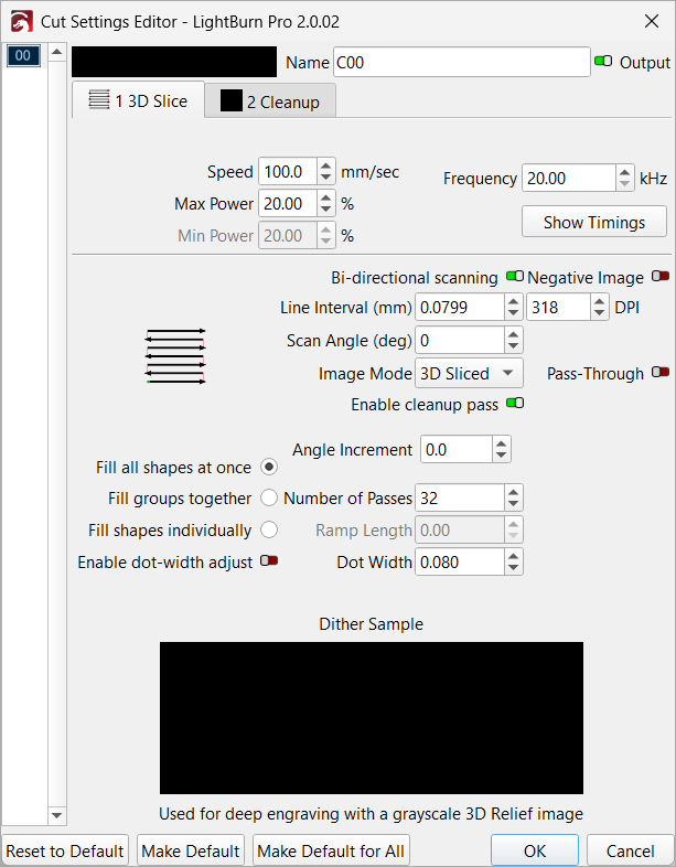

Enable 3D Sliced Mode
Use the Cut Settings Editor to set the Image Mode to 3D Sliced. This mode is only available when using a Galvo laser.
Adjust Settings
Most settings are shared with the other Image Modes, but there are a few details specific to this mode.
Number of Passes
In 3D Sliced mode, raising the Number of Passes splits the depth map into more layers, increasing the effective resolution of the engraving. The darkest shades in your depth map will be engraved with the full Number of Passes, and all lighter shades will be engraved with progressively fewer passes, down to zero passes for pure white shades.
Using a large Number of Passes may require decreasing power to avoid burning deeper than intended. This has a similar effect to decreasing layer height on a 3D printer.
Note
Larger, more intricate designs may take more time to process, due to the complexity of generating each pass. If you see this dialog, please be patient as your computer may need some time to prepare your design.
Cleanup Passes
Toggling on Enable cleanup pass will automatically add a Cleanup Sub-Layer in the Cut Settings Editor, where you can specify how often automatic cleanup passes should run, and adjust the settings for those passes.
Cleanup passes are typically run with a tighter Line Interval, higher Frequency, and lower Max Power than the main engraving passes, and are used to clear debris and produce a better finish.
Angle Increment
Process Change: Angle Increment
This setting is new in LightBurn 2.0. Previous LightBurn versions used crosshatching by default for 3D slicing. Now that users can set angle increment themselves, crosshatching is no longer automatic.
To reproduce the crosshatching effect from previous LightBurn releases, set the Angle Increment to 90°.
The Angle Increment setting will determine how much the Scan Angle rotates between passes.
With the default setting of 0, all passes will be engraved in the same direction. Setting a non-zero number will tell LightBurn to rotate between passes. As an example, if the Scan Angle is set to 0 and the Angle Increment is set to 30°, subsequent passes will be at 0°, 30°, 60°, 90°, and so on.
