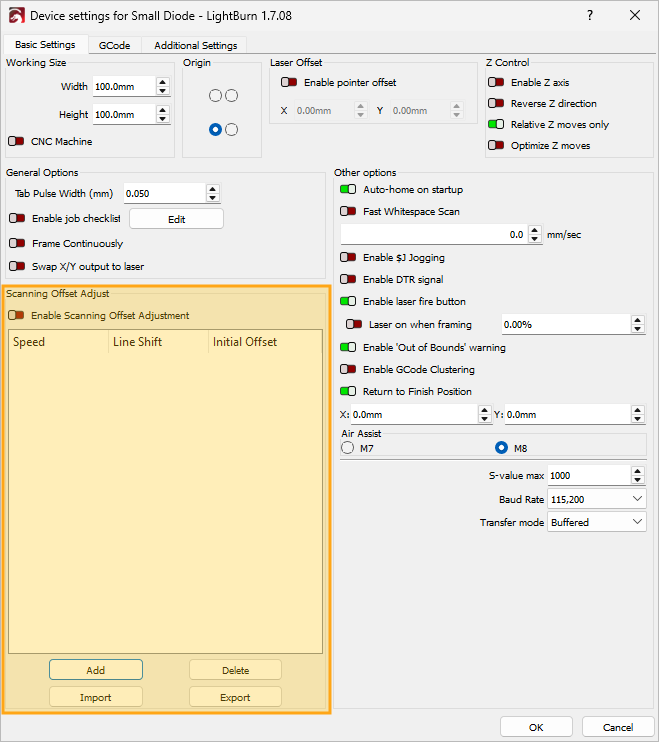

LightBurn has a setting to counter this, called Scanning Offset Adjustment, in the Basic Settings tab of Device Settings.

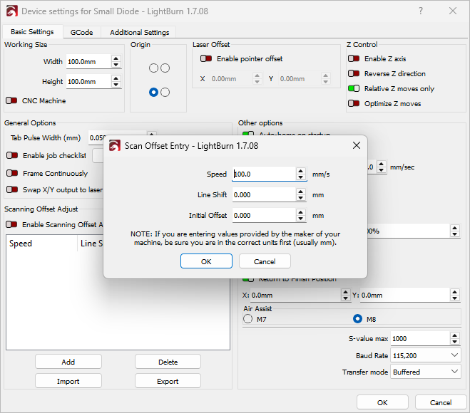

In the Scanning Offset Adjust section of the Device Settings window, click Add to enter the Speed and Line Shift (distance between ends of lines) values into the Scanning Ofset Adjustment table. LightBurn will use this information to compute the correct adjustments for other speeds as well.
Note
You will need to enter half the measured distance between lines — LightBurn moves each line by the amount you specify, so each pair of lines only needs to move half the distance.
Make sure to toggle Enable Scanning Offset Adjustment on, and click OK to exit the Device Settings window and save your changes.
